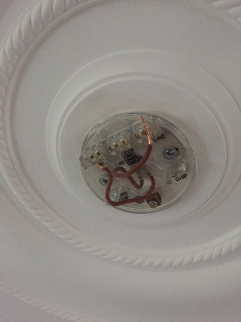

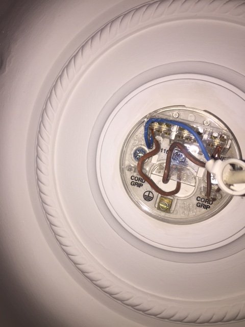

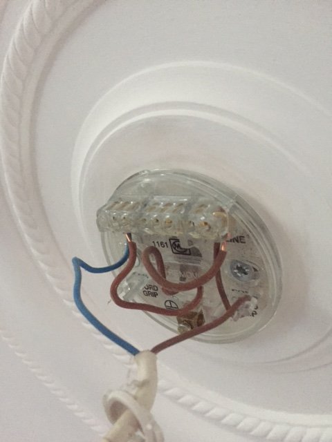

Here are pics of the fitting and the light I want to wire in
Thanks!

Remove that ceiling rose, pull those cables down and see what else is there. Could be that they just didn't bother bring the earth through into the rose as it's not needed
You need to remove the ceiling rose, and see if there is another connector up in the ceiling.
As the wires coming down are both brown, its a geed bet that the wiring is relatively recent and that there will be an earth connection up there.
If you cannot see from below, then you may need to get access from above.
Yes please do let us know, and post photos of what you find! You may find that some plank has fitted the plaster rose right over the old pendant base and the base and the wiring are now trapped between the ceiling and the plaster rose.
Yea Freddo just as you had predicted!! Can't see past the ceiling rose....how much you reckon it would cost to have an electrician either source the earth cable, or if one doesn't exist to re-wire one in? Seems like it's got to that stage. Thanks!!
There will likely be an earth cable with the wiring.
Can you get above the ceiling? The connections might be acessible there.
If you can't get above the ceiling you may need to smash through the plaster rose...
