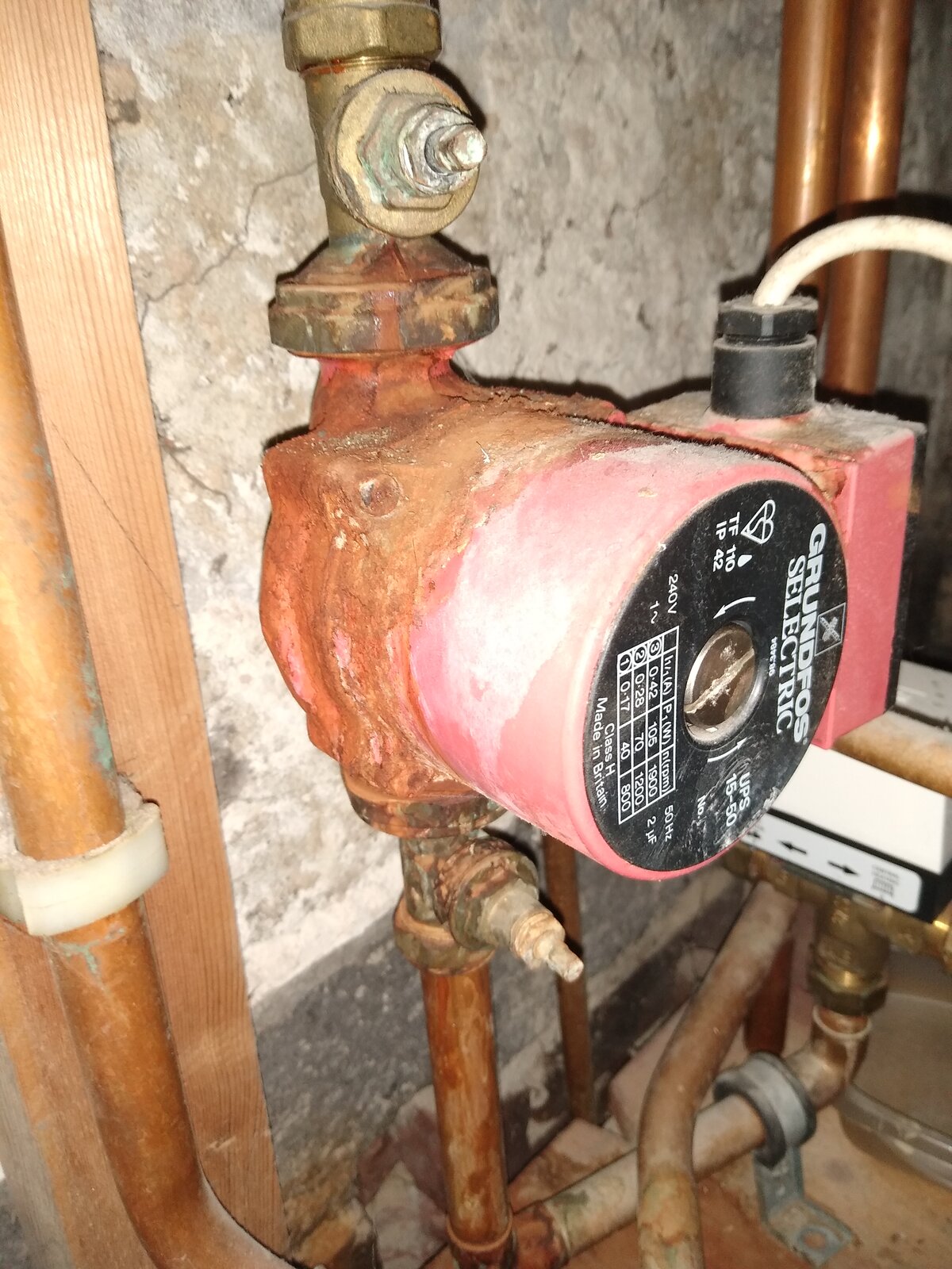

Radiators not getting hot, hot water still ok.
Y plan, f&e tank etc
3 bed semi, 7 rads.
The 3 way valve was completely changed in 2016, I think it's also had a new head on it since then. (If not I've got a spare knocking about)
So it might be the valve, but having had a look at the pump, I think I'll replace that first, it looks like it's been leaking for a while.
It's at least 15 years old, possibly more. Definitely in need of a replacement judging by the state of it.
Grundfos Selectric UPS 15/50.

The other 'dumb' question I should have asked.
Does the fact that hot water is getting from the boiler into the hot water tank mean that the pump definitely hasn't failed? Or can the hot water easily siphon up past a pump that isn't circulating and keep the tank hot.
With a failed pump, there would be lots of short cycling of the boiler, because it would be unable to get rid of it's heat fast enough.
Ok, having stuck my head in the cupboard and had a fiddle, the pump is still circulating and the spindle turns freely. So it's the valve (again)
But given the state of it, I will be looking to replace it in the near future, so the above questions still stand.
Also, Is it worth picking up a NOS or refurbished like-for-like pump, or get one of the newer ones with bells and whistles? (I favour reliability over efficiency)
My Ufh has a separate pump but needs both running wether its on together with the rads or stand alone.
