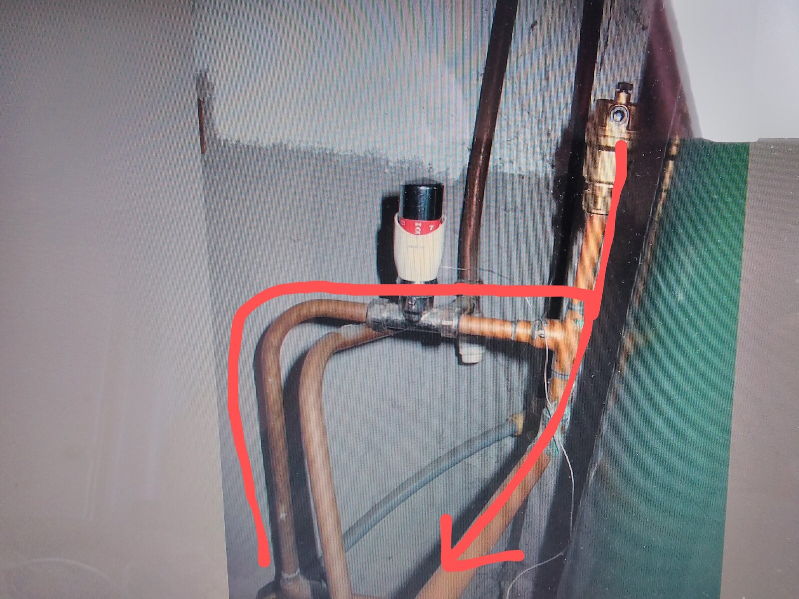

T'other's a Drayton Tapstat valve.

You should be able to undo the knurled collar:
Now I'm guessing, here, because I never took exactly one of those apart, that like the rad valves there's a pin in there which is supposed to stay out about 5mm until pressed by the "head". If it's stuck down (likely, the rad valve equivalents do it a lot) then use a toffee hammer to bash the valve, tap the end of the pin etc etc it could unstick itself, etc. Don't pull the pin because it'll pee water out.
The Tapstat presumably can fail either way. If the mechanics in the part which is like a radiator valve sticks, pin stuck in, the valve will be shut. If the expanding liquid sensor part fails, the valve will stay open because the expanding liquid leaked away and never presses the pin inside..
Google "stuck thermostatic valve", to see pins aplenty.

That's a Drayton Tapstat valve. They can fail either way. If the mechanics in the part which is like a radiator valve sticks, the valve will be open. If the expanding liquid sensor part fails, the valve will stayclosed.

If you're averagely lucky, tapping the pin a few times will release it. If you start undoing things, you'll get wet, but you may have to.
There used to be similar valves to yours at sensible prices, but they seem to be unusual now.
The upper pipe is getting hot all the way to where it enters the cylinder,well past the Tapstat which has had the head removed completely,the pin is extended about 5mm, the pipe enters on the opposite side of the cylinder which would suggest it's clear up to that point.
I think I will have to undo the lower pipe without flooding the house somehow!

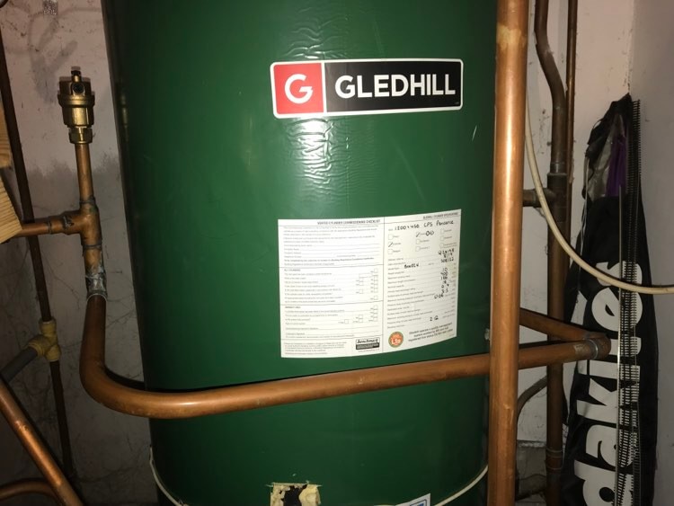

This is where it gets hot

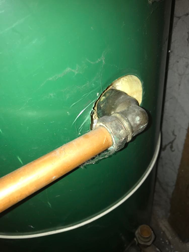

This whole pipe gets hot
Is the horizontal pipe in the left photo the coil flow and if so, is this hot?.
Is the pipe in the right photo, the coil return and is this cold?.
