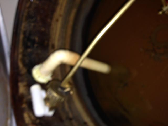

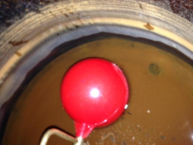

The water in the F&E tank on top of the thermal store is red hot, this is causing condensation to drip down the overflow pipe.
I think something has gone wrong? Is a valve playing up somewhere?
Pics of the inside of th F&E tank showing the level below the overflow pipe but it is still dripping outside and the water in there is red hot and I can see some circulation when the heating is on.
Also the cold feed pip into the thermal store and the F&E tank is red hot! Could it be the three way blender has failed, the one in the middle of the picture here with the black knob on it:

You still have it wrong, after 4 weeks you need to add X100 not more X400
