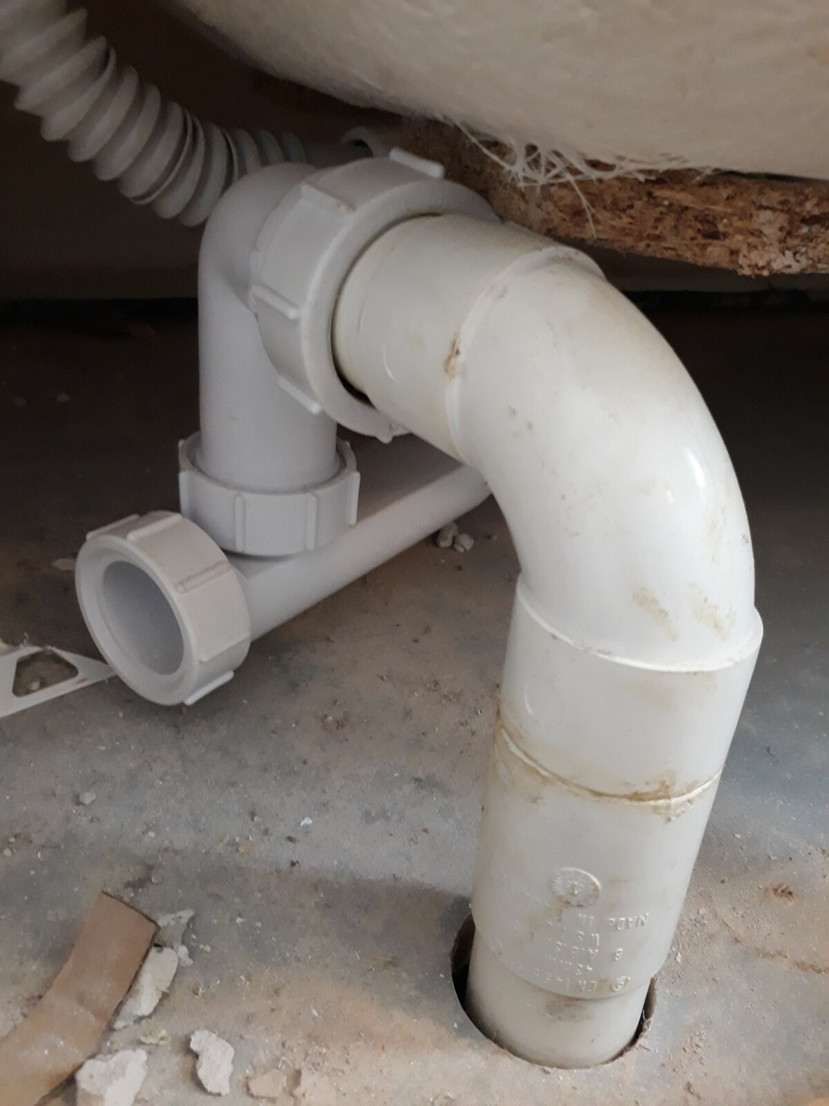

I am replacing my bath however the new one sits lower so I need to reroute some pipework.
I was hoping to just cut the fitting off and reweld some new on however there doesn't look like I will have enough pipe left.
Is there such thing as an internal coupler?
There would be 20mm left coming out the floor if I cut that 1st coupler off but trying to avoid messing with the floor.
Anyone have any ideas how to can sort it? I maybe can't see the wood for the trees.
Picture attached.

Thanks. Looks like I'm getting the multitool out and digging some floor away!
Best option, however, use a little bit of wire to check where the pipe goes so you can start chipping way on the opposite side, avoiding any disaster.
After opening a little more, you'll be able to put some metal sheet to protect the pipe if it is superficial.
Any kind of internal coupler would reduce the internal diameter of the pipe & provide a 'ledge' on which crud and other debris are going to collect ready to start a blockage.....
Use the multitool to cut vertical strips through the existing coupling, but not the pipe inside. Do about 4 or 5 and then, if you're lucky, you can prise the strips off with a sharp chisel or screwdriver. Get between the two surfaces, where the solvent line is and go gently. Once you've got the strips off, you can then peel away the rest of the fitting all the way round... Cut the coupling in half first and wedge something down the hole to hold the pipe steady and prevent it from dropping down.

Before doing anything remove trap and get a sense of how much play (upwards) there is in the pipe and how inclined it is to dissappear downwards
(as @ just pumps says above)
Looking at the image the pipe coming out of the floor seems to run into a straight connector and then the pipe above that runs directly into an elbow.
If the OP were to cut the pipe just below the elbow, and then carefully cut grooves in the coupling (along its length), wouldn't he be able to use a screwdriver/etc to pry/snap the straight connector apart. I assume (possibly incorrectly) that he would be able to remove any traces of glue with acetone.
