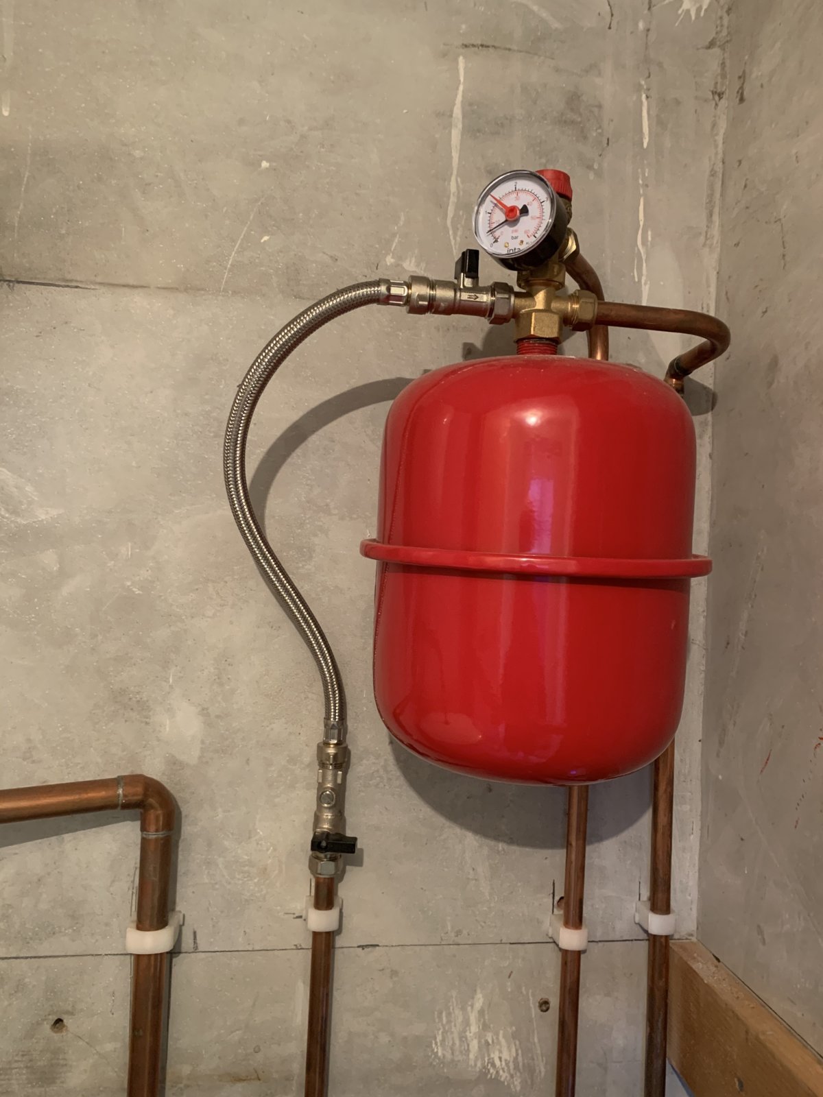

Hello folks,

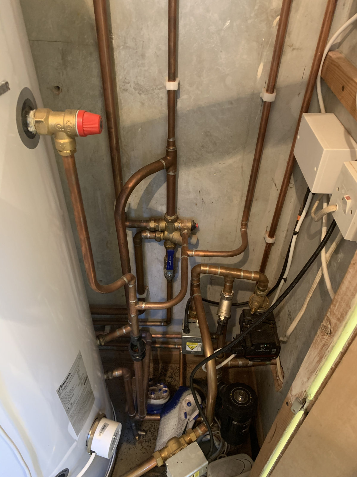

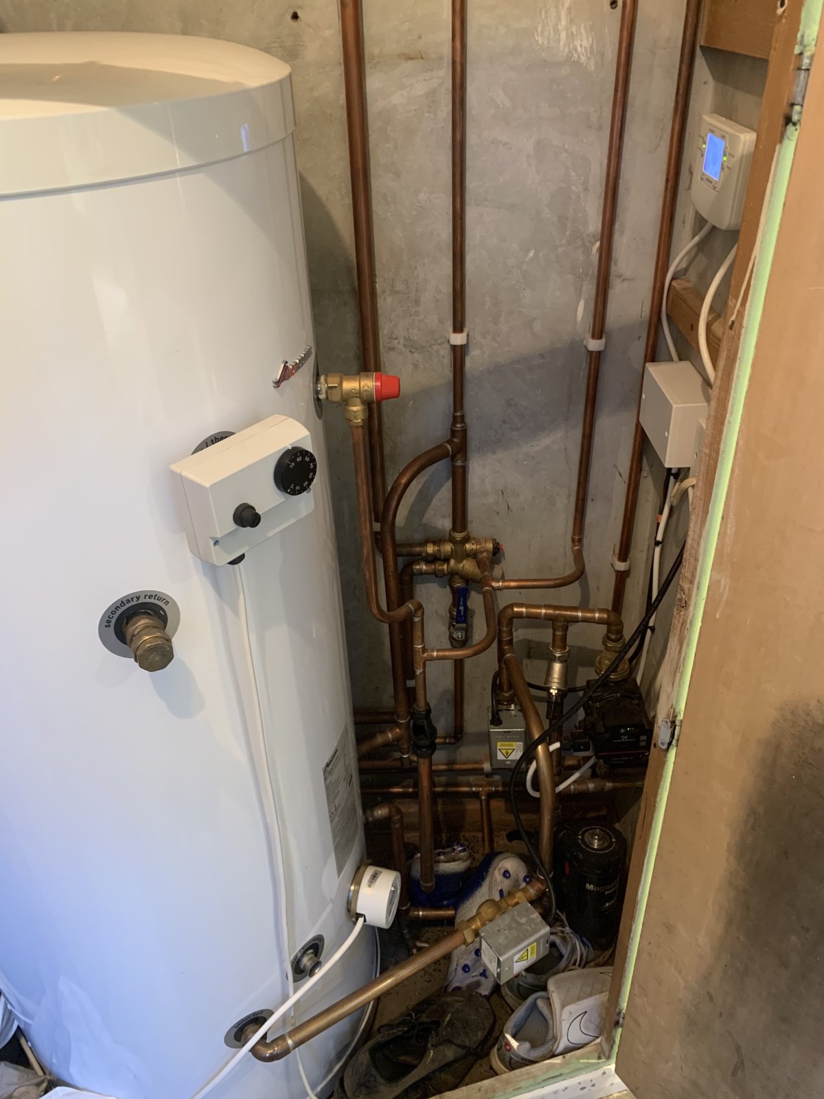

I've recently had my boiler and water tank replaced. I've now got a Worcester Greenlink Ri boiler and a pressurised hot water tank. My radiators were gurgling and clicking when the heating kicked in so I decided to bleed them all. One of my radiators had no water or no air in it which was odd. I looked at the heating system and there's what I assume is an expansion tank with a pressure gauge on it that is currently reading zero with a tell-tale needle showing 1.5bar. As far as I can see there's no pressure gauge on the boiler. I'm guessing that the system needs refilling and pressure building but I'm clueless about this - I can see that there's two valves in the closed position leading to the expansion tank. I've taken pics, any help would be great.

Ignore me - I'm aware I'm talking to myself now - I turned the valves and the pressure is back to 1.5 bar.
One question, what causes the pressure to drop as it's a closed system?
Turn any one of those black levers at the end of the flexi hose open, then slowly open the other one until the pressure rises to where you want. Then turn them both off.
bleeding your radiators will cause the pressure to drop.
Get the installer back in to do teh job correctly and to show you.
