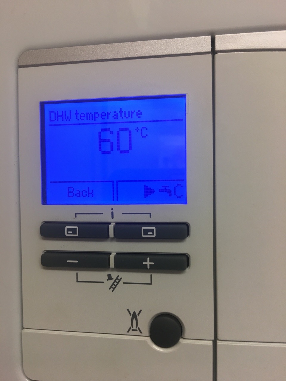

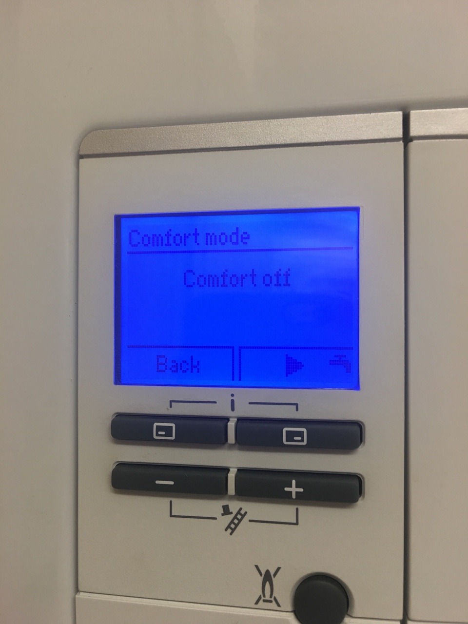

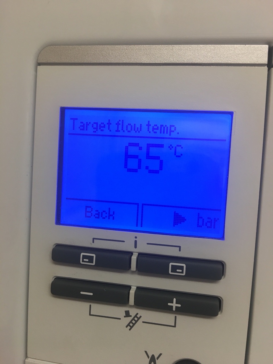

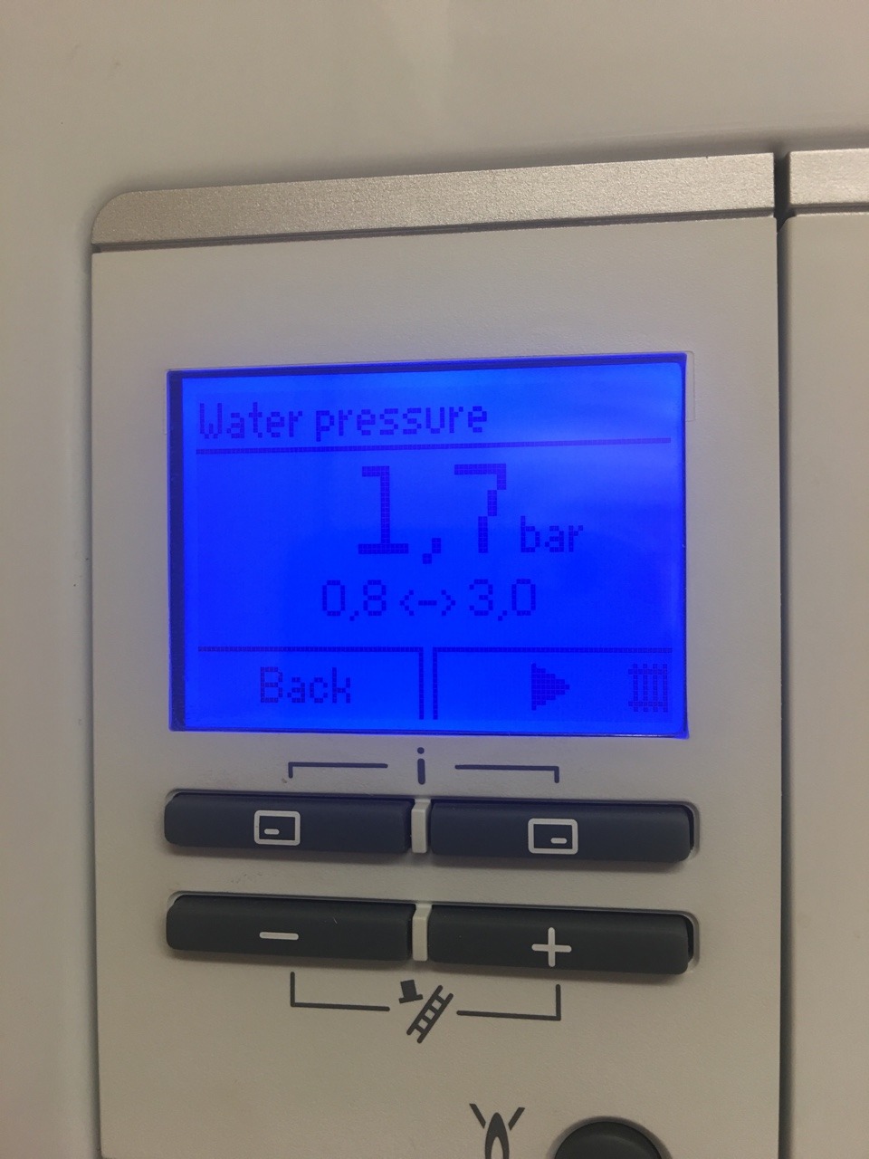

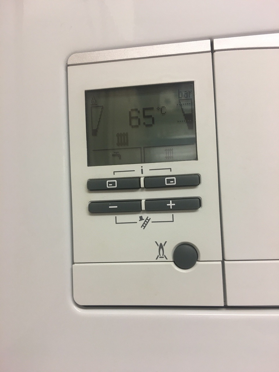

In June, the boiler showed an F20 safety switch off temperature limiter, sign.

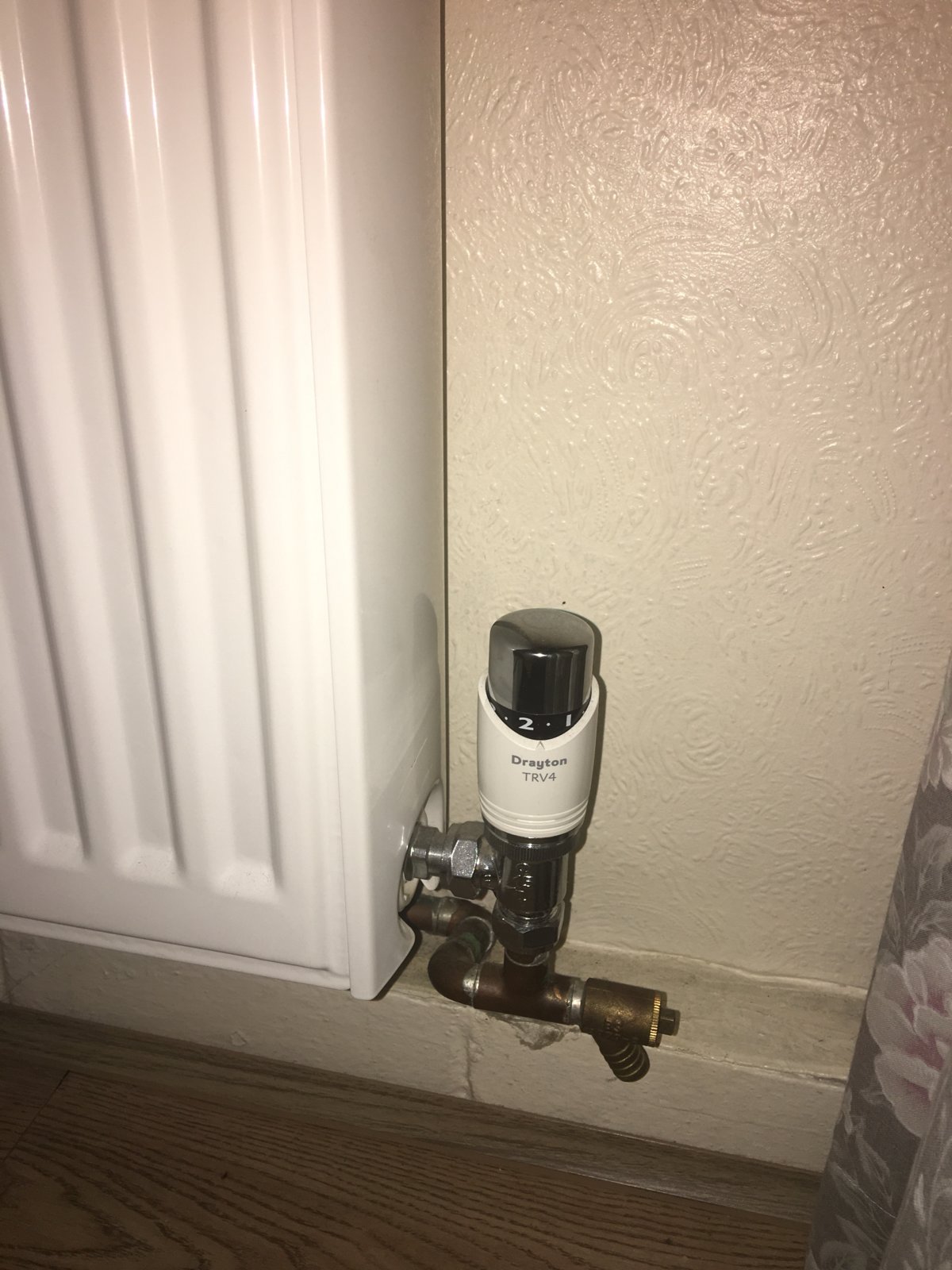

We had the Vaillant engineer come out, who told us that the water pressure was the problem.We were also told the TRV4 on our radiators are not suitable for our boiler. Something about a bypass. The heat needs to go somewhere as there's too much of it hence the sound. He advised us to not use one of our radiators which we stopped using. Now we have the same problem again, where the radiator makes the high pitched squealing.

Do you have TRV's on all the rads, and is there a roomstat somewhere.

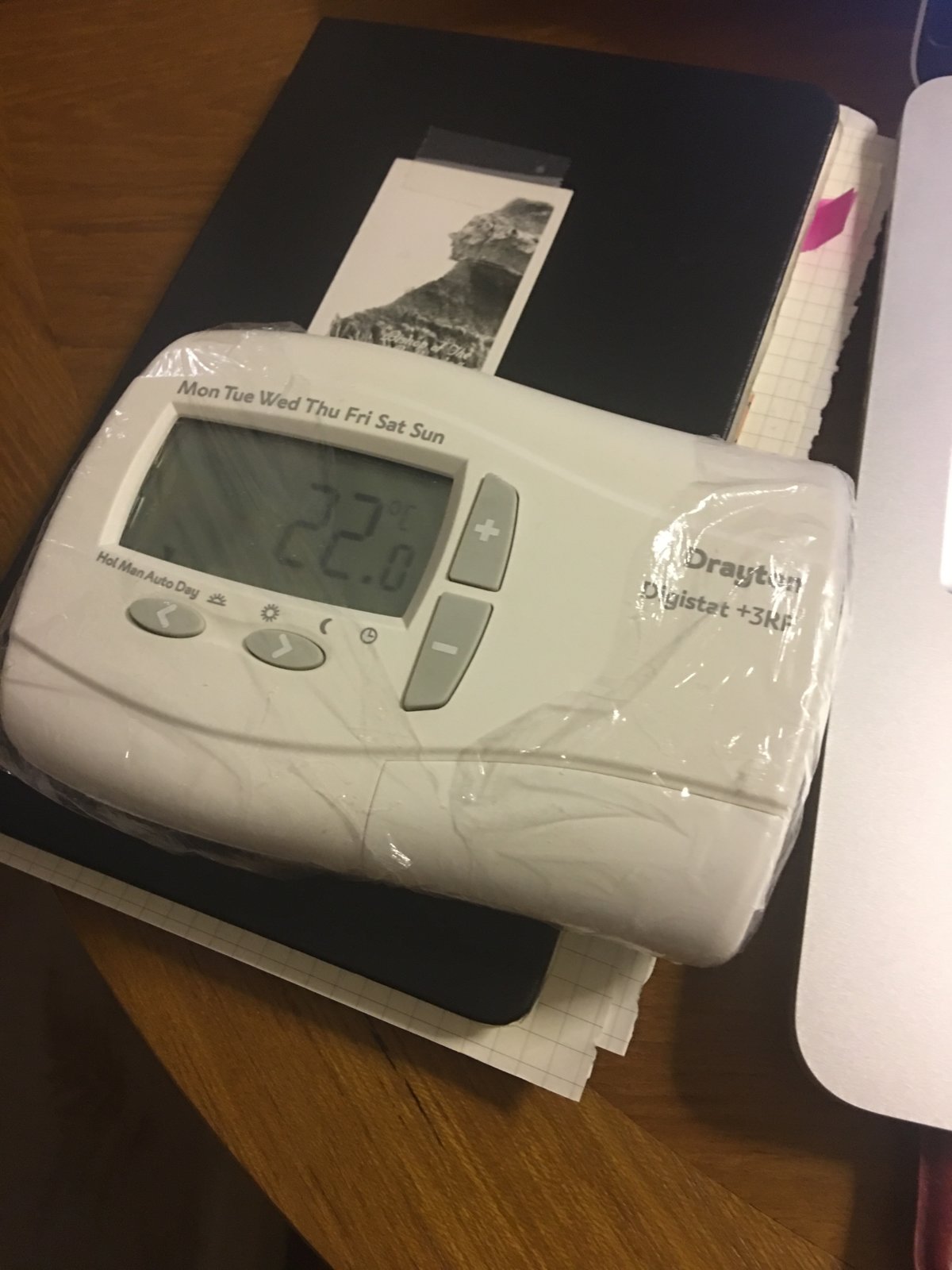

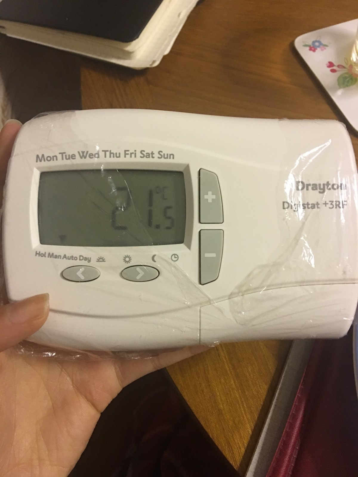

Yes, all our radiators have the TRV4s. A roomstat? is that the little handheld device to change the temperatures? We have a Drayton Digistat +3RF. Sorry, I am not very technical, it took me 30 mins to realise how to post on here.
You shouldn't have a TRV on the room with the stat, so take the head off the rad in that room, which is what I suspect he really meant. The TRVs will shut the rads down when they are all up to temperature, and that stops the water going anywhere, hence the noise. If the room with the stat has no TRV on it, then the water can keep flowing until the stat switched the boiler off. I suspect you need to balance the rads so they all come up to temperature at the same time, and if you still get the problem, then you'd fit a bypass valve across the flow and return pipes near the boiler.

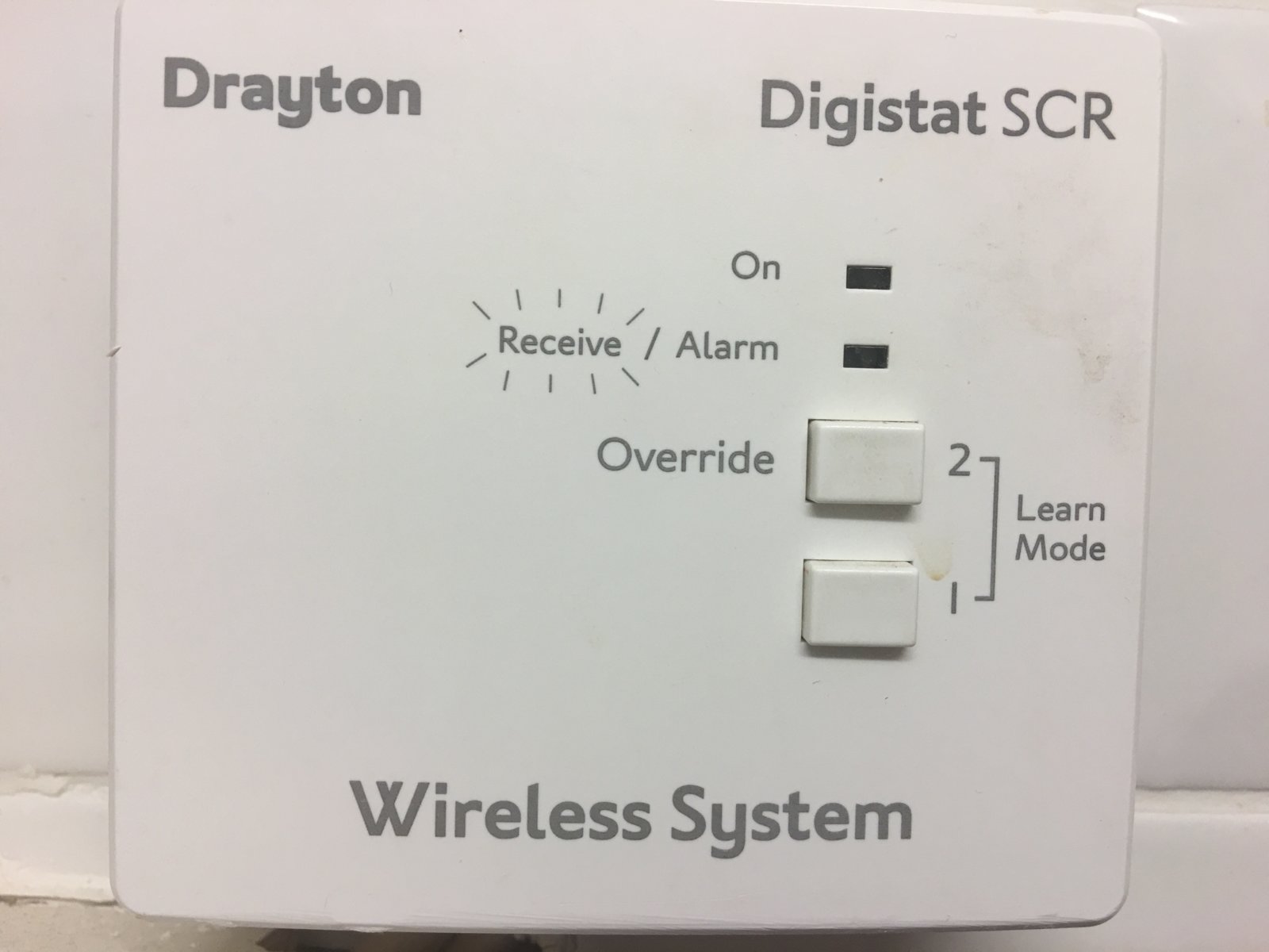

We have the wireless system in the kitchen where there are no radiators. Is that the stat you were talking about?
The other one can be taken to any room in the house. We do have a radiator in the breakfast room which is connected to the kitchen.

The box in the kitchen by the boiler, is the receiver, but the room stat should be in the living room, and that rad shouldn't have a TRV on it. By moving it around, you cause a problem because the boiler will keep pumping the water round, and there's no rad to act as a bypass valve.

So this is the room stat which we should leave in the living room? iOS Image - 3664730038.jpg

Its nothing to do with the stat, you need to remove one of the trv heads to allow water to flow round at least one of the rads.

Okay, so you use the stat to turn the system on and off, but it's also measuring the temperature of the room, and it will tell the boiler to stop heating the water in the pipes when the room is warm enough; in your case, that's not happening, and the boilers still running, and because the TRVs have turned every rad off, the water can't go anywhere, so is making a noise.
Did you take the TRV head off of the rad in the room with the stat. Use something to push down the little pin where the TRV head was, and make sure it's not stuck. You can put the TRV head back on the one that fell off; just put it back on, and then turn the ring underneath till it grips and tightens. If the TRV is off in the living room where the stat is, then things should work okay, but if they don't then there's another issue somewhere.

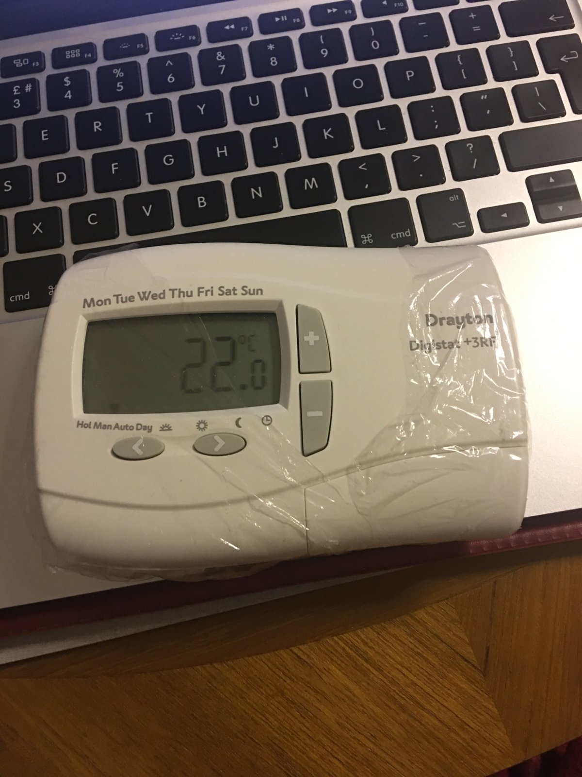

The Room Stat should be in one room and that same room should not have a TRV. You need it this way so that the room stat can sense the rise in temperature and turn the boiler off. If you put the room stat in a room with a TRV the TRV will turn that radiator off and the room stat will still be telling the boiler to keep going. (The room that the TRV has fallen off is easy to fix. They just have a screw collar to attach to the valve)

I see. I’ll leave this stat in the living room from now on iOS Image - 1492940690.jpg

Can we leave the room stat in the hallway then? Or would you advise it to be in the living room.
