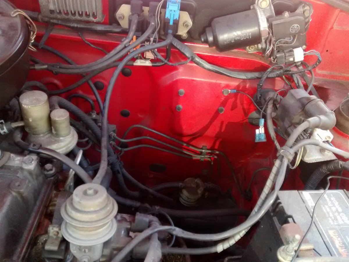

So here's a pic. The component centre right is the ignition module?
The cylinder marked D041 is the coil? Current thinking is that one of these bit's are faulty? How best to locate the culprit?
(Note: The blue fuse, and wire is for a dash LED, (fake alarm) which I have temporarily disconnected)

Fuel in tank, about a third. Defo can smell juice when attempting to start. Replacing the coil is an option, but I don't want to spend money on it, and then wait 3 days for it to arrive, only to find out that it's something else. The 2 bits in the picture top right, for example. (Cylinder thing and control board thing)

I'm a bit concerned about suggesting the coil - although that indeed is a high chance - just in case it's the immobiliser or whatever having a bad day,
However, unplug the thin wires going into the coil, and see if you can get a resistance reading between the terminals, as a base check.
John :)
Or take the big lead off the coil and check like you did the plug leads. You might have issues in the distributor cap, where the one spark goes to each individual plug lead? If you find you have a spark out of the coil, take the distributor cap off, check the inside for cracking, where the spark can jump to the wrong cylinder and the rotor/ middle carbon contact for signs of failure?
Ive no idea how these are wired but if its a 2 wire coil i would expect one of them to have an ignition fed 12 volt supply and the other to be triggered by the ecu?
Dont even know if they used a crank sensor on these but basic wiring checks are the first place to start.

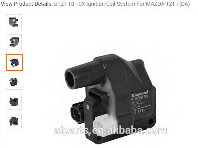

Black plug has (from left to right) black&white striped wire, and a Green&Yellow striped wire. This wire goes into the loom.
White plug has a black&white striped wire, and a solid blue wire. This wire goes into the back of the dizzy (Crank sensor?)
What do I stick where, and what setting to set the multimeter at? Can I test this off the car, or does it need to be bolted in for grounding purposes? (No clue!)
The Coil is the same as this:

Ok, to conclude.
Got an electronics whiz pal to take a look. He discounted the coil, so took a punt on it being the ignition control module that was hidden behind the plastic cover on the dizzy. These are supposed to be greased with heatsink paste, mine wasn't, so might have burned out because of that.
http://www.aahmotorsport.com/ekmps/...ier-j007t01571-72-75-md618293-j170-1443-p.jpg
New one fitted, with computer CPU paste on the back, she fired up first time. Another life lesson learned.
