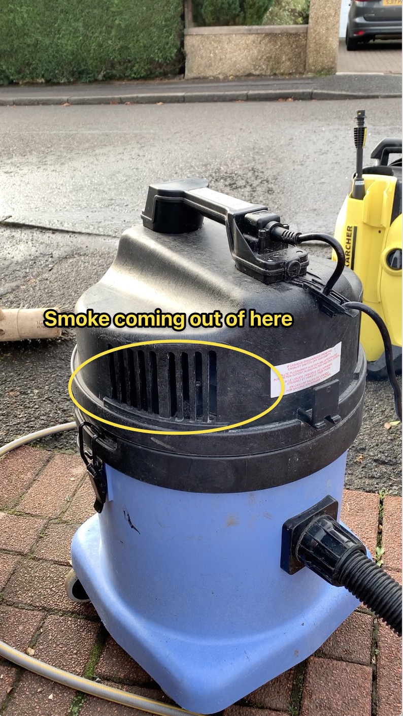

I have a Numatic CVD570 which is a wet and dry vacuum cleaner.
It was knocked over on my driveway accidentally whilst in use and when put upright I noticed smoke emanating from the vents that house the motors.
It is out of warranty.
I contacted the retailer from which I purchased it and they are quoting £223 to collect, fix and return it.
I believe it is one of the two motors that is smoking. I have found what I believe to be a suitable replacement on Amazon - https://amzn.eu/d/cYVH2oz
Would I be able to do the job myself being a reasonably competent DIY'er and providing this is the actual motor that I require.
Could it be something else within the vacuum?
I look forward to any help / insight you may be able to offer.
Kind regards, Gordon Hunter

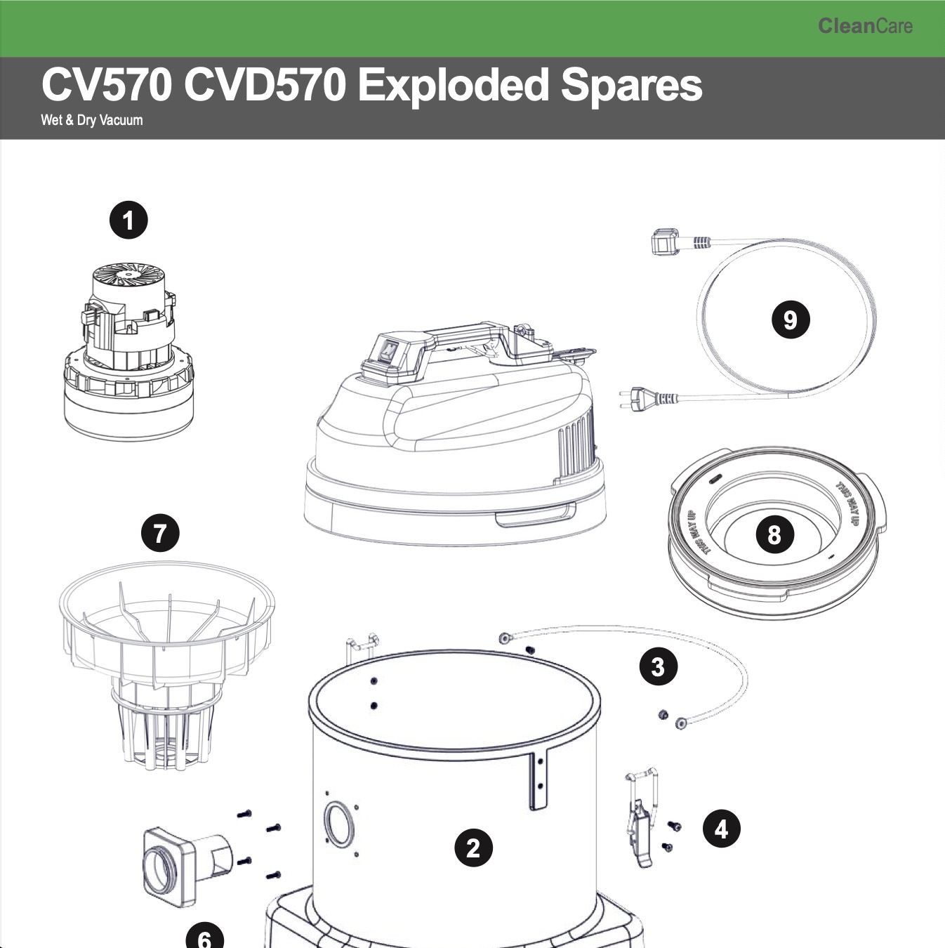

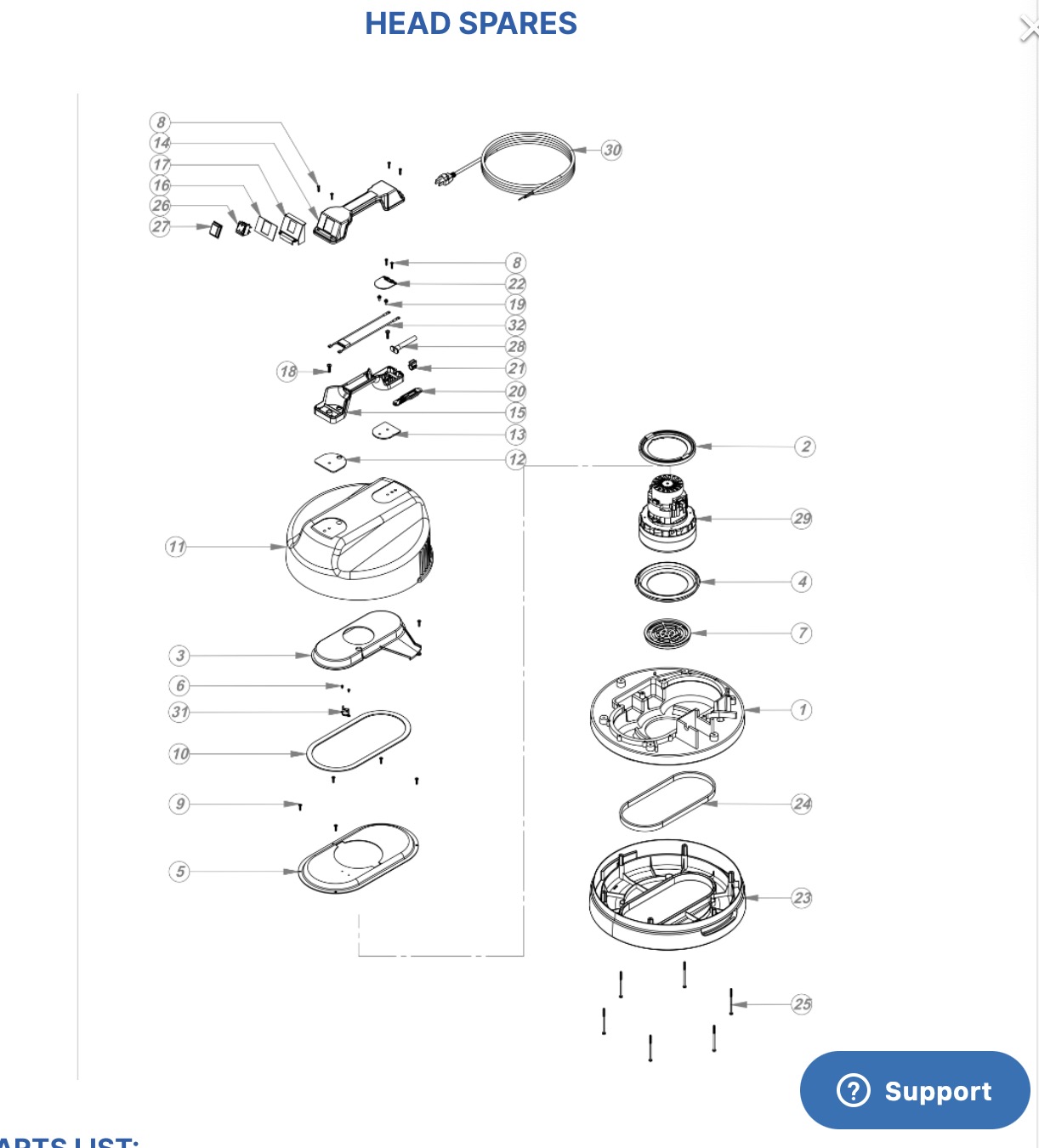

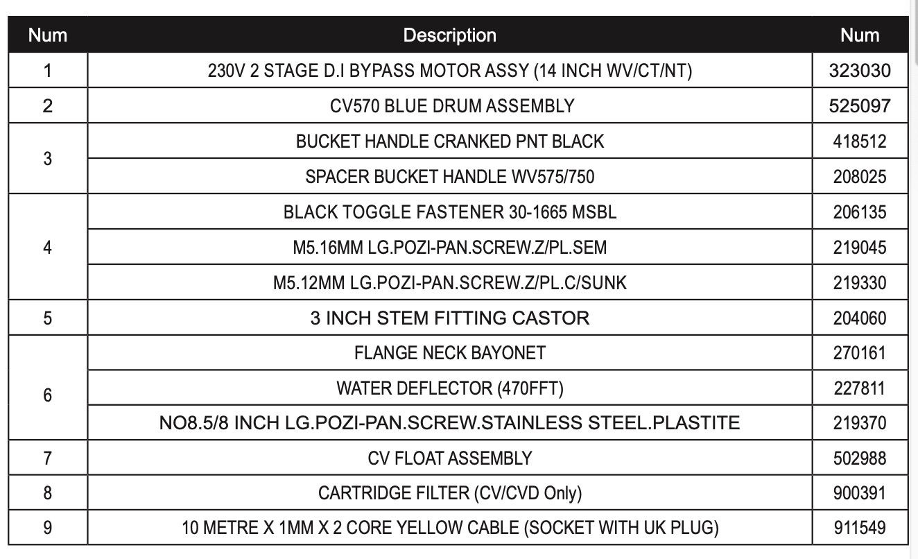

It looks plug and play by the looks of this drawing...
