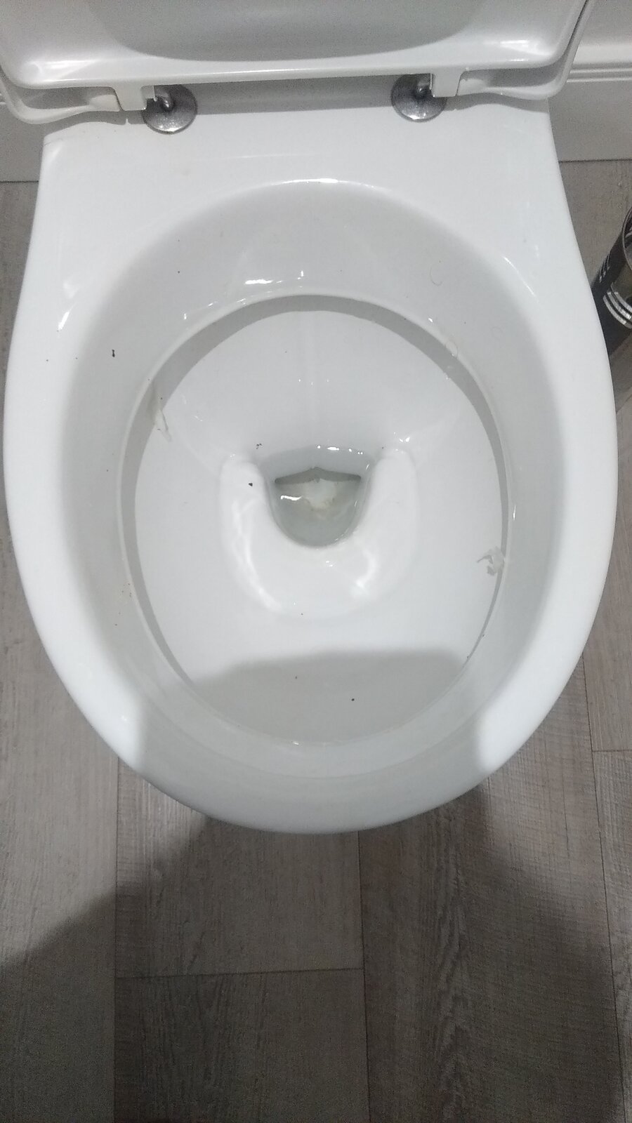

In my six year old Linden-built house there are two toilets on the first floor and a small one on the ground floor near the front door.
With regard to the ground floor one (see photo), at water level it is only about four inches from side to side and the water is only about three inches deep. There are no blockages, but it has proved difficult to flush away some "Richard the Third's".
Is there a minimum size of pan/bowl allowed? Are toilets with a larger pan/bowl able to fitted to the same fixings easily? Are these ground floor toilets really just meant for number ones?

1. The residual water level in the bowl has nothing to do with the volume of water used to flush. It merely reflects the level of the trap used to seal against the ingress of sewer smells.
2. More likely to be an issue with the volume of water transferring from cistern to bowl when flushed.
3. Modern WC's are limited to a 6 litre (maximum) flush, whereas it used to be 9 litres.
4. Inside the cistern there should be a line in the ceramic / plastic, usually on the back, which is the 6 litre mark.
5. Make sure that when full, before flushing, the water is up to this mark. If not, insufficient water is being flushed.
6. Additional water can be stored by adjusting the inlet valve float, to ensure the mark is reached before the valve shuts off. How this is done depends on the type of inlet valve you have.

Wider isn't necessarily better. For a given volume flow rate from the cistern, the differential pressure across the trap will be less than for a narrower girth, thus having less pushing force on the Richard. The shape of the trap, as distinct from just its girth, plays a big part in the flush effectiveness.
