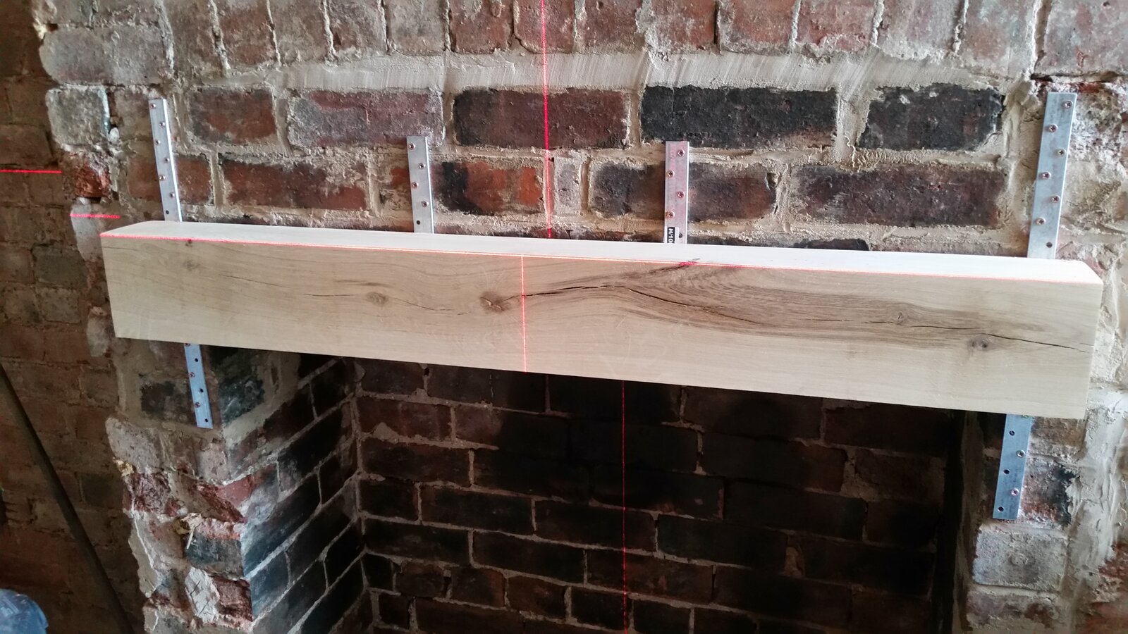

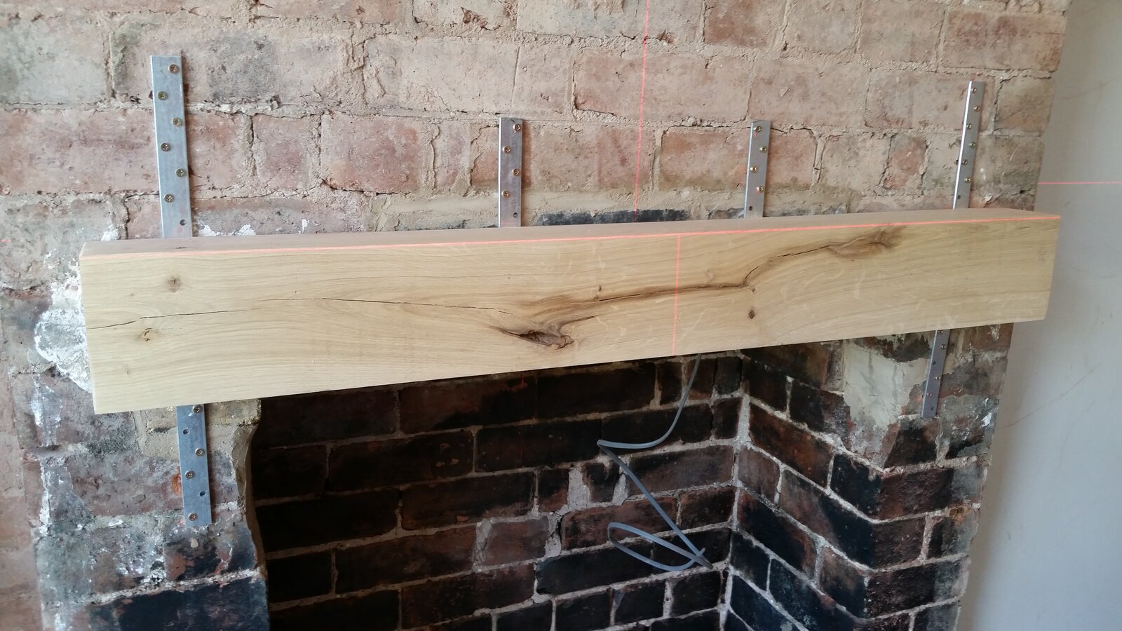

It may be safer to use a bracket arrangement supporting it from below or, if you want to use rods, have them in oversized drilled holes in the timber so there is room for it to move.
This method is rock solid and an easy way to ensure your levels are correct. It all depends on how much making good you are willing to do afterwards.
