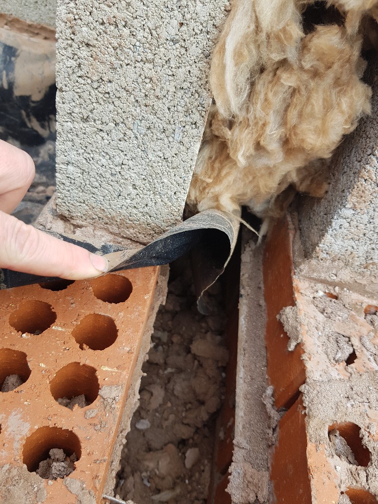

So i just want to ask, i have a couple of concerns so i feel the need to ask.
I have a bco inspection due, the lads who have done the brick work have got the structure up. Its all looking good but just a few things in the back of my mind.
At the outside dpc, the dpc strip has drifted slightly towards the cavity. I can see about 10mm of it sticking out inside, about 300mm along the wall. That means theres some mortar bridging the dpc.
They used dpc polythene 'skirts' / tails on the inside skin to tuck the floor membraine at a later date with the screed membraine, i know this is normal but it was layed directly on the brick below without a mortar bed. But they obviously put a mortar bed on top before laying a brick on top. There was no dpc strip like they used on the outside.
Is this anything to worry about. Id like to have seen it be a bed of mortar, dpc strip, polythene tails then a bed of mortar again but they said this is normal and done on new builds?
One last thing. The inner corner on one side the dpc polythene has ripped. Again got the 'its fine' but is it? Can it be fixed?
There should be a DPC internally, as the DPM can't be relied upon on it's own.
Knock the snots off in the DPC in the cavity with a stick or something.
Polythene can be repaired

Its no snots i am worried about. On the outside skin they have used a 100mm wide dpc strip. Part of the strip, say 300mm or whatever long has run out into the inside cavity. So you can see a good 10/12mm overhang looking inside the cavity.
So there definitly should be a reinforced dpc strip inside. The woven looking stuff that has been used outside.
Are you referring to that thing under the course of engineers on the right hand side of the photo? Is that a DPC?
Yes, its sticking out from there onwards. The rest of the course its inline. The dpc they stepped due to floor levels so outside dpc is 1 lower than inside. Personally i would have left them at the same level but they should they couldnt due to tucking the screed membraine with the tails
Well is not ideal, poor workmanship, but not really a problem as long as there are no snots on it.
Ok woody. So going back to using just a dpc sheet as the inner skin damp, thats still a no-no? Thats my main worry
**** poor workmanship.
Lack of DPC to inner leaf is out of order. Misaligning the DPC to the outer leaf is very poor. And personally I always ask for the DPC to be laid on a mortar bed not on bare blocks/bricks but plenty don't bother so you might want to let that one slide.
And what's going on with that cavity batt in the opening reveal? Looks like rats are nesting in it!
Iv had to have a dreaded conversation with building control. He did say hes really not happy about it and definitly not ideal. Hes willing to pass it as long as its lapped properly when he visits. All i can hope is we dont get a difference of opinion on physical visit.

I hear you woody. The builder has agreed to change it, but swears blind hes not seen it done another way, unless theres a change in level.
Bco have said its not ideal and prefer the other way but said its unlikley to be a problem. Its crap that theres so many things people do when theres a clear simple way of doing it.
