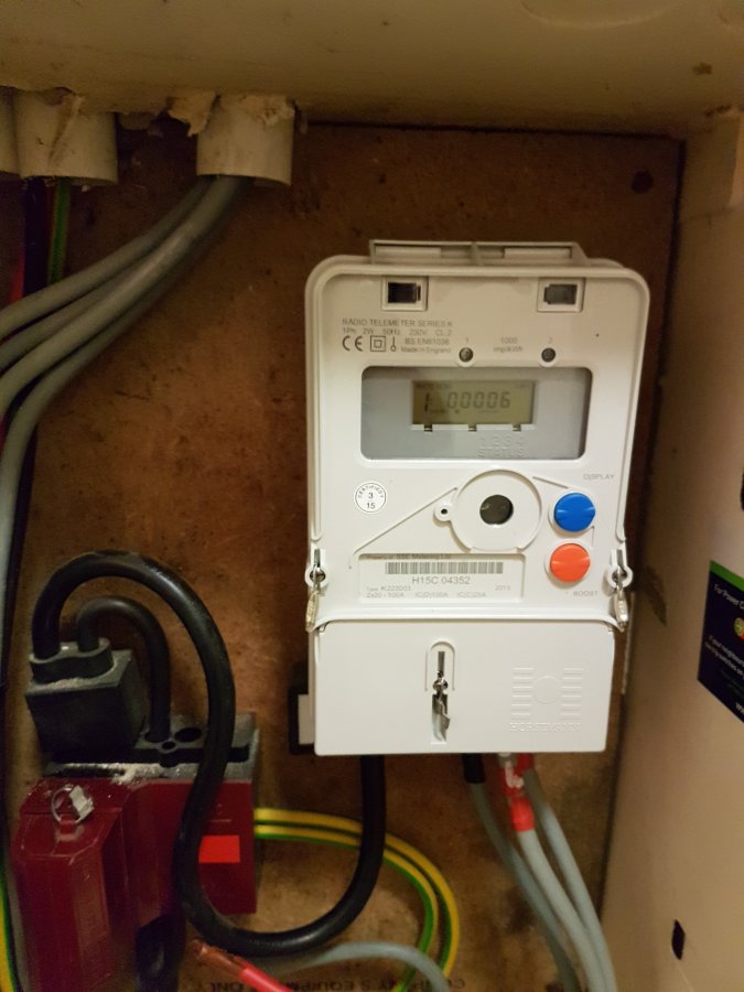

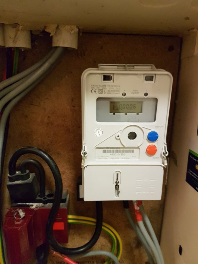

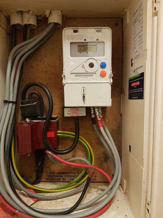

I can't see but it looks as as though a red wire has fallen out of your meter? Clearer photos of the entire meter/service intake area, and the consumer units, please.

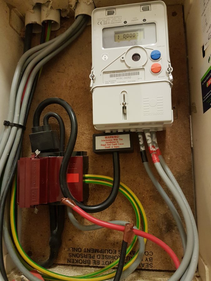

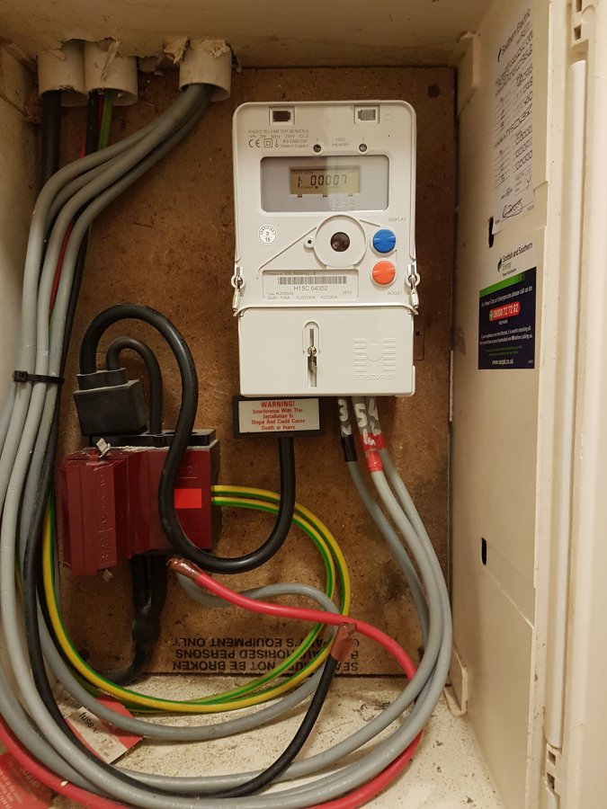

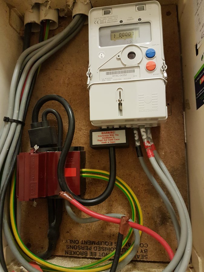

Hi,
The new meter was only installed this week and that red wire was never connected to it or the old meter. Just like the brown cable.
Hope these photos help?

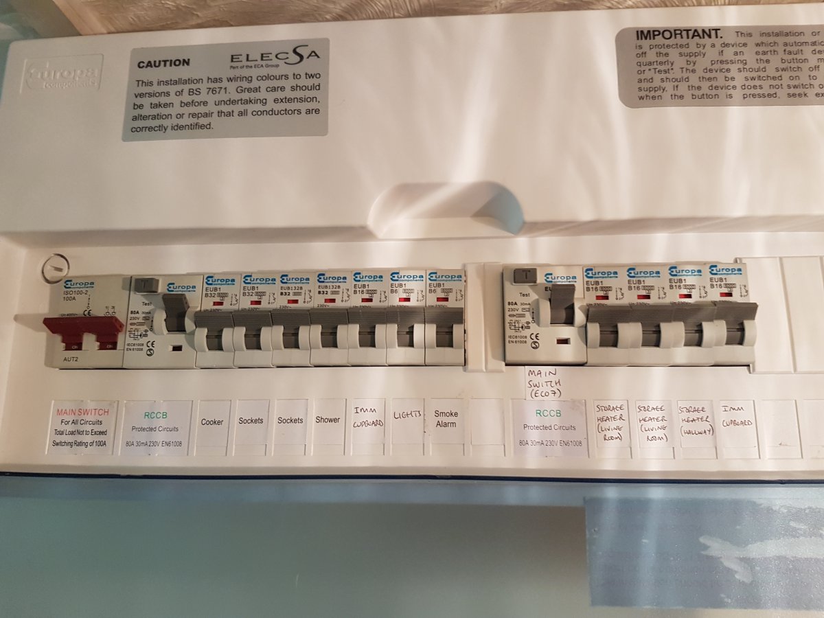

Meter has the correct number of wires, but it may be that one or both of the disconnected red & black wires with taped ends are in fact the ones which supply the off peak circuits.
Other than that, the meter is not switching the off peak output (this is exceptionally unlikely, as it should have been tested when the meter was installed).
But why the 4 tails going up the conduit, either check the meter after 22 30 and see if the rate has changed from 1 to 2 or vice versa, or take meter readings for both rates and see if there is any change

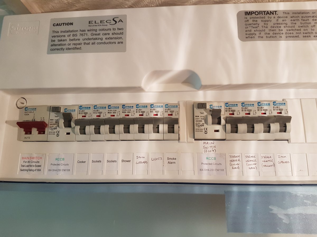

@Kizzmish the problem with off-peak faults is that live testing has to be done in unsociable hours!
If you have a two probe Mains voltage tester, or a multimeter, you could firstly test if there is 230v appearing at the incomer of the off-peak part of your consumer unit.
This is only something you can undertake if you are comfortable working inside a consumed unit.
The alternative would be to invite a friendly local electrician to stay with you overnight to test it for you.
Is that off peak part via its own RCD main switch although not 100 percent proof it would be worth pressing the TEST button during OFF peak hours, it may give some idea if theres power, without the need to remove the cover it should trip off when pushed
Is it just me, I dont see how that main switch could do as it says on the label "For ALL circuits" now we also have these dual rcd boards with a single main switch, it seems to be so easy to work on one of these dual supply boards, thinking the main switch has totally isolated the board, when it has not, should there not be a warning label on the cover.
