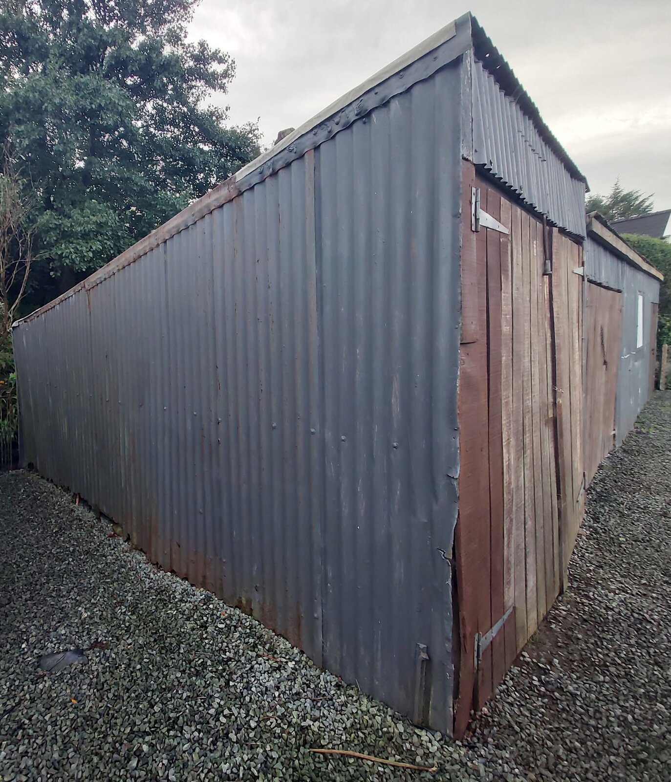

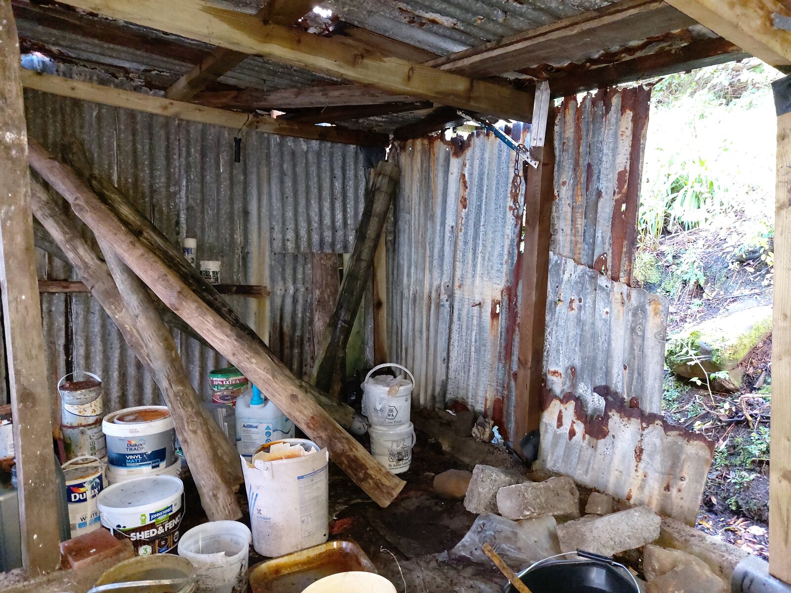

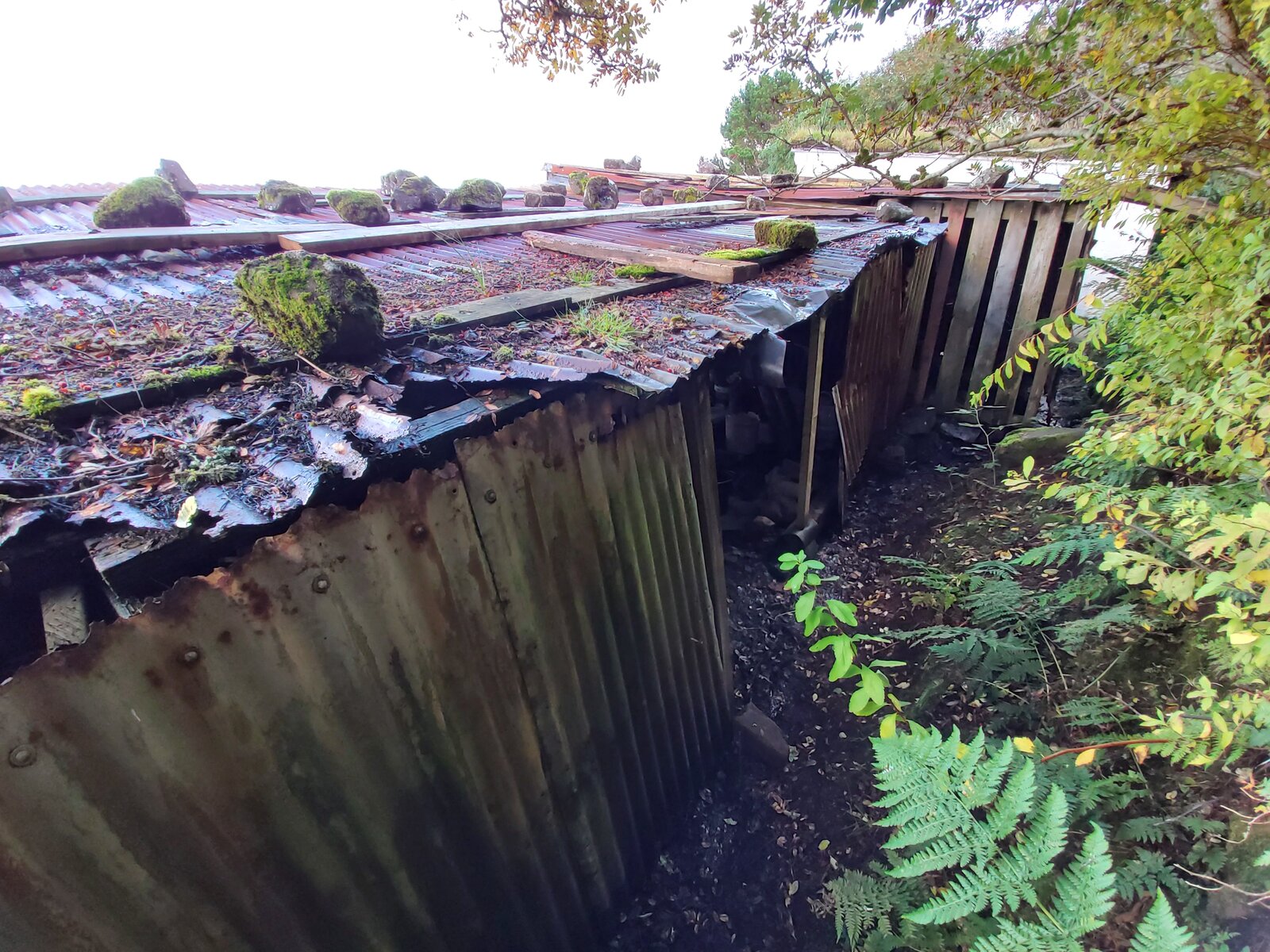

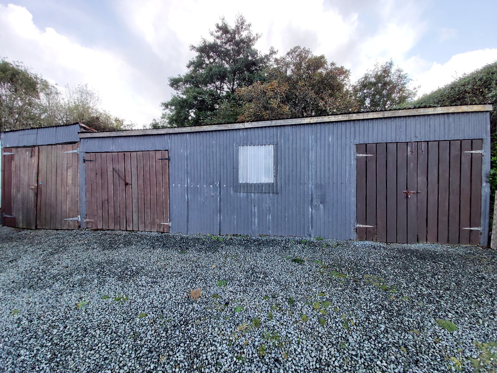

Here are some photos of the shed, my father says it was built in 1898, almost all the corrugated iron is original, most at the front is still in good condition, at the back and the roof it's not so good.
Think we're going to keep the front which is still good, we need to replace the back and roof as there are lot of holes in them, they're starting to show their age despite having been there for around 122 years.

You might be better to ask around farmyards locally to source old wrinkly tin? The old stuff would be thicker?
Good old shed, best off not having all the timber, stones and leaves on the roof, it just accelerates rot. If the sheets are lifting in the wind get them secured down.
Traditionally it was twist nails, with galv or rubber washers, which you can still get, but tek screws and an impact driver are easier!
If you redo the roof defiantly worth adding a few skylights. You can get plastic/fibreglass to match the profile of the tin, or the old fashioned way was a tin sheet with a frame in the middle to take 2 panes of glass.
