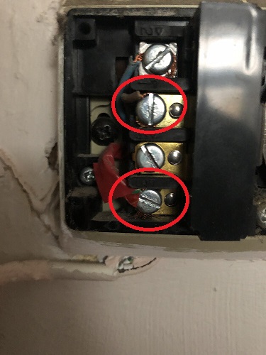

I have a combi boiler used for hot water and central heating.
I currently have a very old Honeywell thermostat (attached) which has stopped working and want to replace it with a newer one I've just bought.
full
The wires from the wall are as follows:
Brown wire
Black wire
a wire that has red tape over it. which I am guessing is the switch live...
full

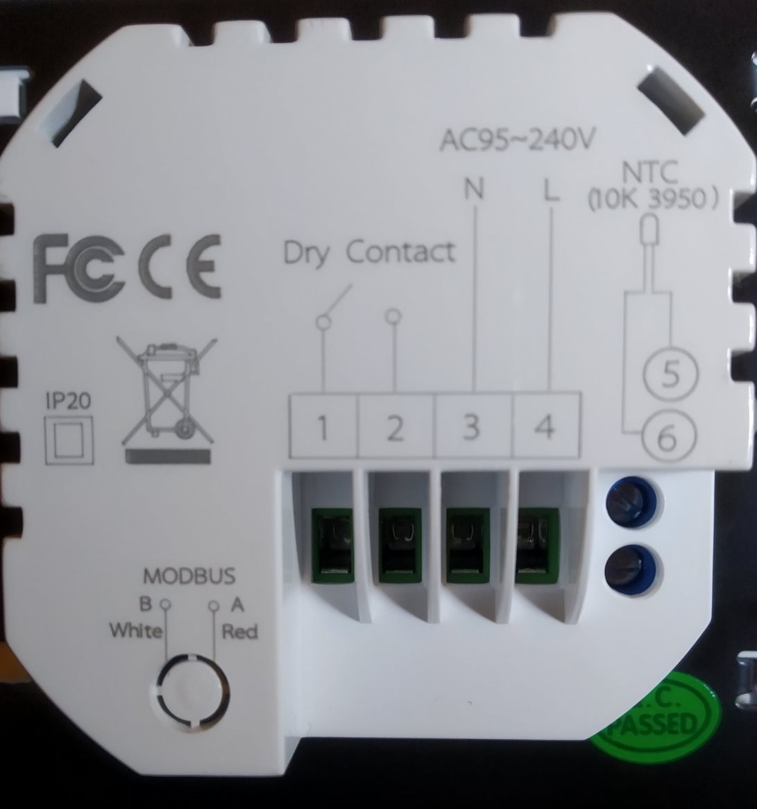

the new thermostat has
4 PORTS. 1 AND 2 are dry contact and 3 and 4 is live and neutral..
For my setup is this correct:
Connect the brown wire to Terminal 4 (Live)
Connect the black wire to Terminal 3 (neutral)
The wire with the red tape (switch live) to Terminal 2
Then used a jumper wire to connect from Terminal 4 to Terminal 1.
Let me know please. Need to turn this heating on...

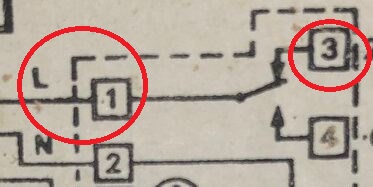

There should be a diagram inside the lid of your old Honeywell T6060 showing what each of the terminals does. From this the function of each wire (if it has been correctly installed to start with) can be identified. I believe that the diagram will look like this.
If it is the same as the above, then the connections are:
1 = Live
2 = Neutral
3 = Switched Live / CH ON
Note: the terminal numbers are not actually in numerical order. So check them carefully they have little arrows from the numbers to identify them.
If the diagram inside the lid of your thermostat is different from the above post back a photo of it, and don't proceed. If it is the same, then:
Live = Honeywell 1...Goes to new stat 4
Neutral = Honeywell 2...Goes to new stat 3
Switched Live = Honeywell 3...Goes to new stat 2
You will also need to add a link wire between the new stat terminals L and 1
Finally assuming that the new thermostat is programmable [has both time and temperature control functions built in] any existing timeswitch / programmer will need to be set to be permanently on.
EDIT. The green / yellow wire (normally used as a earth wire) has been used as a live wire. This is bad practice and should at least have had a brown sleeve over it to identify it as such. The red insulation tape that has been used is not a suitable substitute.

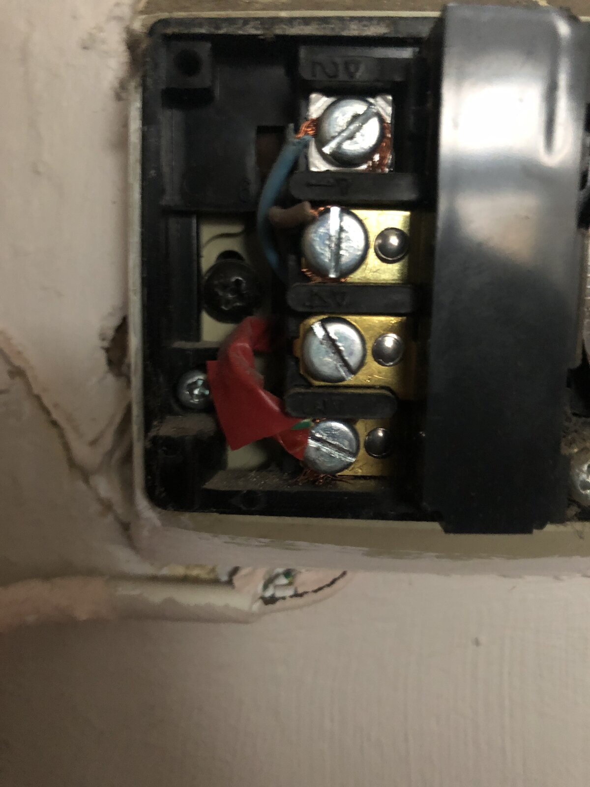

The wiring is exact how it suppose to be and the thermostat does not turn on. think its faulty?
This is what's at the back of the Honeywell stat.
Thanks for the diagram, it corresponds with the one I posted. So far, so good.
I assume that you have set any existing timeswitch / programmer to be permanently 'on' 24/7
If you have, and assuming the thermostat is set up properly but still isn't switching the heating 'on' when it should do, you can test the wiring by moving the wire with the red tape on from terminal 2 and putting it into terminal 1 with the brown wire. If the heating comes on after doing that, the wiring is OK but the thermostat is not.

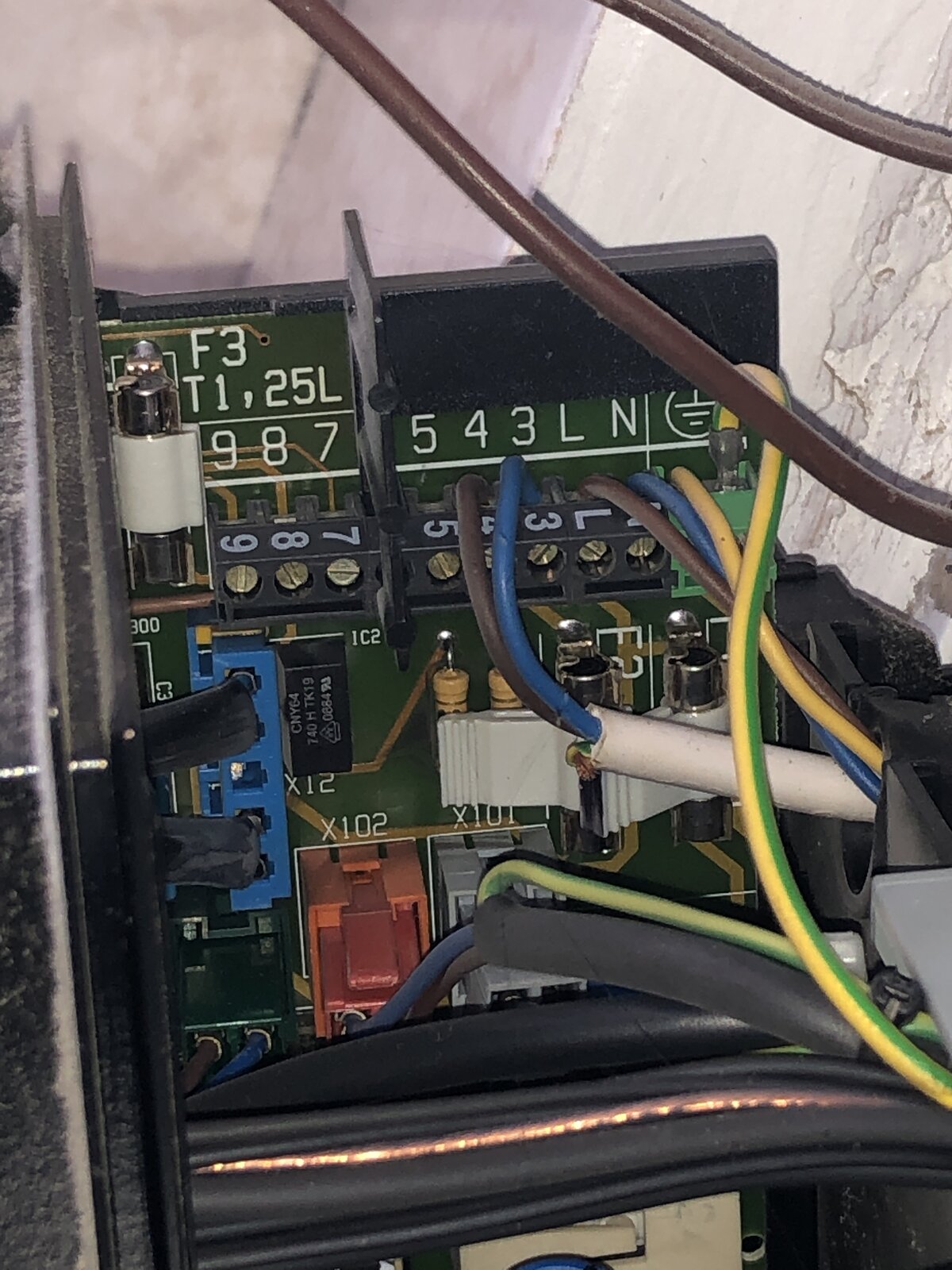

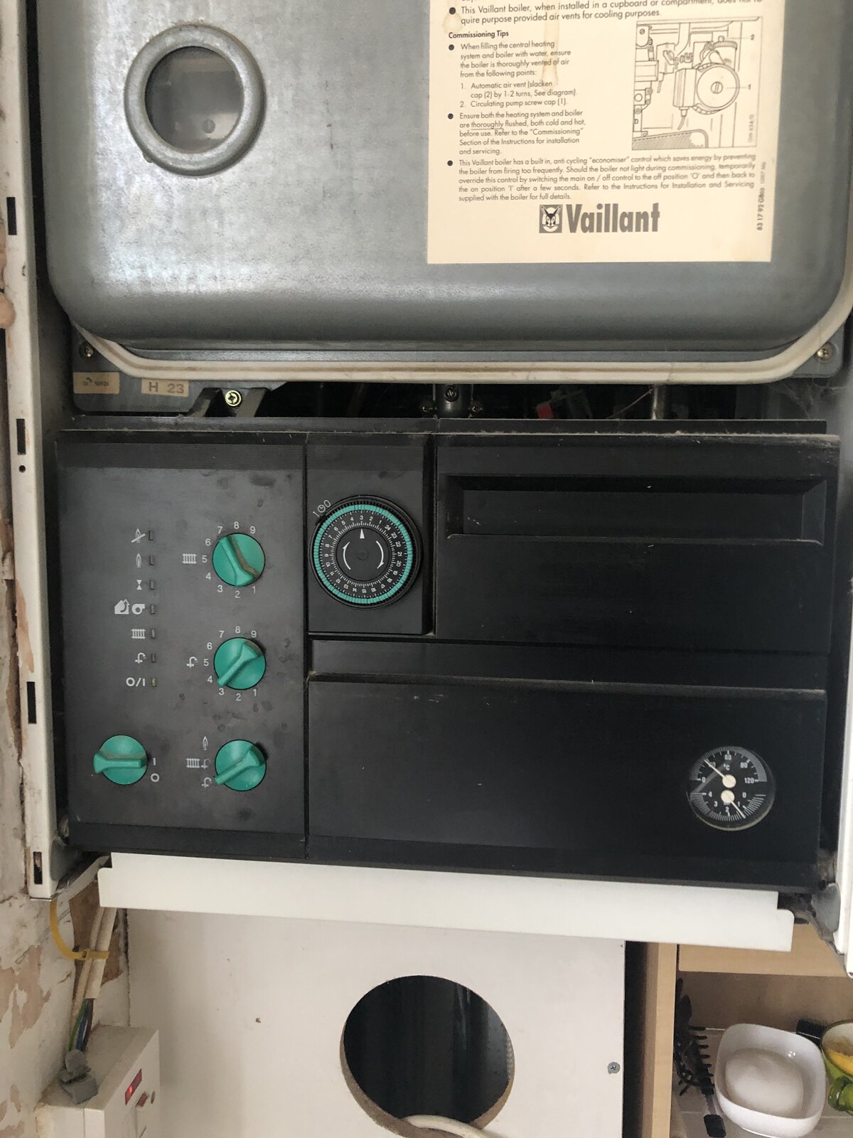

I am going to get a multimeter from my brother's house. In the meantime, i have taken photos of my boiler.
It doesnt look like its connected... i am assuming 3 for 4 is the cable connected to the stat...... but the earth wire which was supoose to be the switch live, is not connected...
If that cable is the one that went to the thermostat, it looks like you have solved the lack of a 230V supply.
Although the connections at the thermostat don't correspond with how its connected to the boiler at the other end, which would mean if you followed, my thermostat wiring exchange table, the connections would remain incorrect. I don't see how the old stat would ever have worked, unless there is a junction box somewhere and the wiring changes en-route.
Probably best to rip it out and start again from scratch.

If that Turbomax is anything like the other Vaillant’s, then 3 will be a permanent live and 4 will be switched, 5 is a spare neutral.
.....indeed and there's the conundrum I was referring to earlier. If the photos are of the opposite ends of the same cable, it doesn't make sense.
First, as per @Chris_W says: boiler terminal 3 (Blue wire) and boiler terminal 4 (brown wire) are both lives. But at the thermostat end the blue wire is connected to the neutral terminal!
Secondly the green and yellow wire (with red tape) which is connected to thermostat's terminal 3 which is the 'switched live' but at the boiler, it doesn't go anywhere!...yet the OP tells us the old thermostat worked....I know it was Halloween yesterday but come on, an unconnected wire turning the heating on and off :eek:

The Thermostat switching terminals are 1 and 3 as per the diagram in the lid.
Which have the brown wire and the green/yellow wire (with red tape on) connected to them

So in fact, if i powered the new stat using the mains, then use 3 and 4 to 1 and 2 of the dry contacts on the new stat, this should work.... as the new stat should close the switch when temperature is set...
