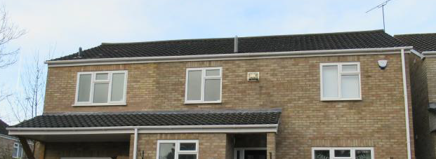

Hi
Could i ask opinion please. In process of buying house.
Building survey revealed milk crack going through brick as in photo. surveyor mentioned evidence of past movement based on this. Mentioned condition 2, rake and monitor over 6 month period. if required to get on structural engineer report for ongoing movement and to inform insurance company. i could see the similar size of the crack in similar place 3 yrs ago in google maps photo. Structural engineer advised? House 42 yrs old. I have not spoken to estate agent or surveyor yet. thanks

Any chance of some other images to locate the site of the crack.
Now to the good bit? if you can prove by reference to Google Street view that the crack has been there for some considerable time it can be assumed that the crack is simply thermal, not Structural?
Ask the Str. Eng what is the problem?

As the crack is over the small extension at the front, it's most likely to be the rsj below it. Was the building survey done by a qualified surveyor, or just a home boyers type report.
If it's structural movement, then the insurance should cover it, but there'd be a £1000 excess, so the existing owner should inform his insurance company, and deposit the excess with your solicitor in case you have to pay out. But if it's the rsj that's defective, then this could be a few thousand for renewing it, and then replastering and redecorating again.
It's a thermal crack - common shrinkage. Those bricks, and that location, and three course of bricks make it insignificant. Nothing to do with any beam or any distress.
The fact that you have paid for a surveyor who had failed to diagnose this would be more concerning. I'd love to know how he has reasoned structural movement from a vertical crack.
As long as there is no corresponding crack on the inside ( which would indicate movement) then it's nothing to worry about. It should need to be filled, and a clear mastic would be the most unobtrusive.
And get a refund from the surveyor.
This is the exact wordings from Building survey report as below. Also the photo of inside of property which is tiles and may not be able to see the inside of crack. What would the structural engineer would say ? can they predict the age, historical and non progressive just from outside Or do they likely say it needs to be monitored ?

There has been no movement if that crack is this only evidence. That crack in no way is indicative of structural movement, and any surveyor should know that.
You have had a very poor survey, and that description and recommendation I would suggest, is not to the standard of what an RICS member should be meeting.

Suggest that you may want to ask the Surveyor what is the method of movement? is it the downward movement of the Foundations [the Insurance Companies definitive test for Subsidence?] Or is it some other type of movement.
Suggest that you also point out that the same crack can be seen on an unaltered digital image from several years back??
Is there any corresponding cracking anywhere else?
As for the Surveyors suggestion about rake out and re-point, absolutely NOT because the colour of mortar will vary wildly, then guess what when the property is next up for sale a bright eyed and bushy tailed "Surveyor" will spot the difference in colour and hey presto this entire Circus will start up again.
As "Woody" use clear mastic, do not smear it on use a fine tip on the applicator and squeeze the mastic only directly into the crack.
It would appear that the general consensus of the board and one to which I agree is that the crack is thermal, look at the position?? a narrow top to bottom section of brickwork no expansion joint in the gable [Expansion joints should be built in at about 6. M C/Center according to modern day practice] And a perfect "Slip plane" exists on the DPC which will probably be on the top surface of the lintel that this area of brick is bearing on???
Thermal nothing else.

What you need to ask the surveyor is if she has explored all the possible reasons for that cracking, and then discounted each possible cause one by one until she arrived at the most likely cause?
Where is the rotation to indicate differential movement?
Why is the crack there and nowhere else?
Where are the other cracks to support a conclusion of structural movement?
Why is there no internal cracking?
Are those bricks in that exposure susceptible to any particular cracking?
Those are just some of the questions she should be asking herself in reasoning a possible cause of the cracking.
Thank you all for your opinion and put my mind at rest especially Ken and Woody. I spoke to the seller and the crack was there when they bought the house 7 yrs ago. Showed evidence in their brochure. I am just going to leave it as it is.
