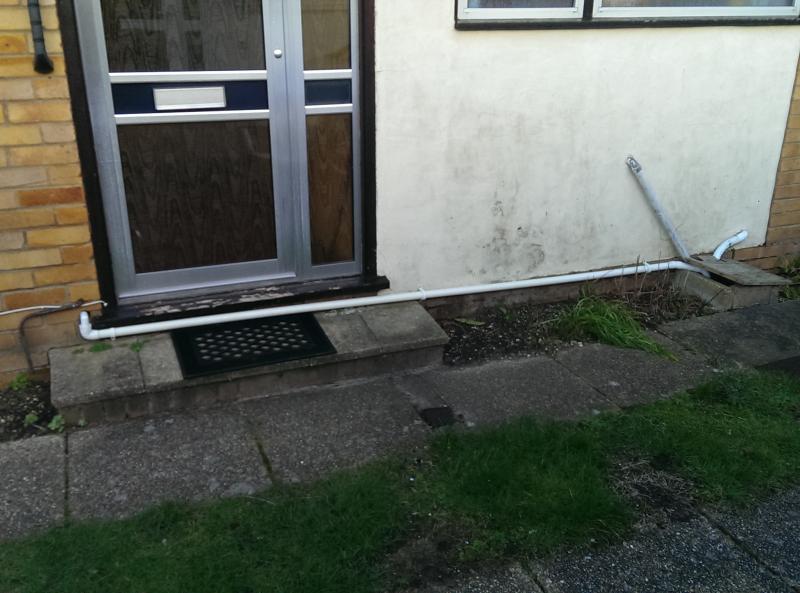

I'm interested in your considered views of this installation and also thoughts on an issue.
My mother-in-law had her conventional boiler replaced by a local fitter with a Gloworm Combi, I can't recall the model off hand, but if it's important will find out.
Looking at the attached pictures, what is the general consensus? The boiler was installed into small cupboard which was previously used to hang coats etc (so is fairly small). The cupboard also has the electric consumer unit and meter in there.
I think the run across the and under the front door is excessively long and pretty unsightly, as is the gas feed pipe up the front of the house.
It all works, however, if the hot tap in the kitchen and bath are run at the same time, the water pressure drops very low, apparently the fitter can't understand why this would be the case... any ideas on what could be done to improve the water flow?
As its a combi it will only do one tap at a time, looks a bit unsightly but pioe runs should have been discussed at survey stage. We can't see inside the house so going inside might be impossible/damage (too much). Seen worse.
There may be a flow limiter in the cold inlet to the boiler that ensures the water out the boiler is heated, open two taps this limit is split between the two. (I dont fit gloworm or Vallaint so thats a guess)
The gas run was surely brought up at quotation stage and agreed upon (you could paint it or camouflage it) Be thankful the gas was upgraded many poor engineers wouldnt bother!!! It may look bad but is necessary.

At least he run the condensate pipe in 32mm...!
Most installs I've seen aren't.
What newgas means is the boiler will have needed a certain sized gas pipe, the old boiler will (probably) hAve had 15mm to it which could (will) have been too small for the new boiler. He mightened have been able to do it internally without causing damage to decor.
The paving slabs should been lifted and the pipe buried. Looks terrible.
For aesthetics and freezing protection to prevent blockage. Very shoddy workmanship.
Do gas installers not carry shovels these days to do their drainage work? :LOL:
