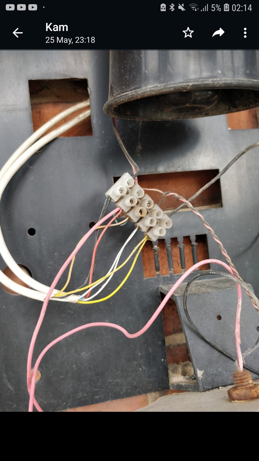

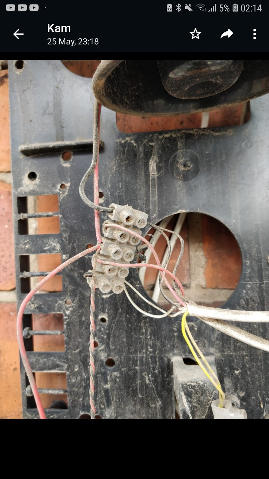

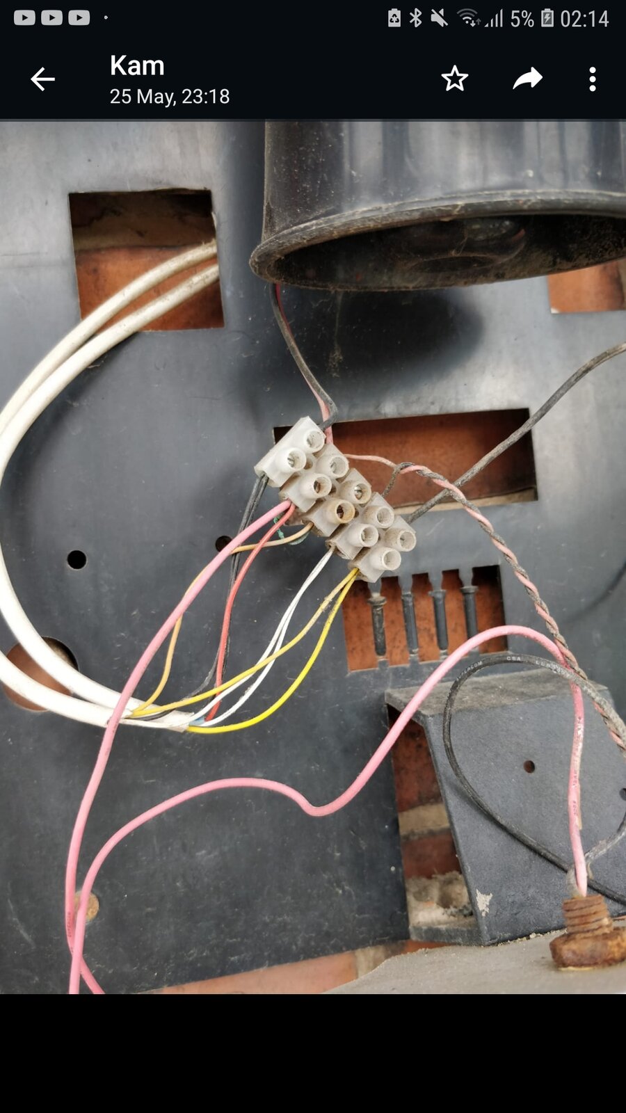

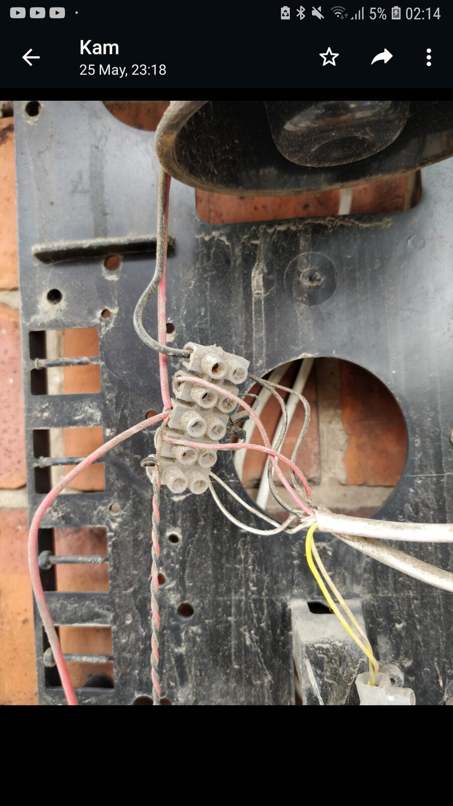

I'm replacing 2.bell boxes.
The existing boxes have connector blocks with no markings. Although I realise it's not hard for you guys to identify the wires.
The complications for me is there are 4 panels , 2 bell boxes out the front & 1 out the back of house.
I'm just not sure about the links & the resisters ?
Can someone help please?
In the pictures but out of view, there is a led that has a Black & red wires to it .
Then siren & strobe.
1 wire that's puzzling is the 2nd picture, 3rd connection . It looks orange in pic. But it's faded yellow with streaks of red running down it.
It's connected to the link wire(green)
I looked in flat 1 & couldn't see this wire in the panel. So I'm guessing it's from the back bell box??
And to complicate things the panel we opened was scorched from heat damage, over the years. When we fitted case back it wouldn't reset with the code. So we isolated by the landlords supply. This turned all 4 flats off.
I also had to remove a wire in panel for alarm to stop (scb) . Because even after removing 12v battery & fuse spur in flat, the back bell box wouldn't stop sounding.

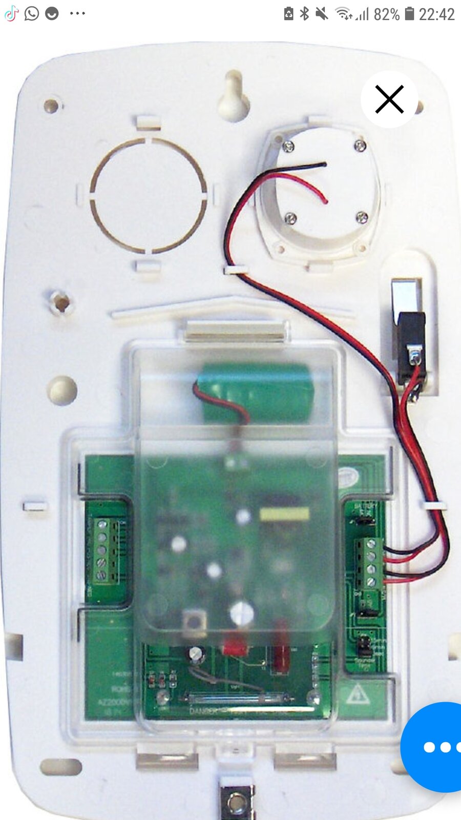

Don’t see a battery in the bell boxes, it has to get power from somewhere, 1 of the four panels???
looks like it’s an off on sounder with diodes to stop feedback rather than resistors but can’t be certain as it’s a tad dirty. That would make some kind of sense if it’s wired to four panels.
You say it’s 4 panels linked to two bell boxes.
Wire colours are not important it’s what they are connected to.
picture of panel wiring may make things a little clearer.
what bells are replacing these with?

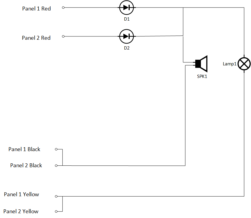

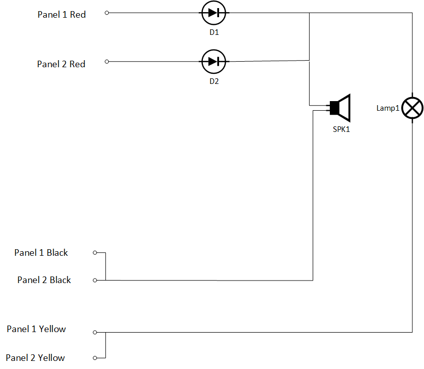

My best guess so far - not sure about the white wire in the first picture with the LED connected
Panel reds connect to 12V
Panel blacks are the bell (-) connections
Panel yellos are the strobe (-) connections

Your bang on, sorry. They are 2 diodes yes. And the other box's wiring has the link.
And there's no battery in boxes.
So 4 flats, 4 optimas, 3 bell boxes.
2 boxes in pictures at front of house. 1 box at back of house, but boxes are 3 stories up, I've only got access due to scaffold that's been up 6 months ...lol.....Now the scaffold lads are wanting to take it all down. So that's where I come in.

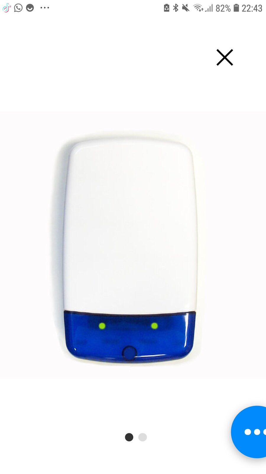

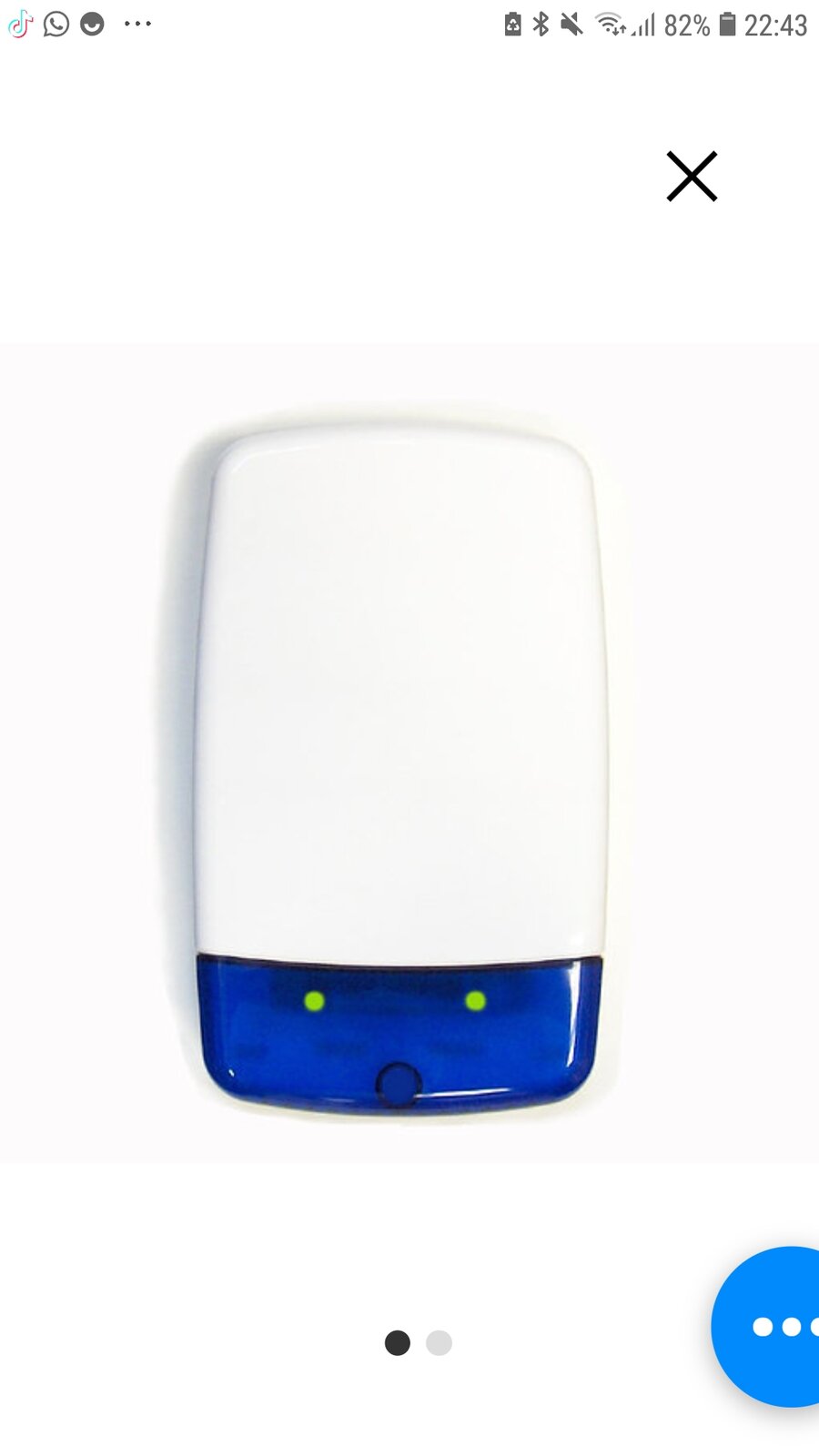

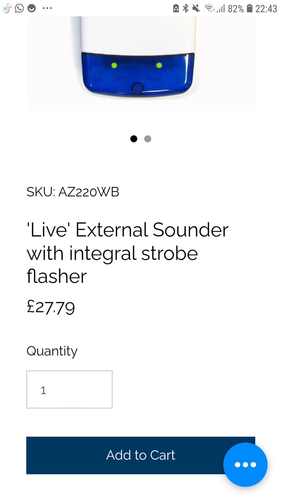

What are your replacement bell boxes to be?
I don’t have access to the site, however if that’s not possible you need to check you can fire each panel via bell and strobe tests.

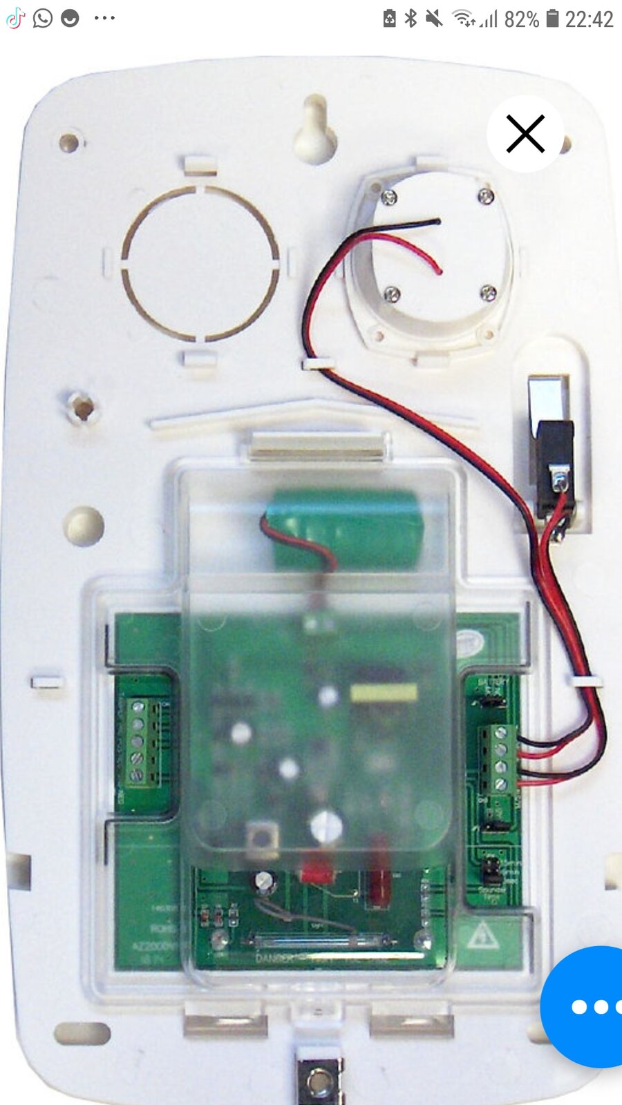

so on your current bellbox you have
Siren
Strobe
Comfort LED.
can’t see where all the wires go to be fair.
so you could swap the siren wires out of the chop block and wire to the bell positive and the bell trigger and the siren should trigger.
