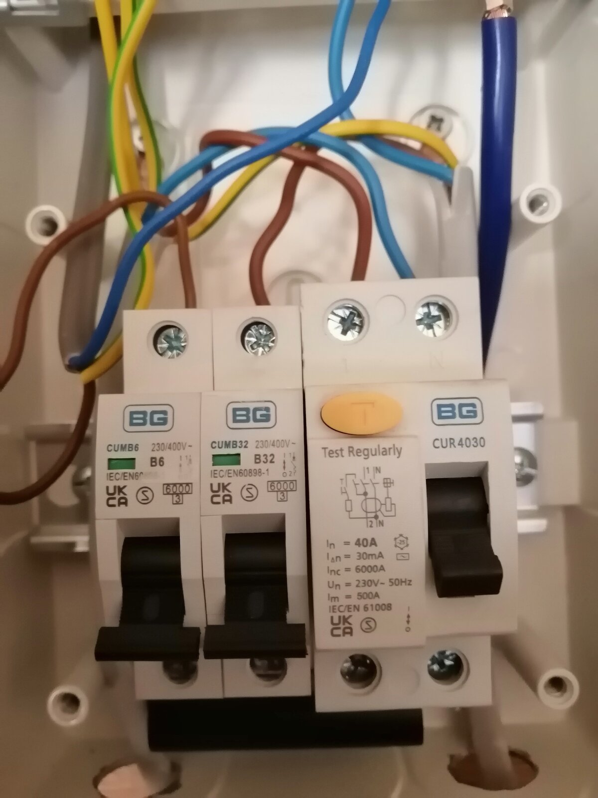

Hi I took my electric from my concrete shed I don't use via it's SWA so I ran the SWA to an outside junction box then connected a 6mm wire in through the shed to the consumer British Fortress CU from there I ran a 6mm wire via the 32 amp breaker to sockets ( 3 double) I can use my pillar drill that's OK but when I used my chop saw or compressor it trips the hose breaker please help I am a DIYer but want to fix as I know it must be something simple to fix. All metal sockets in shed and all got fly earth to casing too.

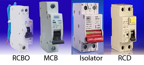

Size and type of breaker please,
it could be earth leakage with an RCBO or RCD, or overload with RCBO or MCB. It may be the inrush with chop saw or compressor specially the latter. You may need a different tripping curve, we have B, C, and D which equals 3-5, 5-10, and 10-20 but before changing need to know the loop impedance.
Also the RCD comes as types, AC, A, F, B mainly to do with DC and frequency, need more details.

This is inside my CU

Top cable for lights bottom right for sockets and bottom left for power coming in
The picture does not seem to show 6 mm² cable able to take 32 amp or any doubling up and conductors in parallel. Electric circuits are designed not thrown together, so we know the pair of MCB's limits the current to 38 amps, we know using a type AC RCD, and to get within the current rating the supply cable must be 6 mm² or more.

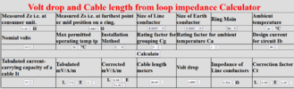

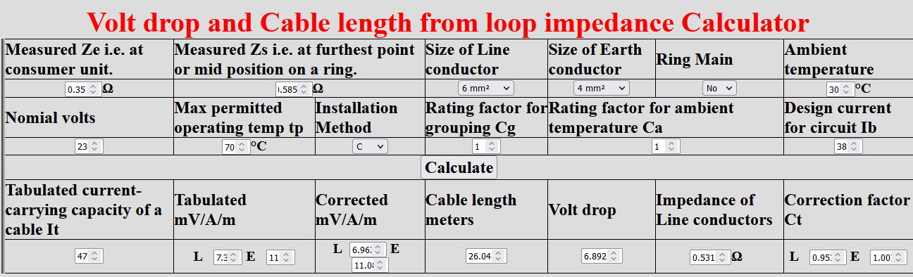

Using my program 1653984394570.png I have worked out needs to have no more than 26 meters of supply cable, other wise volt drop is exceeded, and when I measure with the loop impedance meter between line and neutral I expect to see around 0.58 Ω or a PSCC of around 400 amp, since a B32 MCB needs 1.365625 Ω and a C32 0.682813 Ω then seems limiting factor is volt drop.
You say you have used 6 mm² although the picture does not seem to show that, and it would need to be supplied from a 40 amp MCB in the house which you have not confirmed, you have said you have a compressor, but not said what the in-rush is for it.
