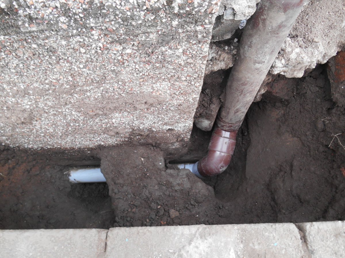

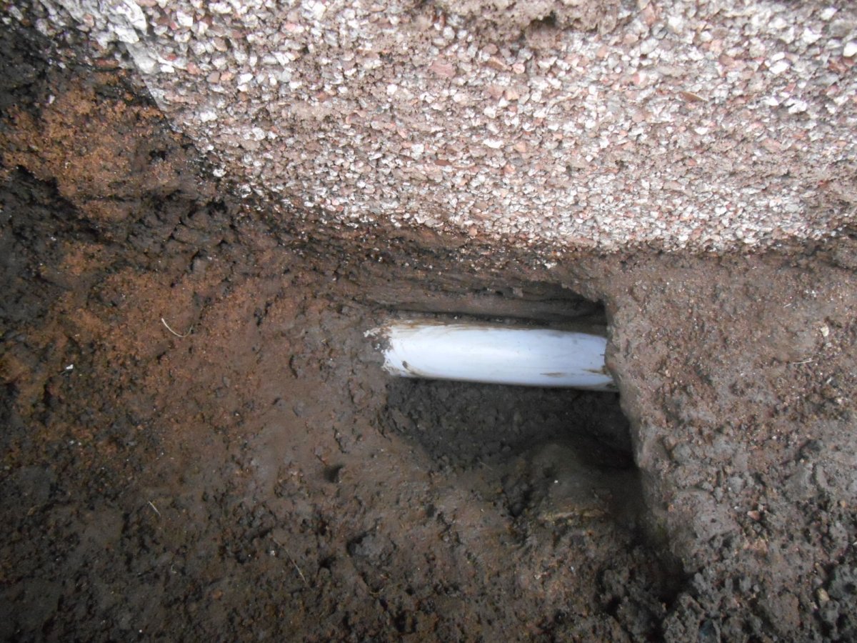

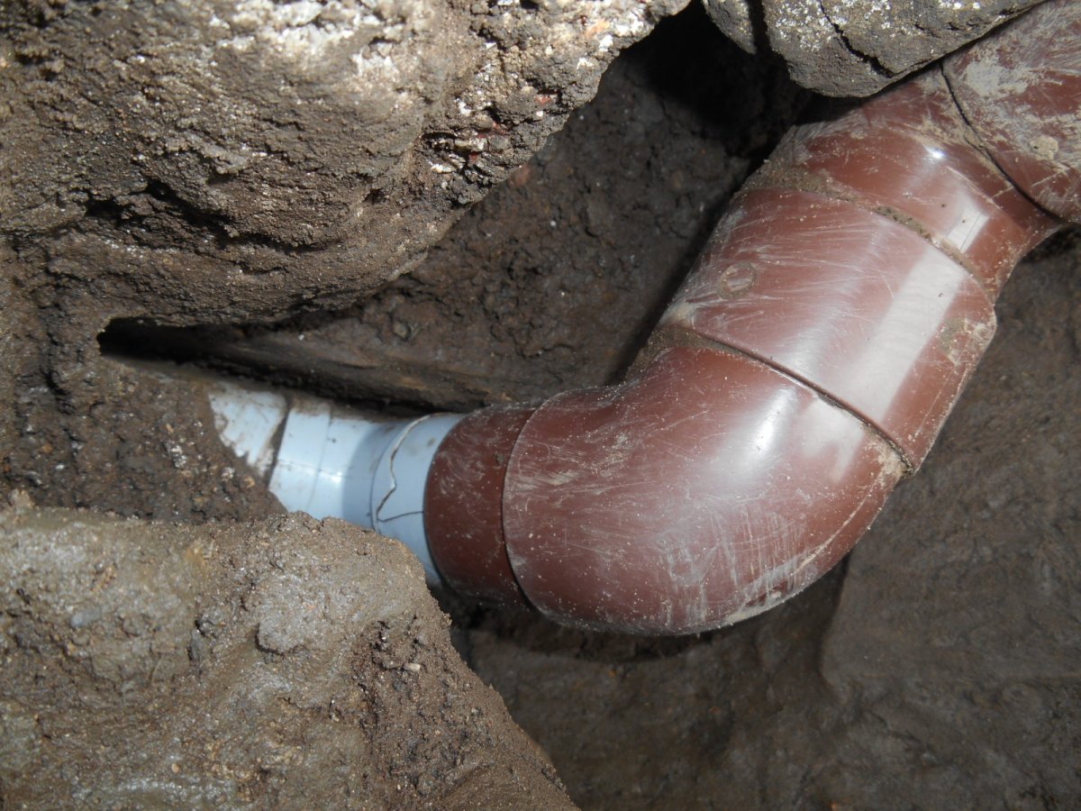

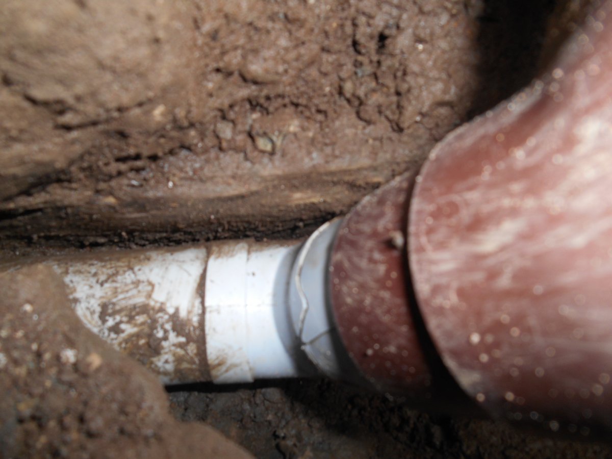

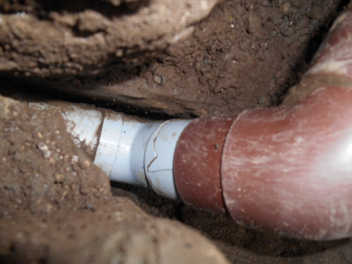

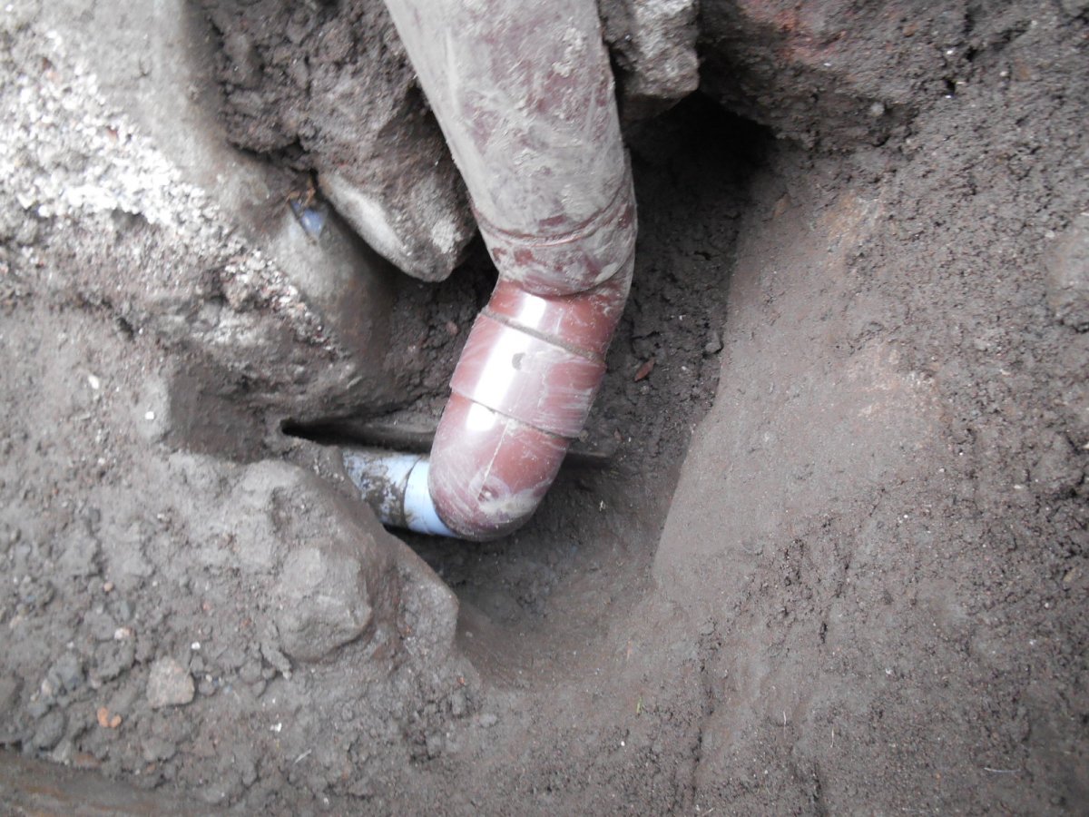

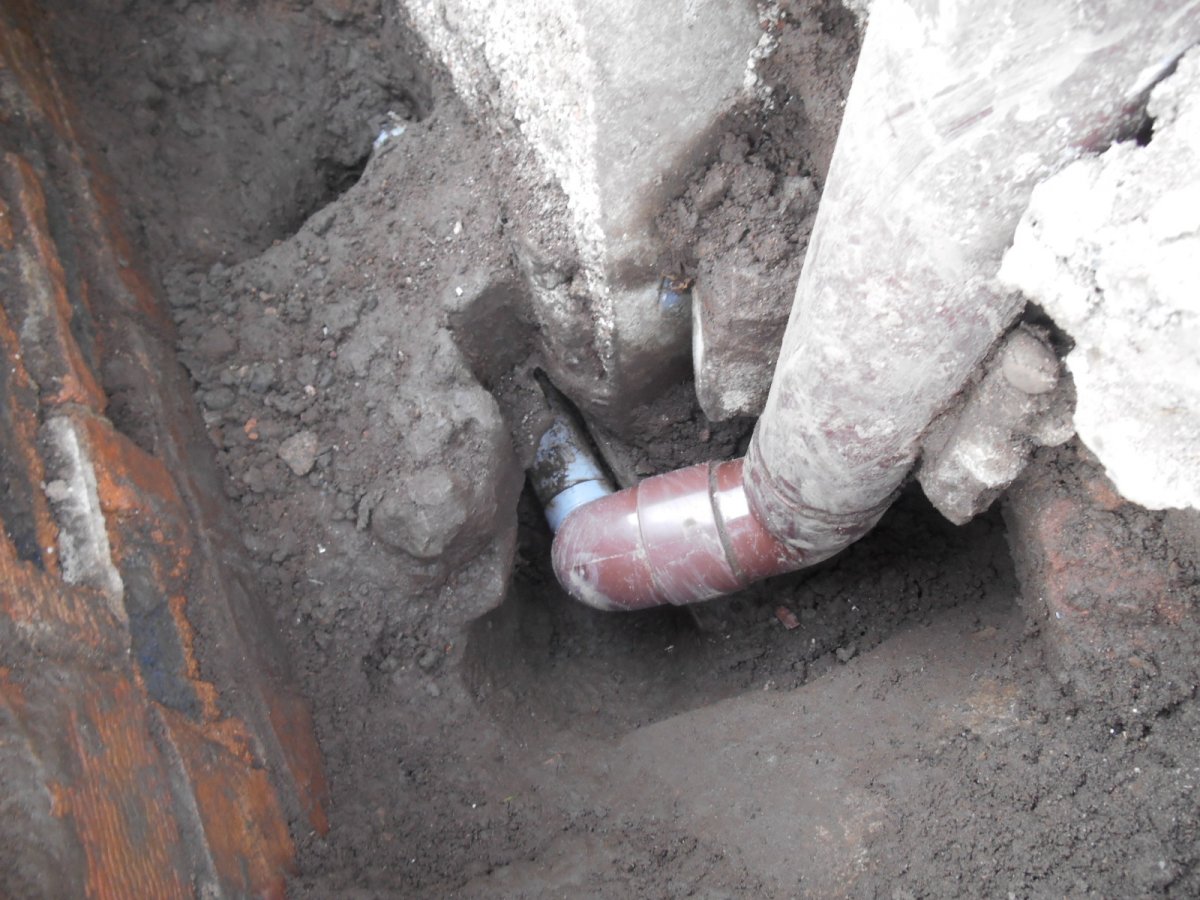

Hi guys
I have a cracked pvc pipe joint taking rain water from the garage guttering to the drainage system.
Very litttle room to work and replacing a whole section would be a last resort.
is there a way I can bypass the broken section - maybe by joining a flexible pipe from the downpipe into the pipework below the damage.
Thanks for any advice

Cut out the damaged section.
To bypass the damaged section you will have to make the same cuts as to bypass it so why not just replace?
Looks like the wrong grade of pipe was used not rated for use below ground.
