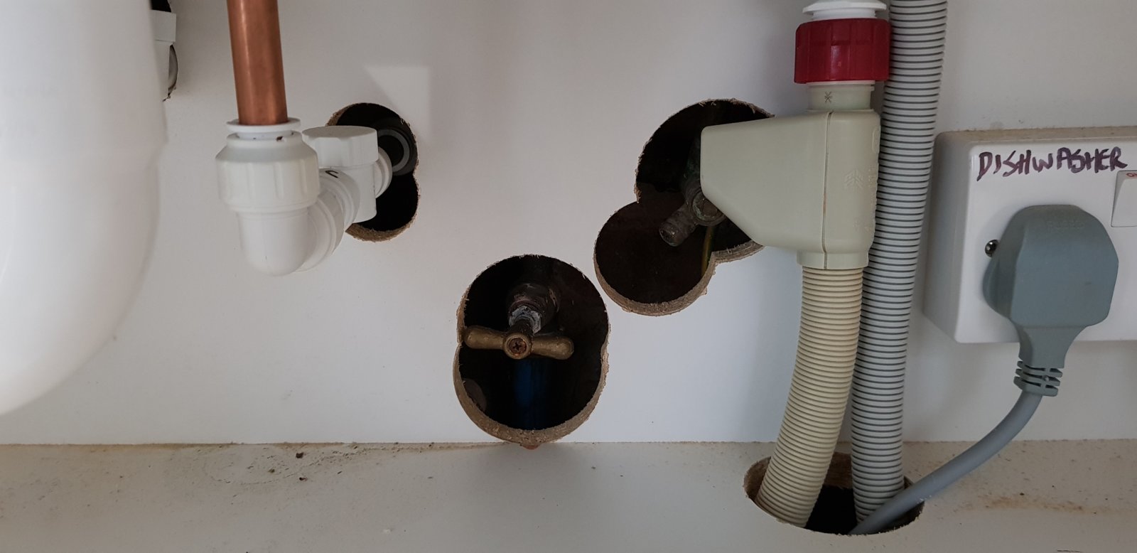

Do you have an internal stop tap? If so post pictures.
Andy
Yes, and it is working correctly. No problems there.
I'll have to pull out all the stuff from the cupboard under the sink and, if time, I'll do it tomorrow.
Andy
Here is the internal stop tap. I'm afraid I can't show any more without dismantling the cabinet!
The tap turns very easily (just tried it again) and was last used when the kitchen was done out a couple of years ago.

Turn it off and on every six months, once turned on then turn it back 1/2 turn. This will ensure you stop tap is working correctly.
You have nothing to worry about.

you should label the plug "dishwasher"
Not the socket.
anything might get plugged into it.
