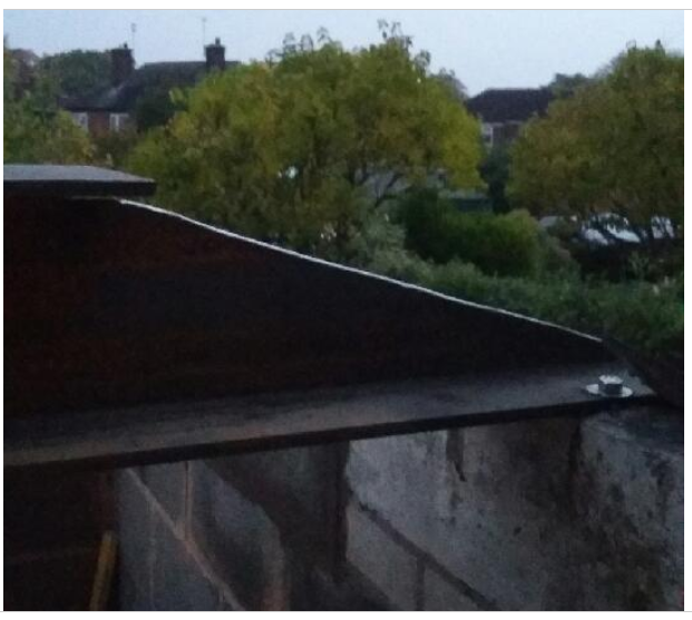

Hey guys, if you think you can't chamfer a beam at the bearing, see this :eek:
It's a 203x203x47, supporting a 9" rear wall (to the left of the camera) onto a new side wall of a wrap-round, and with no pier.
I detailed it to be chamfered a little so that it would clear the rafters, but the builder clearly had different ideas!
It may not be by the book, but it works!!!!!!
I take it you've checked the moment capacity against bending moment and shear capacity against shear at points along the chamfered section?:rolleyes:
Yes, and as a matter of fact, it works.
But to be on the safe side, I got them to weld plates each side.
They also welded the flange back on top, though not sure that would do much for shear?
(Don't know why they bolted it down either - doubt that would serve any useful purpose).
