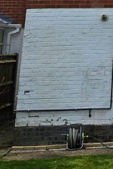

Hi there,
I am in the process of purchasing a property and have just started to consider the fact the lower half of the external brickwork has been painted white.
As you can see from these pictures there is definitely some peeling going on. My main concern is damp and bricks failing from water ingress, and the expense of removing the old paint, re-pointing and then repainting.
Any advice on whether this is a potential deal breaker would be most appreciated!
Thanks in advance!

In today's desperate need for owning a house its a nothing.
The paint can usually be removed with a bit of tedious work.

If they're all painted then it shouldn't be a deal-breaker.
I'd wonder about one where it was the only painted one - what was it hiding? But in your case this isn't an issue.
It doesn't take long to knock the loose off and slap some more on. I wouldn't strip it, it will never look right and it will then be the odd one out.

In terms of stripping it, it would be with a view to repaint it with breathable masonry paint and repoint the brickwork if needed. But the more I look into it the more it seems this would be a huge cost!
Thanks again for your thoughts
I had one that was half-peeling. I just knocked the loose off and put a couple of gobby coats of textured paint over. It looked pretty passable, and stayed stuck together for the years we still lived there.

Is the house cavity wall or solid construction?
Peeling paint is not a particular indicator of damp ingress
Bricks are generally porous, so paint tends to peel off.
There’s no visible decay to the pointing nor is there any particular evidence of cracks

It's cavity wall if that helps?
