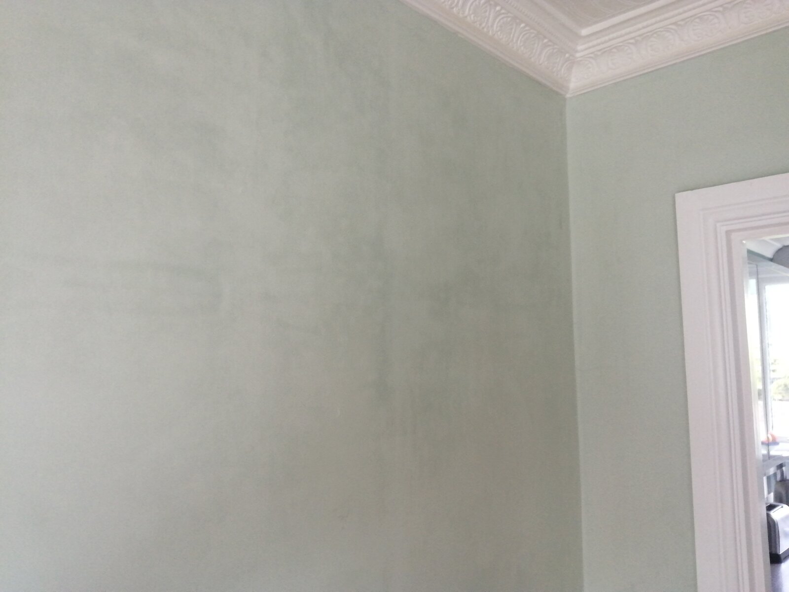

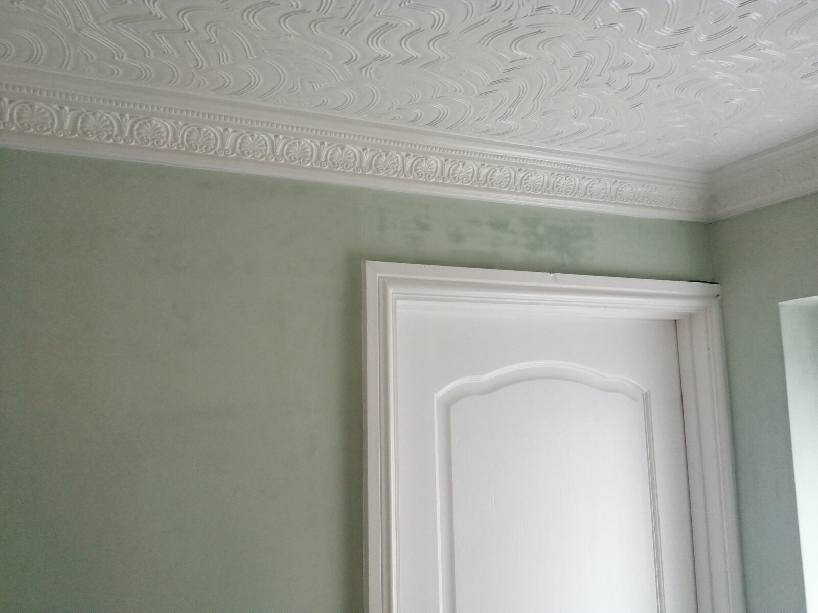

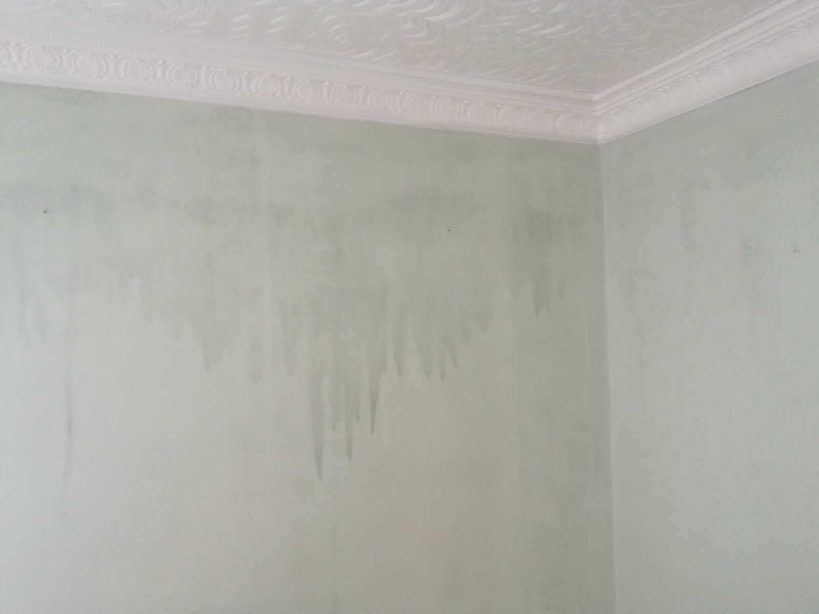

Hi all ,
I hope someone can assist with the following issue I have.
I am wanting to perform a quick tidy/spruce up of my staircase ( I am planning to remodel the bathroom in the near future, so do not want to strip and re-wallpaper at the moment ).
The stairs have been previously emulsion painted over the vinyl wallpaper covering, but it appears as if the paint has sucked in humidity from the adjacent bathroom (this area is at the top of the stairs).
There is staining , but I am hopping to be able to seal this in with Bin 123 water based primer or would I be better with the shellac primer.
Does anyone have any ideas or suggestions of how I can make good this staining so that it doesn ot bleed/come through.
I have a dehumidifier stationed at the top of the stairs for the wintertime.
This is the external wall and I have checked that there is no issue outside , I believe it is the humid air condensing onto the cooler wall during the colder months.
Any advice very gratefully received.
Many thanks Glenn

Zinsser Bulls eye 123 would be the one to use (two coats), BIN is solvent based not suitable for an area that big, (you will be seeing pink elephants putting that much on in a confined area!);)

Hi all, just to give an update on how I got on with my painting issue.
I used the shellec bin primer on the stains. It has covered the stains. The only issue wS that when the emulsion was applied it obviously dried different to the untreated areas and could be seen when the wall was viewed from the side.
It took an extra coat of emulsion to rectify the issue.
