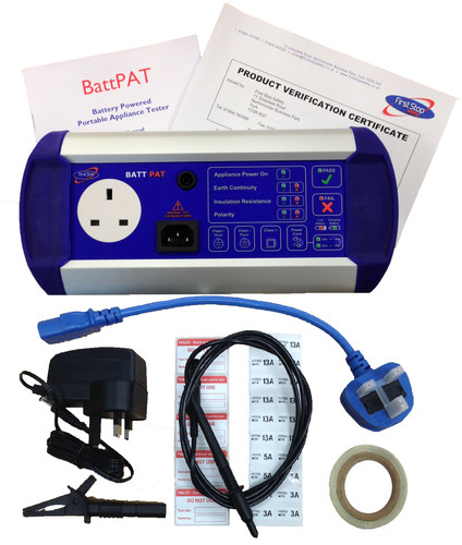

I need to test a small number of domestic applicances.
I am taking an Online course to become competent.
In the past I have paid my electrician to do this, but when I have witnessed him do it, he has just used his normal test equipment, I presume one does not need specific test equipment just designed to do PAT testing, to perform the test.
I remember he hand wrote out stickers, and provided me with a what looked like a spreadsheet of the tests, it didn't appear to be any prescribed Certificate ... is that correct that there isn't a specific certificate, just a sort of log that shows the tests results.
is what I use
I took a quick look at a random Kewtech PAT testing log book (on the interweb), and it requires test values, the above kit is either PASS or FAIL from what I can see, there are no values to enter.
The more expensive testers I presume - in the hands of more knowledgeable people, help judge the condition of equipment better ? or something along those lines. I guess if say a hoover or washing machine fails, it fails the test, but to fix you run round it with a meter to try identify the problem, if its a cable thats suspcted you put an Insulation tester on it.
I have a number of extension leads, for both 240v and 110v, in various states of condition, and various lengths, some quite long, wonder how the BattPAT copes with that.
I see the above kit comes with lifetime Calibration.

The main 'tests' performed when PATting are the visual inspection, and additionally for class I appliances, an earth bond test and an insulation test.
I have extensively used Seaward Europa Plus and Apollo testers.
These testers record the results and I upload them to a database.
If I have for example, an appliance that has failed an insulation test, I can compare the result to previous results and see if there has been a gradual deterioration. If there is a problem I can flag up similar appliances and look into their test records.
If there is a recurrent problem, I can adjust the testing frequency in my risk assessment, to keep on top of these failures.
These machines also allow additional tests, such as checking the polarity of extension and IEC leads and can perform a safe power-on test for earth leakage.
All very useful, when you have thousands of appliances to look after! :)

If you really do have only a few appliances to test, then a simple Pass/Fail tester may be perfect for your needs.
How many appliances do you need to test?
Are they mostly class I or class II?
I use the Kewtech app to manually record the results, this can then give me a PDF of the results or I can export them and bring them into a spreadsheet so I can keep historical records (A database would be better but spreadsheet is all I can use).

Again, the good thing about expensive testers - I have the flexibility of entering a customisable lead length allowance to my earth bond tests, which takes into account the cable length and conductor cross section area.
From the manual, the BattPAT, does have a long lead button - not customisable, but it should help.
Just to note, the BattPAT has a Class II test button, to test insulation on double insulated appliances.

Then something similar to the BattPAT will probably be suitable.
Just to emphasise that the tester itself isn't the most important part of the process - If you have a quick look around your own home, you will probably be surprised by how many appliances are double insulated.
Also, the vast majority of fails are picked up by the visual inspection. You often get fails on earth bond tests, but that might just need you to place the probe in a slightly different place (or require some judicious use of Scotchbrite!), but it is actually quite rare for a tester to pick up a complete failure of an appliance!

The BattPAT suggested above has a single earth bond test current of 150mA - this will be good enough for most items, and be safe for IT equipment testing, but might struggle to give reliable tests to long extension reels. It also won't burn out any dodgy connections that a 25A test might do.

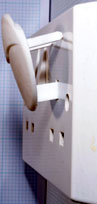

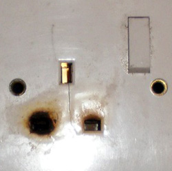

I would not include tenants equipment, unless asked, it is the same with the silly lumps of plastic which one finds shoved into sockets, 1676365063184.png unless marked BS 1363 it should not be plugged into a socket, and I have never found those silly plastic things with BS 1363 marked on them, but they are not yours so you can't bin them, and they are not electrical so are not tested. However they can damage sockets 1676365293550.png as to if you can charge tenants to swap all sockets which you find with them in, that is also likely to cause problems.
