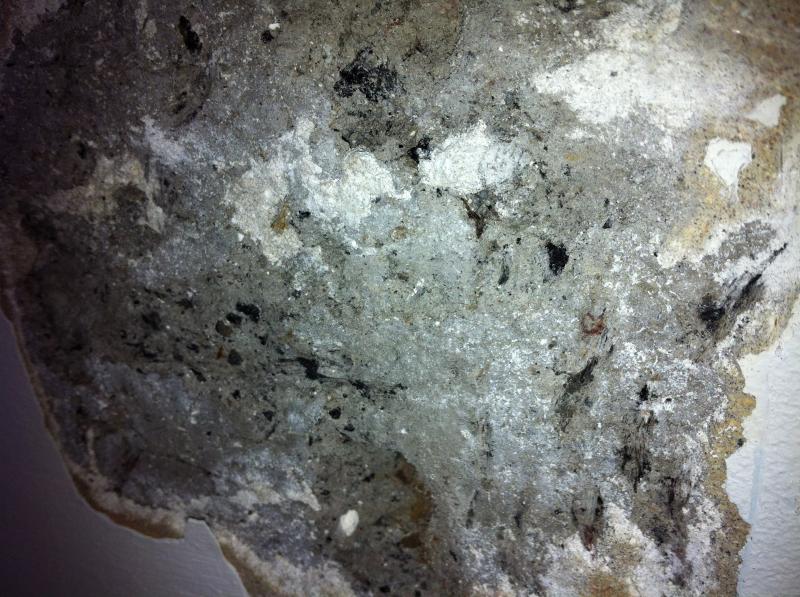

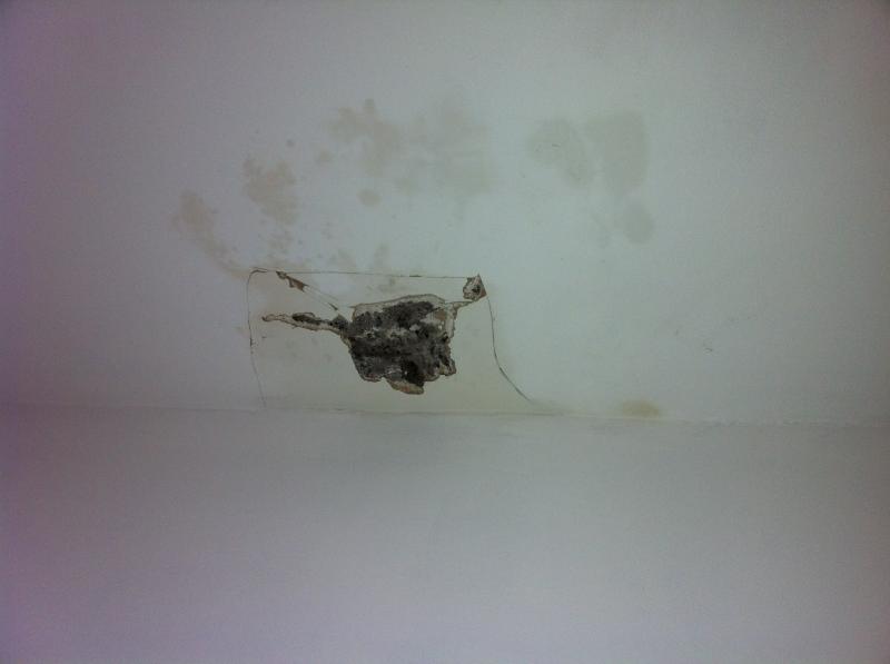

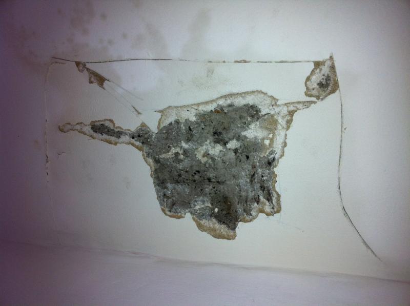

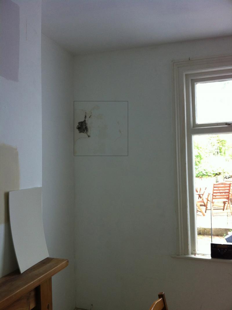

After removing some horrible shelves in an alcove in preparation to re-paint and spruce up my dining room I've discovered a patch of plaster that sounds very hollow when knocked (the wall around it sounds fine). After painting it white in preparation i noticed a darker patch was showing through so new that further investigation was needed. I cut out a little section to investigate what was underneath, the top layer came off very easily and underneath looks like a sort of cement which is also crumbly (see attached photos).
I was wondering if anyone could identify what this is and the best way to go about fixing it? The total hollow sounding patch i about 30 x 45 cm. Please note that the images are displayed horizontally when they should be vertical.

It just looks like an ordinary cement or thermalite block wall Pete, with plaster layers on top as per the norm......occasionally the plaster does 'blow' away from the substrate beneath.
The likes of B&Q etc do ready mixed patching plaster in tubs, which will happily fill that (but not necessarily in one go).

It looks to me more like lime plaster, which fits the age of the house. You should hack off the loose and repair with lime, not modern gypsum plaster. You may find it easier to use as it does not set so fast. When you have hacked it off, look for any cause such as cracked brickwork, nails or screws driven in, or water ingress, and fix the cause.
Lime plaster is usually quite thick, an inch or so, and greyish-white, not pink or smooth grey. That's why I asked the age of the wall.

putting nails, screws or bolts in, or pulling them out, might have started a crack, and the steel might have expanded as it rusted over the last hundred years.

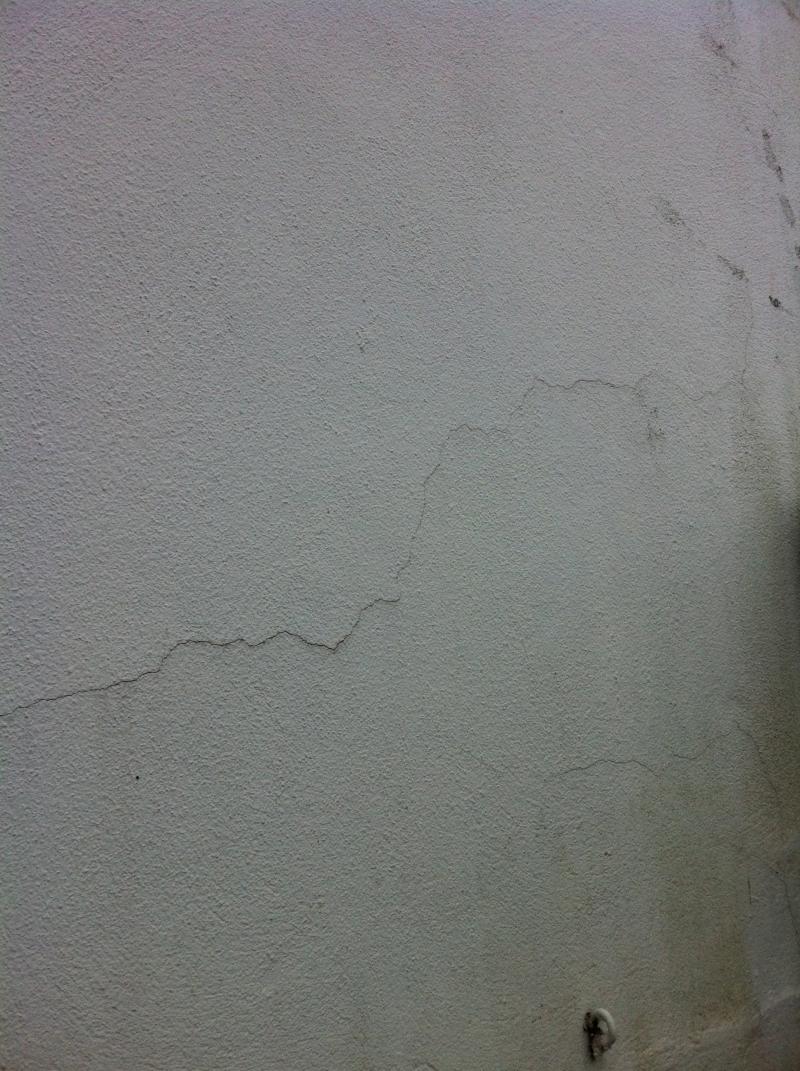

The first thing I did was check the gutters and drain pipes and all seem clear and in good working condition. There actually is a small crack in the render on the outside wall but nowhere near the corner where the patch is. It's strange as I have no other damp issues in the whole house and then this patch suddenly appears.
I think it must be related to taking the bolts out as it wasn't apparent before then. Now i just have to work out how sort this 'damp issue', maybe filling the bolt holes with something better than polyfilla. If not I might need to get a pro in?!?!

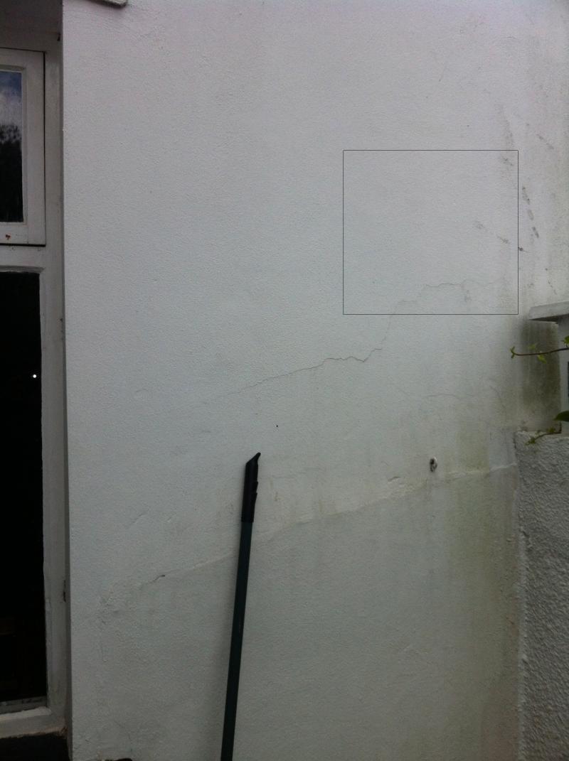

So i've finally had time to have a proper look outside and take some photos. Peaps i think you're right about the render, I can now see there is a thin crack which is in the same area as the patch inside. I've taken some photos and highlighted the area where the patch is to try and help.
I think this means i'll need to get the crack sorted before doing anything inside? is there something i can do to fill the crack outside or is this a job for a pro?

hack it off and have a go with lime render, do it yourself. if you are going to have a go let me know and i will go through it with you step by step
