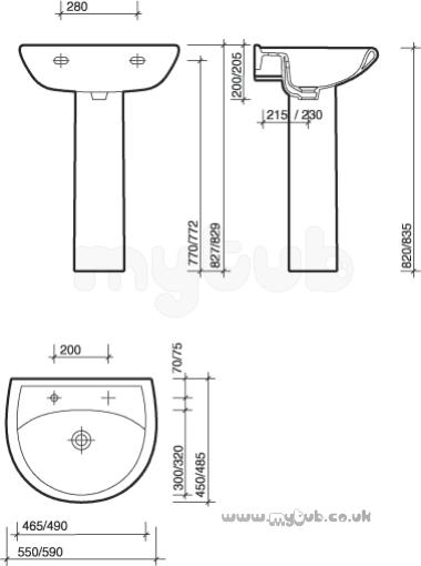

Bit of a longshot.
Looking to purchase a View Total Install 590mm Basin ( with full pedestal).
Was wondering if anyone here has one of these installed that could give me an idea of the wall to pedestal clearance at the base.
I need a minimum clearance of 150mm because the wc waste will run behind it and the waste is fixed approx 35-40mm away from the wall.
Alternatively does anyone know of a pedestal basin that offers the minimum required clearance. (budget £100 - 130)
Many thanks
Marev,
Please see below technical drawing of your chosen basin.
You should be able to work out the clearance, but I think it will be a bit tight.
Rico
Thanks for the reply.
Yeah i have seen those dimensions.
The 230mm measurement line to the center of the plughole doesn't appear to start exactly from the rear of the basin so was wondering if that slight difference would give me a bit more extra clearance.
