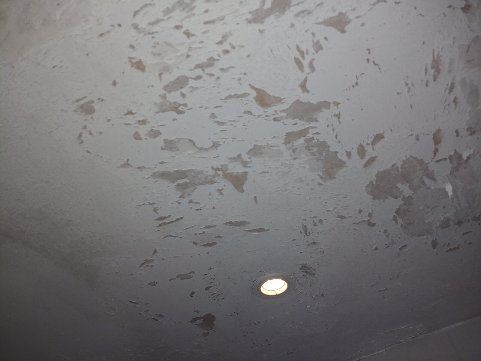

Hi there!
I've recently managed to strip the majority of paint from a flaking and peeling bathroom ceiling that contained 2-3 paint layers in some areas. After stripping away the paint, I can see that the previous ‘painter’ painted over mould in some areas, however filler was added in areas to ensure that the ceiling was smooth.
As you can see, I’ve managed to scrape off most of the paint back, which I understand was a mistake.
32YueWL
My process
  • Washed the walls down with HG Mould Spray and rinsed with cold water. This was around 2 months ago.
  • Scraped the loose bits of paint, until I could scrape no more.
  • Sanded the entire area with 120 grit sandpaper using a sand pole.
  • Vacuumed and wiped away the remaining dust.
  • Cracks in the plaster are ‘primed with a 1:4 of PVA/ Water mix.
  • Wait until dry.
  • Apply a thin coat of joint/ compound Toupret TX110 to the cracks in the plaster
  • Wait until dry
  • Add another thin layer of joint/ compound, so the repaired area is practically level with the surrounding area.
  • Wait until dry
  • Sand the entire ceiling with a light sand with 120 grit sandpaper.
  • Prime the whole ceiling with with Zinsser Bulls Eye 123 sealer primer.
  • Apply 2 coats of Dulux Bathroom Easy Care Bathroom , using a roller with a microfibre medium nap.
My two questions are:
  1. Is my approach suitable?
    I’ve been made well aware that painting is effectively 80% preparation and 20% painting. I really want to get this right the first time. FWIW, I’ve never painted a wall or ceiling in my life.
  2. What’s the best option for applying the Zinsser Bulls Eye 123?
    I’ve got a couple of 4 inch foam rollers, a 4” microfibre sleeve with a short nap and two 9” microfibre sleeves with a medium nap and a couple of high quality brushes. I’ve heard that brushes and sleeves are potentially a one time deal with this primer.
  3. Do I need to water down the Zinsser 123, to ensure that it's absorbed by the plaster/ substrate?
    I'm assuming that I don't need to do this, as this only applies to new plaster, but just want to be sure.
Ideally, I know that it would be best to get the entire ceiling skimmed. However, money is tight at the moment and I’m currently time rich. Thanks COVID-19.
I’ll look into upgrading the extractor fan and I’m now opening the bathroom window regularly after each shower, to alleviate moisture build up, which should reduce condensation and mould build up in the future.
Many thanks.

primed with either a PVA Water mix
Please don't ever put glue on a surface you hope one day to paint.
PVA is water soluble. So when you put water-based paint on it, it turns to sludge and prevents the paint sticking to the plaster.
In a bathroom, it softens from the steam and condensation, and bubbles or peels depending on your luck.
The correct treatment for bare plaster, before emulsioning, is to give one or two mist coats of emulsion thinned 10%-20% with water. This will soak into the plaster and when dried, the paint will stick to it. You will know when you have mist-coated enough, because the plaster will no longer suck the moisture out of your brush.
The fan you show has an extract rate around 80 cu.metres pr hour. This is adequate for a WC or a bathroom with infrequent baths, but insufficient for a steamy shower. I presume the duct behind it is 100mm diameter.
It can be adjusted to (I think) a max of 30 minutes overrun on the timer, which will make a big improvement because it will continue sucking water vapour out after you have left. The adjuster screw will be seen if you TURN OFF THE POWER AT THE CONSUMER UNIT (not the light switch) and remove the outer cover. It looks like a modern quiet model, possibly with a ball-bearing motor, so you can consider leaving it on permanently. It will run for about 120 hours on 14pence worth of electricity. The fan will be more effective if the door and window are closed.
Check the loft insulation above the ceiling. If it is thin or gappy the ceiling will be cold in winter and this will promote condensation.

I understand that a mist coat if required for new plaster. However, is this a necessary process for a ceiling that has been stripped and sanded down to the bare plaster?
yes, because it's bare plaster. It is the bareness, not the newness, that requires sealing.

Edit: This is a picture that I took in Jan-2020 of the bathroom ceiling before I stripped the paint away
