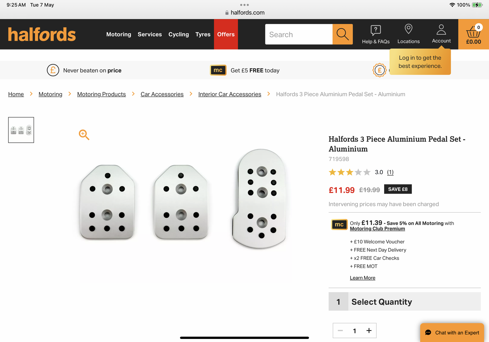

You don't actually need rubbers. Try these:

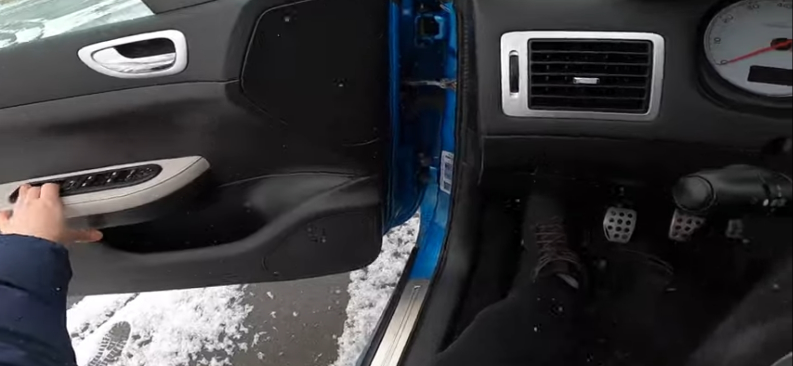

Well the car is designed to be a bit sporty and the pedals have holes in them.
I did have another of the same model and neither of them came to me with rubbers!
But how could I get a manufacturers statement that they are not designed to have rubbers?

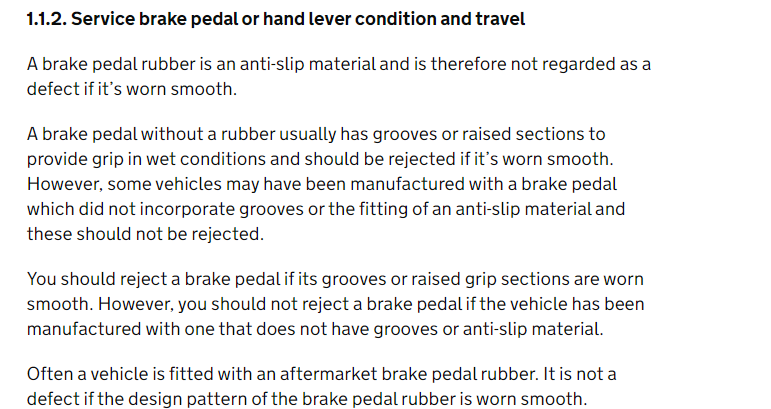

The advice in the MOT inspection manual seems to give you quite a lot of leeway:
Thanks for that.
Seems as if I should take a copy to Hassan in case he is worried about it.
Yes thanks, those look just like my feet.
Those cars mostly seem to have sold to women.
Mine has a 2 litre engine and can accellerate quite nicely if I need to get away from anything.
