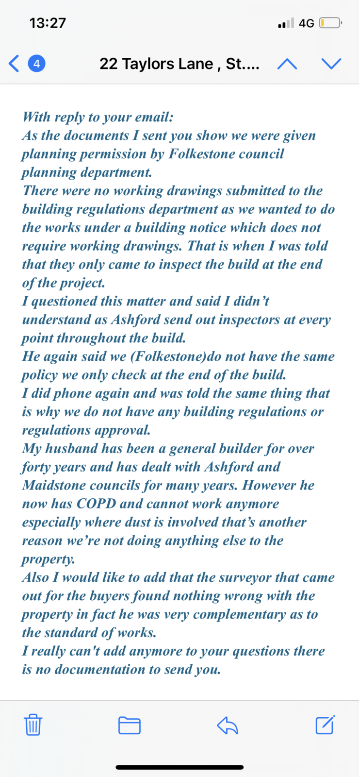

A little update.
I won’t lie I am now completely confused and have no idea what to do next.
Can anyone shed any light or give any advice with what I can go back with?
Appreciate any help.

I have never heard of or known building inspectors only inspect a building on completion - with no interim inspections. In fact, scrap that because it is bullsh1t. Nobody can make a judgement on the quality of a building by looking solely at the finished project and I don't believe for one second that that it is the policy of any local authority building control. Contact the local authority and ask them direct?
I'll save you the time. Quick look on Folkestone building control says under building notices " A fee is usually payable for site inspections, being a single payment which covers all the necessary site visits until satisfactory completion of the work in accordance with the Building Regulations.".
This is really a sellers problem, because with a half finished not-signed-off project they are going to hit the same problem with most buyers (all who need a mortgage). I think you are going to have to decide how much you want this house. If you really want it you are going to have to find a lender who will cooperate with the actual status - I doubt you will get anywhere quickly trying to get that elusive sign-off from the vendors. Perhaps a "development" type mortgage with a retention until the extension is complete. There will be a mechanism to get the regularisation once you are the owner. It's a mess. However, property does get sold all the time that is not structurally sound, uninhabitable, - you just need to get the right funding structures in place. The sellers are going to have to discount a fair bit to move it quickly or get the certifications sorted.
The building control regime is defined by law, and there are are statutory inspection stages depending on the type of work. The inspection stages occur whether it's a full plans or a notice application.
For an extension, there would be an inspection for the foundation trench (to see if it's deep and wide enough, and the ground condition), then an inspection for floor damproofing and insulation, the oversite concrete/floor, and DPC and drainage. Then other inspections for the main structure.
It is possible for a builder to take pictures of the stages if the inspector agrees, or several things can be inspected in a later single inspection - as long as those things are left open an visible. But either way the things need to be seen and recorded as being satisfactory.
The builder would know this, so it hinges on whether the statement is genuine and that was what they were told, or if it's been made up to hide something.
Have you or your advisor made contact with the council directly regarding the work? Has the application file been checked? You should have done that by now, and you should now also ask the council's building control team if the vendor's statement is correct, or was correct at the time.
