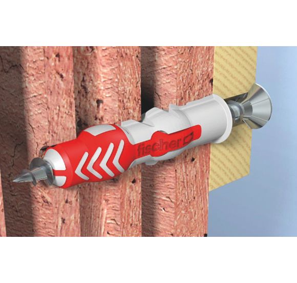

If the plugs you are referring to are Fischer DuoPower plugs:
then they will do the job, even if the wall material is a bit soft or crumbly. I'd still go for the longer screws, 70mm or 2-3/4 to 3in, because they t3nd to wedge themselves in better than shorter screws to resist pull-out
A note about concrete types: if the concrete you are drilling into is heavy structural grade or is of "no fines" type (a lot or large stones in the aggregate with minimal sand or small stone), you will need an SDS drill to make your holes because those types of concrete are so hard

I think the DuoPower plugs will be fine.

So my set says 8-12 so I guess I'm good with these? I don't get how they can say 8-12, isn't a hole only one size?
It seems Fischer makes them but the ones available here in Canada make no reference to Fischer.
The hole in the masonry is one size - but the nylon plug is compressible to an extent, and wood screws can cut their own thread as they enter. TBH I"d avoid the smaller (#8) screws
