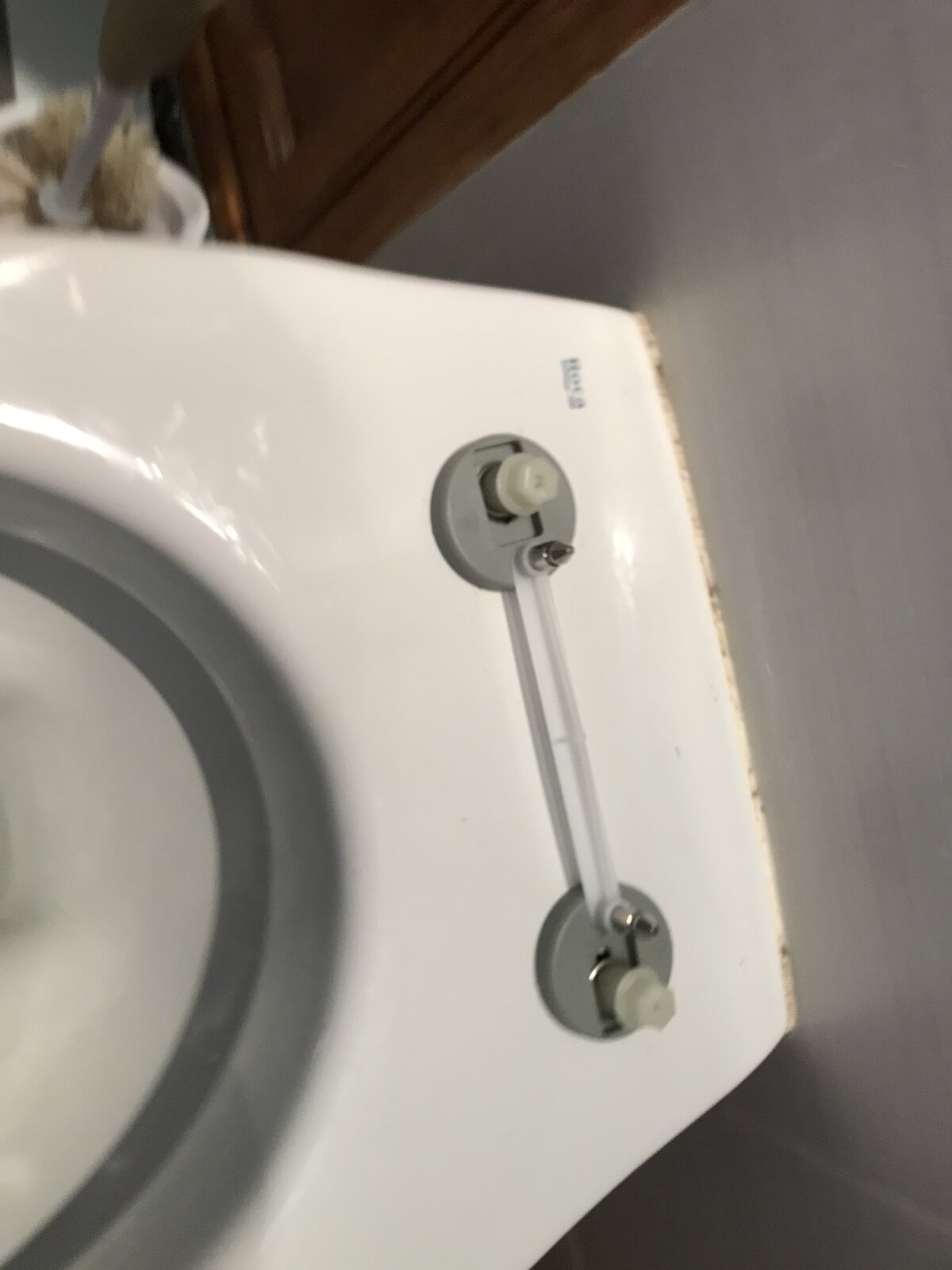

Hi
Need to replace toilet seat. One of the fixing wing nuts loosens easily, but other one (pictured) can’t shift with spanner pliers.
What would you suggest?
Which way would but turn? (Towards or away from toilet?)
Many thanks.
Well it starts turning away from the pan but then turns toward the pan :ROFLMAO:
Undo by turning clockwise (that`s looking up from floor level)
Or practice with an empty bottle. (y)

Nut is stuck and impossible to move with hand pressure. It’s also stuck in the worst possible position, so when you get pliers around it, the enamel of the toilet prevents you turning it.

4-inch adjustable wrench?
or a Dremel or multicutter
BTW I bought some stainless wingnuts, washers and coachbolts to avoid a recurrence. I think the standard size is M8 x 50mm but measure your old one. As they last for ever just buy a few and use them as and when the seats need changing.
you have to lube the threads of stainless or it can still seize, proper stainless antiseize is a bit expensive but if you have any brake grease, such as ceramic, that will do. Lanolin used to be factory applied in the early days.
I use a lot of stainless in the garden and on vehicles. Coastal location.
Thanks All
Managed to shift it with hammer and screwdriver pointed at end of wing nut
