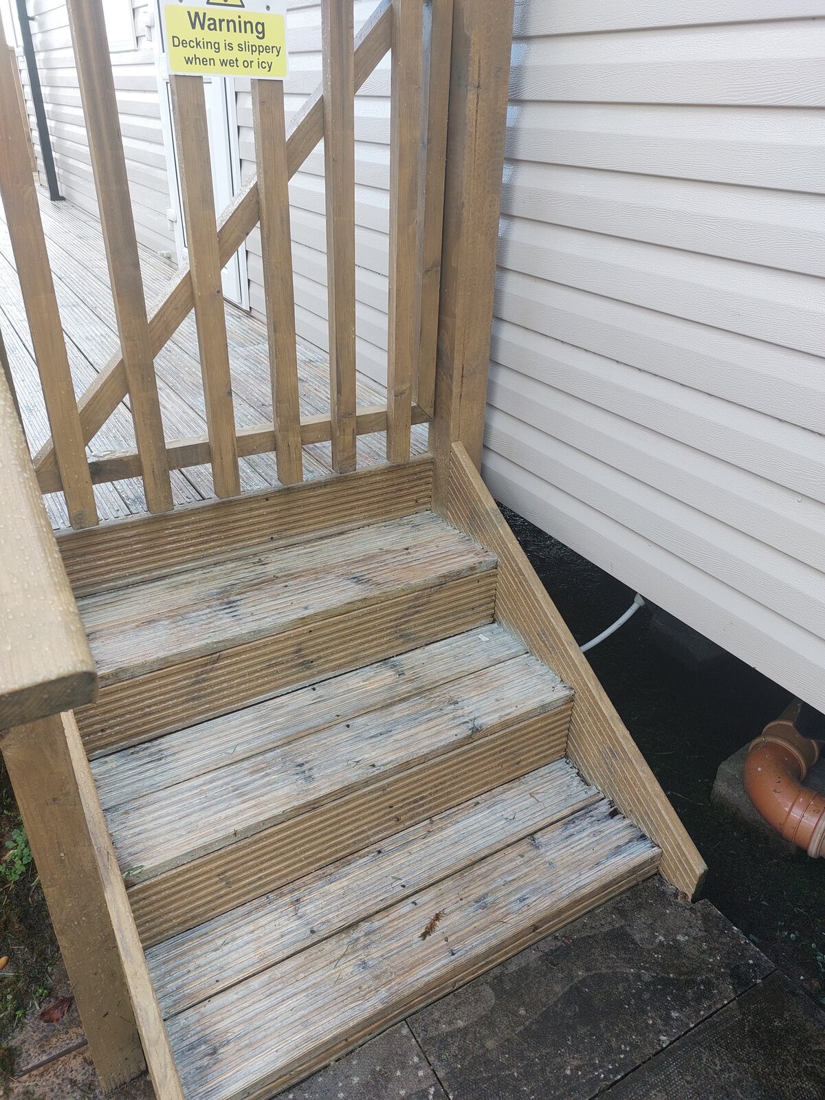

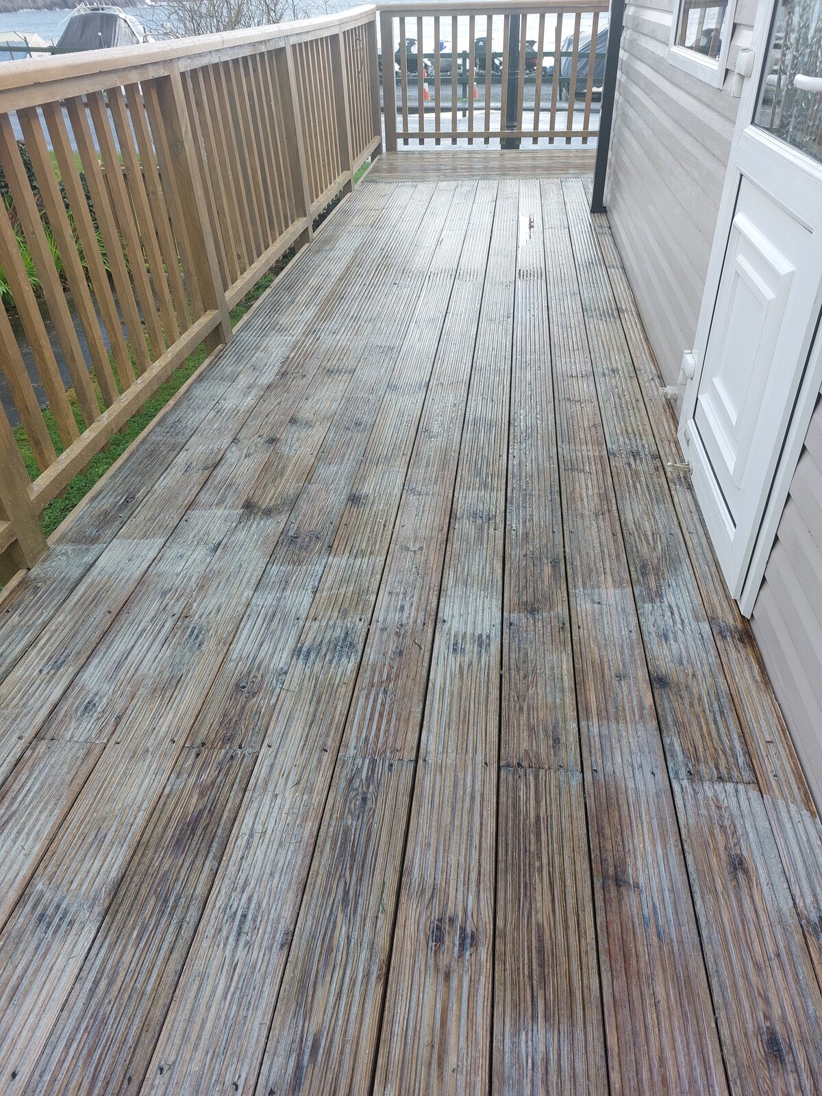

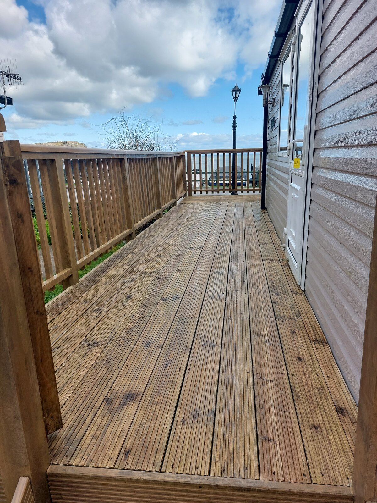

Hi I painted a deck with blackfriars anti slip decking paint.
I've used it before and it was great.
I painted it last week on a dry day but it rained in the evening. I've gone back to it and it's all white. How can I fix it?
I can't sand it back because the wood has ridges. I've attached photos of when it was done and today

Surfactant leaching.
I guess there is water near by?
Wrong time of the year for exterior painting.
When the warmer comes, scorch pad over and give it another coat.
Worth phoning technical for advice though
This is on the paint instructions, we just had the wettest February on record, spend the next couple of months getting it prepared for a drier period to recoat it, did you read the reviews i posted, some people where struggling to remove it.
