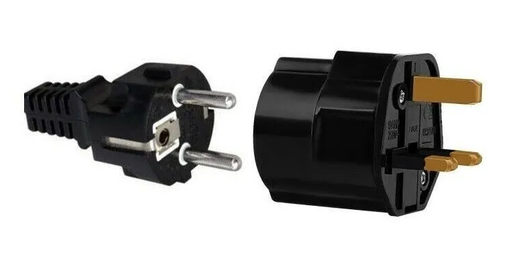

It seems the plug or adaptor needs to be fixed, so these 1711442184853.pngare not permitted, but these

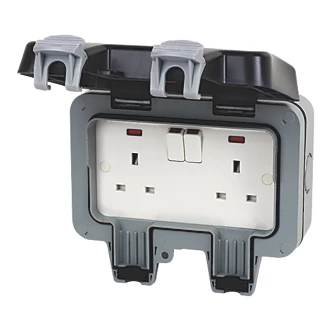

are yet both are as safe as each other. These Adaptors.JPGForeign-Plugs2.JPG all do the same job, but only one is fused, and non grip the plug firmly and most mean one can't close the water resistant lid on outside sockets 1711442615850.pngso there is a need for the proper plug to be fitted. I remember my daughter (in her 40's now) causing a stir at school as she told the teacher she had got it wrong, my dad says you work out fuse size like this. At the time I would fit 1, 2, 3, 5, 7, 10 or 13 amp fuses depending on the power of the equipment, today in the main it is 3 or 13 amp which is more to do with the cable fitted.
And this is the problem, we as electricians know with fixed equipment the manufacturer can stipulate fuse size, but with portable it is either 3 or 13 depending on cable used, to try to teach children what should be done safely is going to be hard. I still use the adaptor on the right which has no fuse, to plug my radio into, it itself is plugged into an extension lead which is fused and is in my bedroom which regulations say no one else should enter and use my equipment with out me being present unless also they have a licence.
The radio came with a USA plug which I don't really want to change. I have not been to a radio rally in years, and the nearest radio shop is likely Bristol or Liverpool about equal distance, so when I do want equipment I use the internet, I can buy radios far cheaper from internet the same applies with a lot of electrical equipment. And often it does come with the wrong plug on it.
To push for correct plug will likely mean customs will open more items, and it is not the customs duty but the Post Office charges for handling items which have been intercepted by customs. £1 customs duty but £12 handling charge. We don't want to return to this

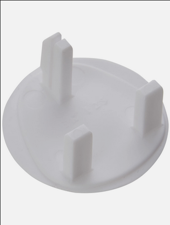

these 1711444112976.png work better than matches to hold the shutters open and connect wires another good reason why they should be banned they are fatally flawed they have been banned from NHS premises, but are still used at my doctors.
