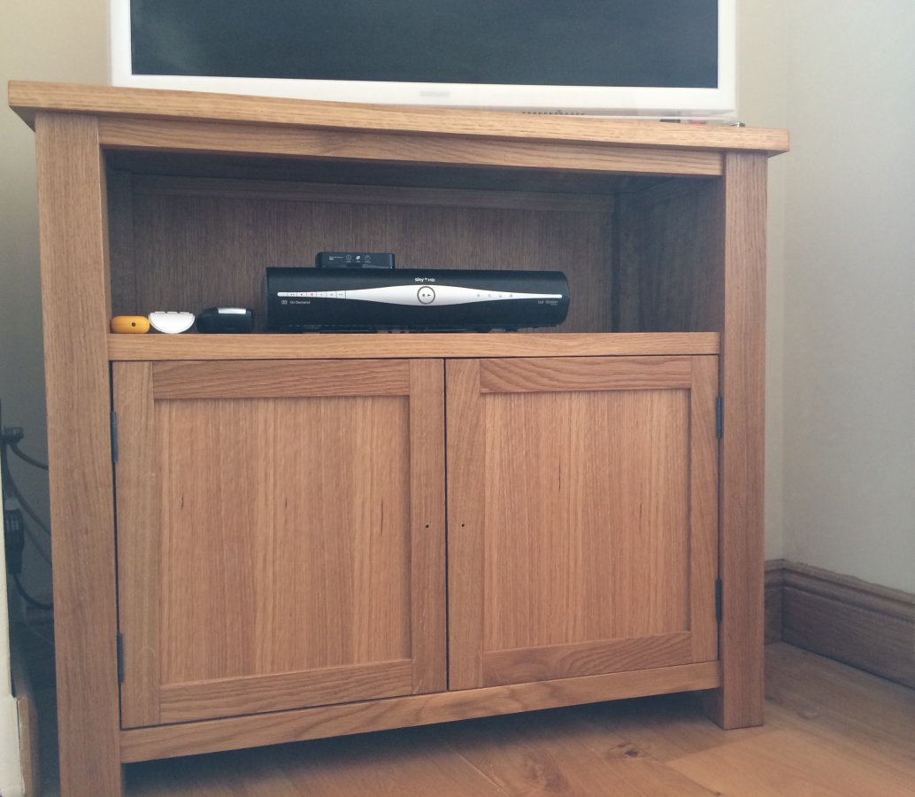

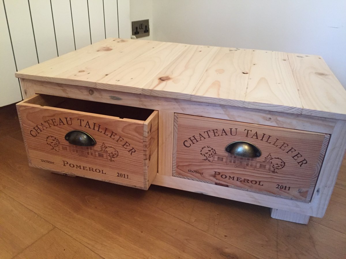

I have the Kreg K4 and K3, the K4 is really good. I have used it for making lots of stuff, I know it's not proper cabinet making but I get a good product at the end
I have made these 2 items as well as lots of other stuff..

Great, I am about to do similar cabinets, that's why I am going to buy a jig.
The only thing is that I find the screws can be quite expensive, I brought a mixed box to start with but find I use more of the longer screws so I have brought individual boxes of them.
I have also made the wooden plugs from normal 9mm dowel. There was a video on You tube, cutting them was a bit of a faff but I made loads for a few quid!!!
