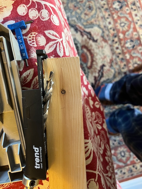

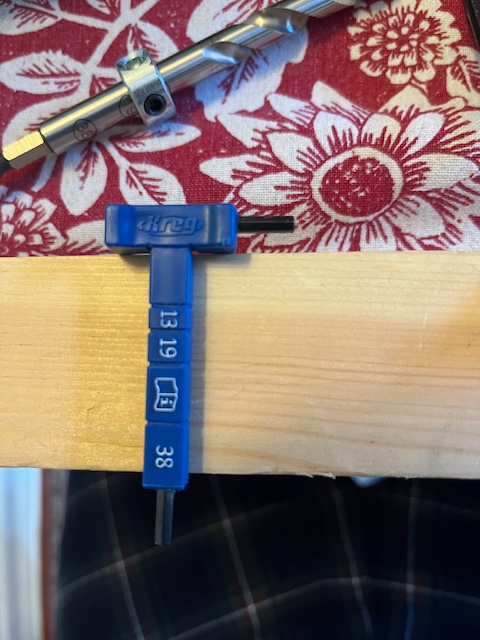

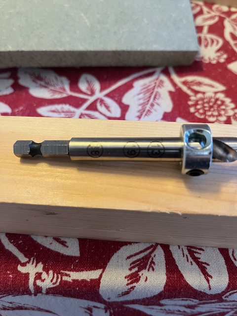

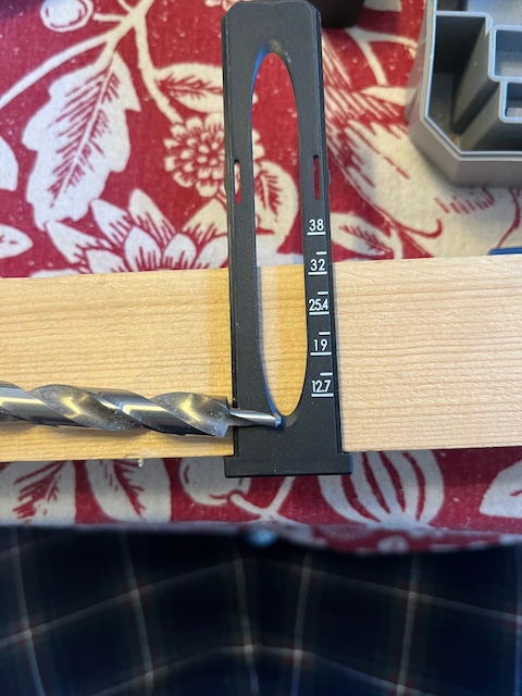

I am attempting to use a pocket hole jig for the first time to put together a workbench in my garage. I'm working with 38mm CLS and picked up this jig from Amazon.

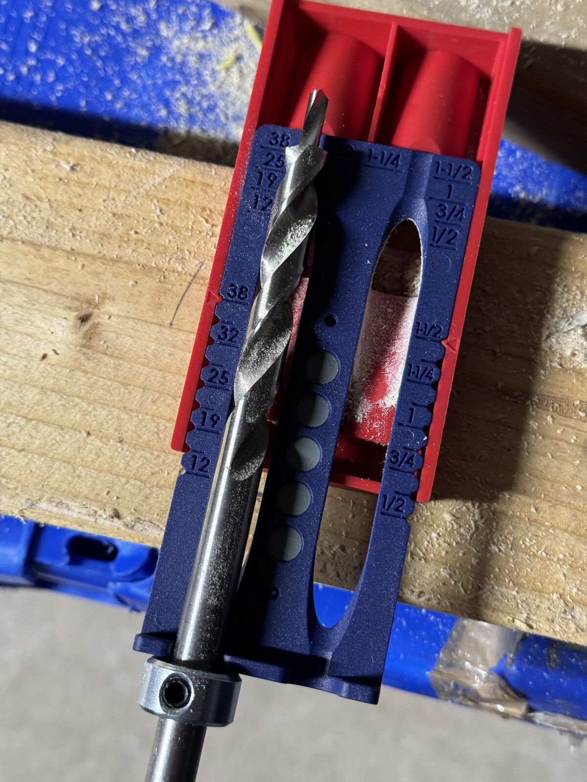

I believe I've followed the instructions, in the first photo below you can see I've positioned the slider to align with the 38mm marking and it also shows I've secured the drill bit collar so that the step on the drill aligns also with the 38mm marking on the depth gauge.

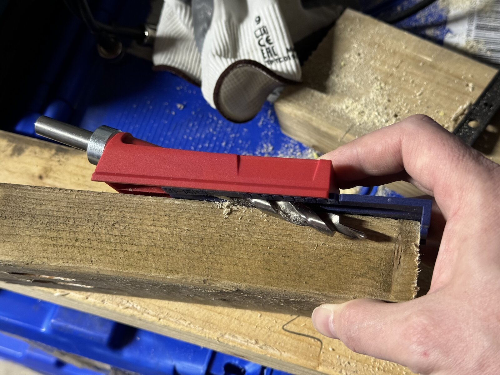

My issue is that the drill bit is stopping about 20mm from the end of the timber. I've tried to capture this in the second photo.
I confess I didn't follow the instructions to begin with, but after reading them this appears to be exactly what they ask you do to. Am I missing something?
Thanks in advance for any advice.

In the second video at 3.38 onwards, after he's set it up for 1.5" (38mm) you can see it's not gone the full depth of the timber.
in order for the tip to just be at the end of the timber - What setting do you have to have the blue bit set to on the notch
I have the blue bit set to the 38mm notch, and also had the step on the drillbit sitting at 38mm when tightening the collar which is what the Amazon and written instructions say.
Perhaps I've wrongly assumed that the drill bit will run to the end of the timber. I'm working with some scraps so I'll see how they attach in it's current setup with the recommended screws.

I meant move the blue bit until the drill tip is at the end of the wood - whats the setting on the blue bit now

If you drill too close to the end of the timber, the screw will pull through.
You might find pocket hole joints on the weak side for a workbench, I would use heavy angle brackets at corners.

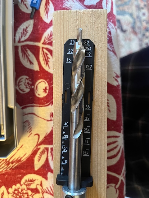

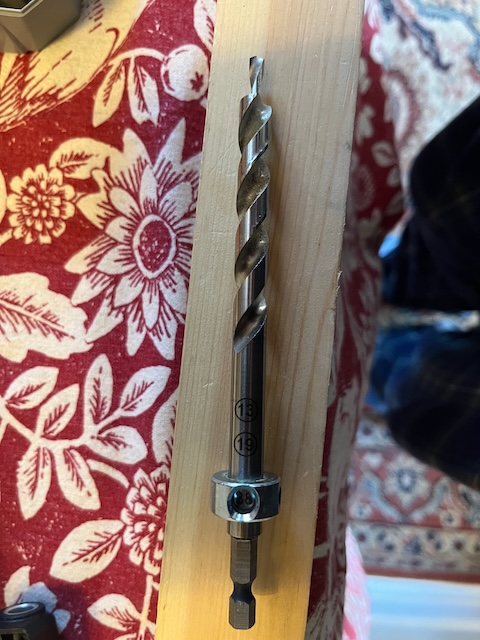

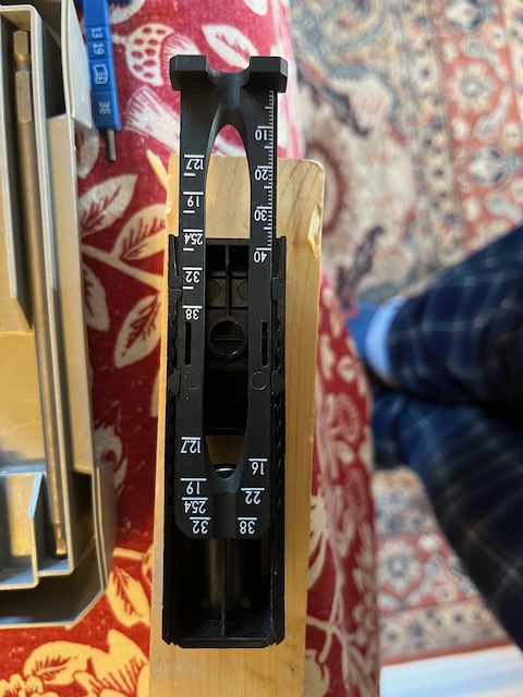

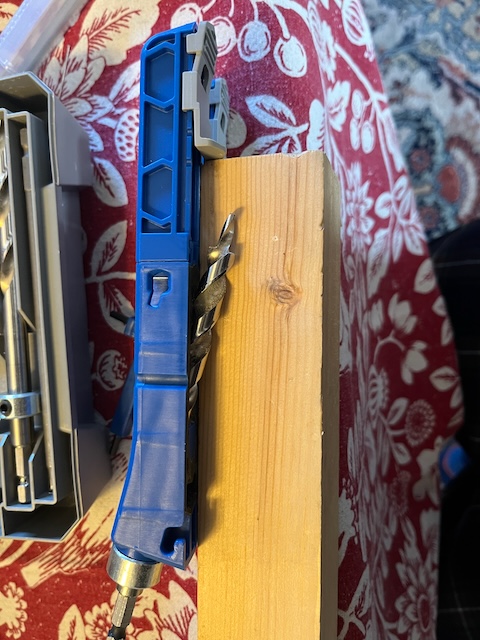

i have pulled out my Kreg and Trend pocket hole jigs and set both up for the 38mm setting and they re the about the same distance from the end of the material as yours is showing
On 18mm its much nearer , which i'm used to using
on the Kreg - it has making actually on the drill where to put the clamp
on the trend works the same as yours pretty much
the head off the washered screw head is the drill size so the only support is whats left for the screw to grip before the point is countersunk to give the thread a clear path to grip the other section so tip just breaks the surface by no more than 1-3mm max
just to show some pictures following the instructions on setting up pocket hole and images
i will do 2 posts one for trend and one for kreg
this is the kreg
