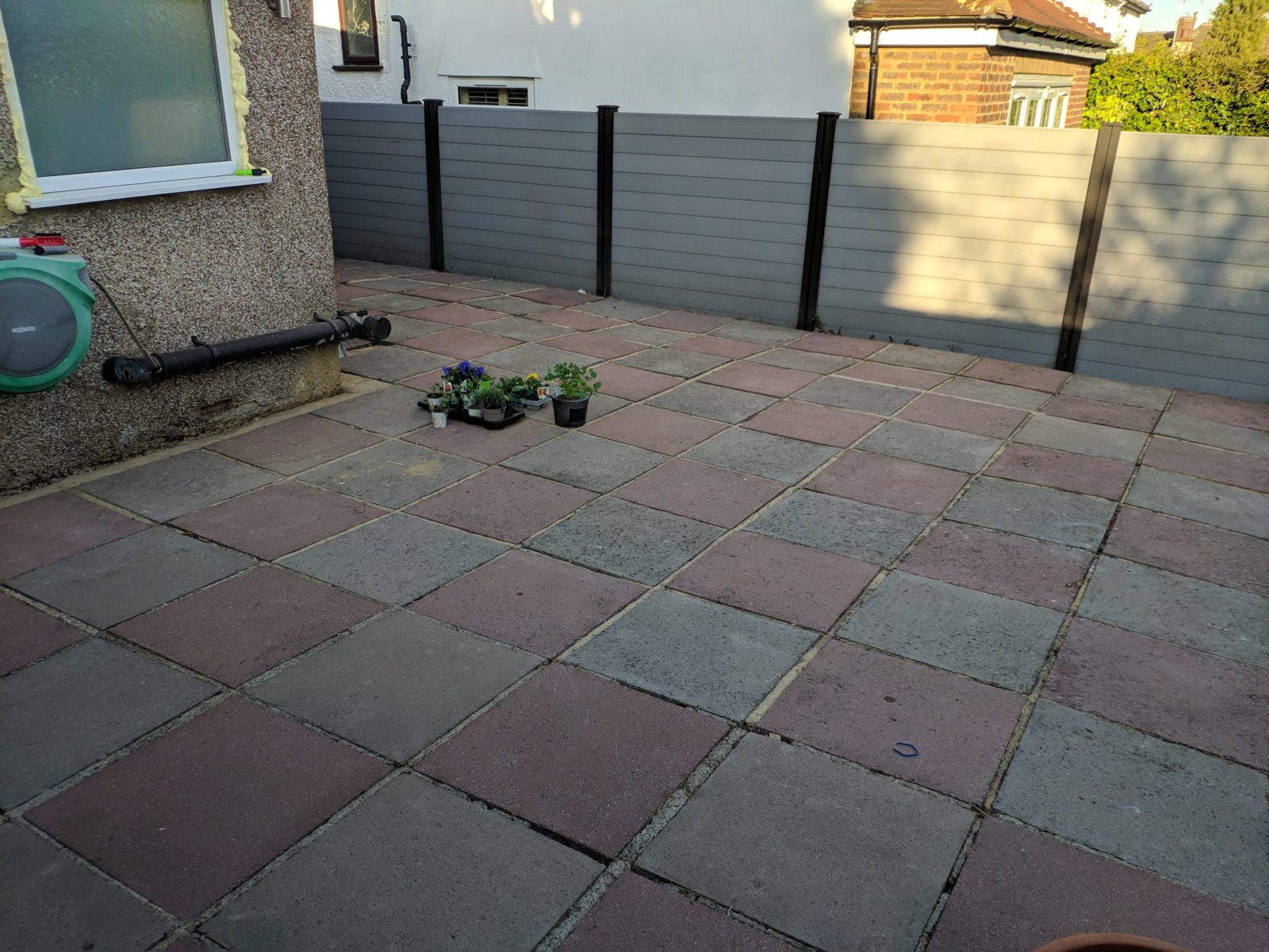

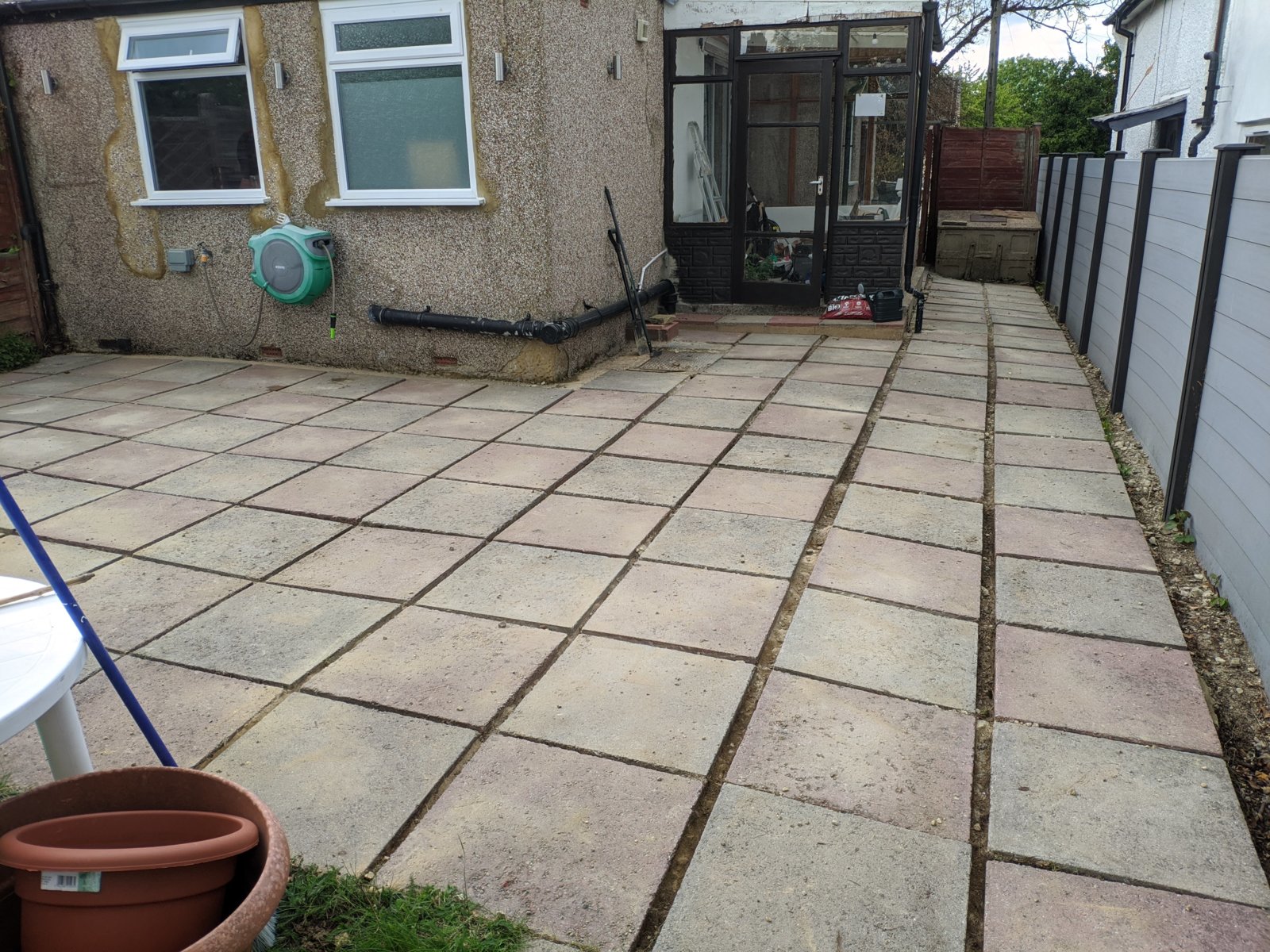

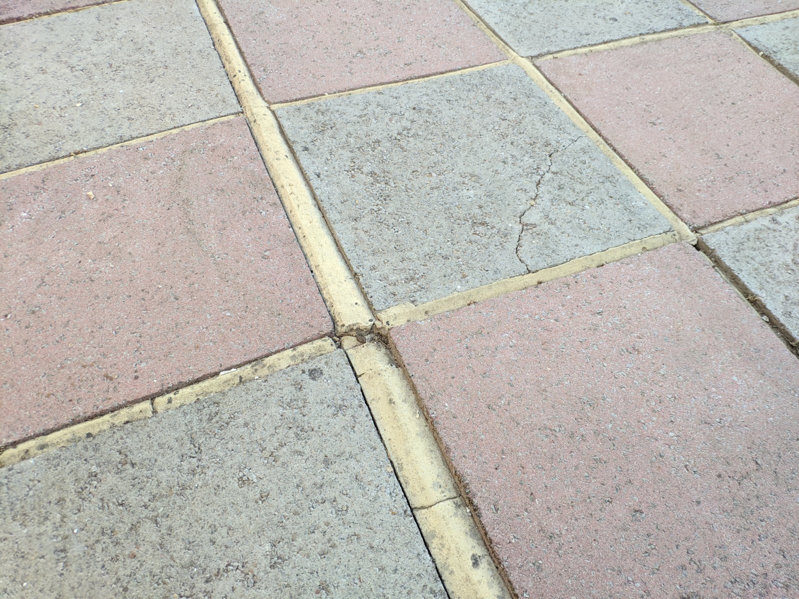

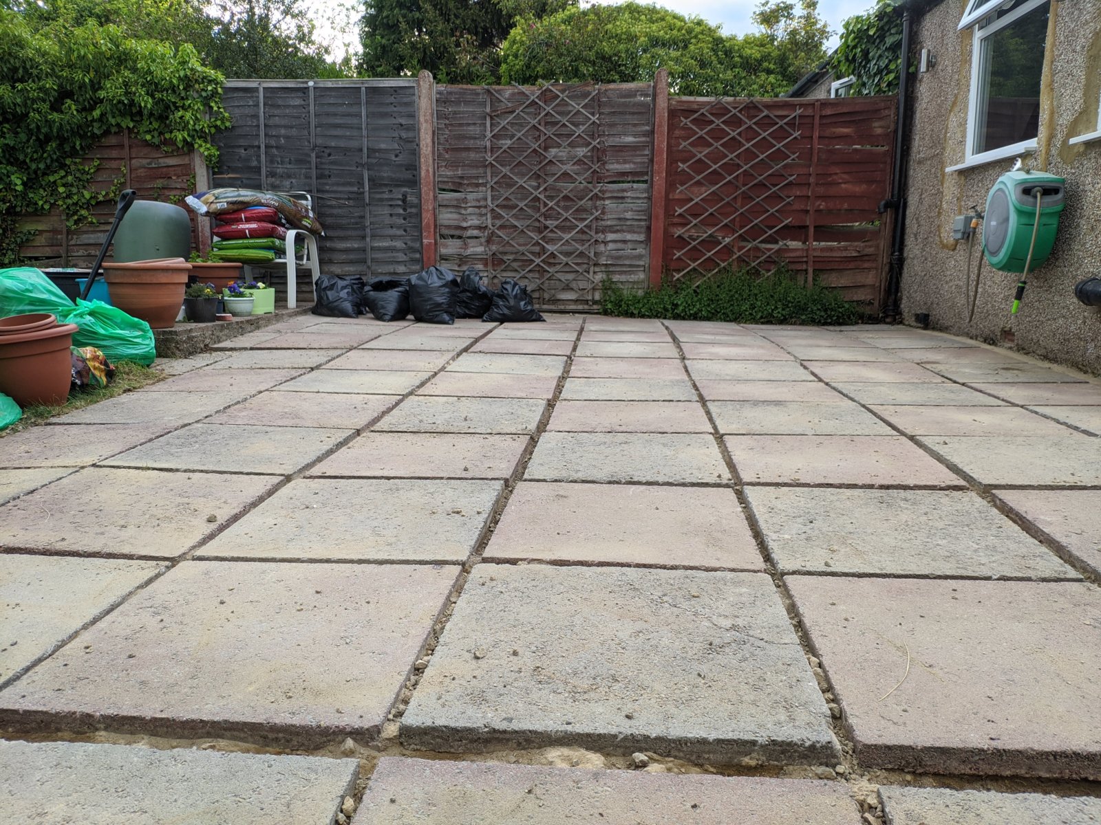

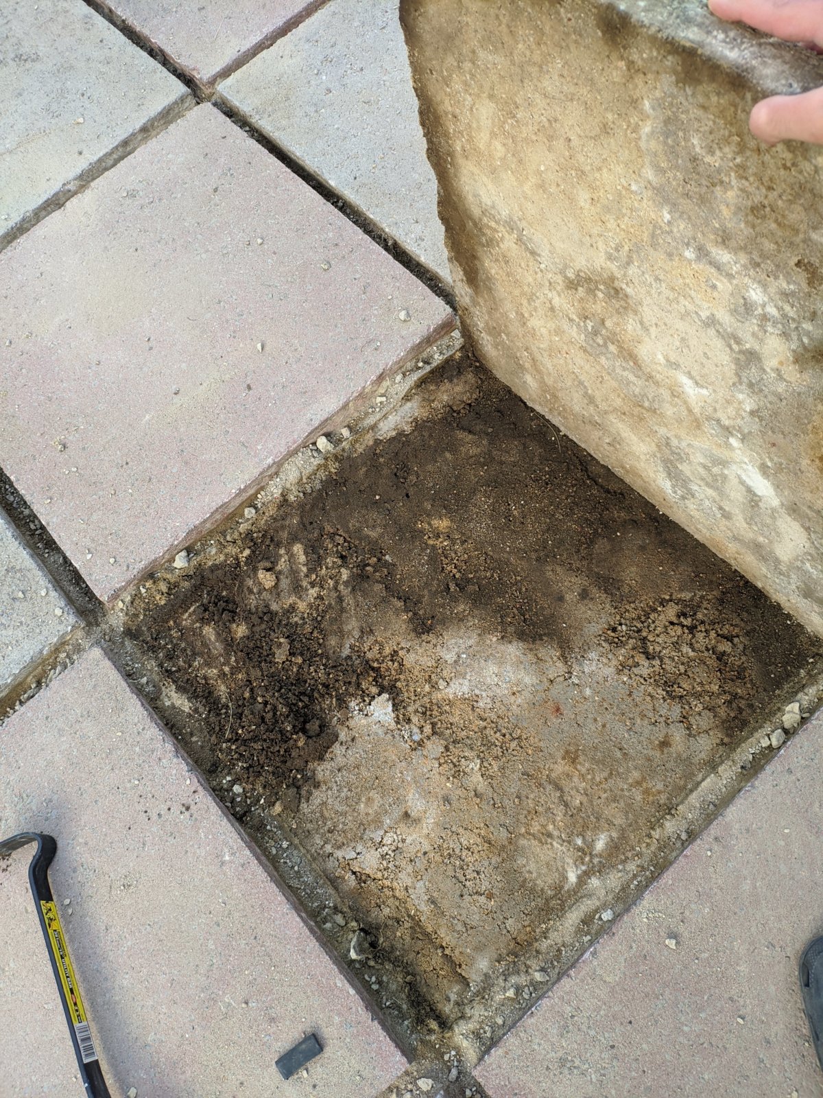

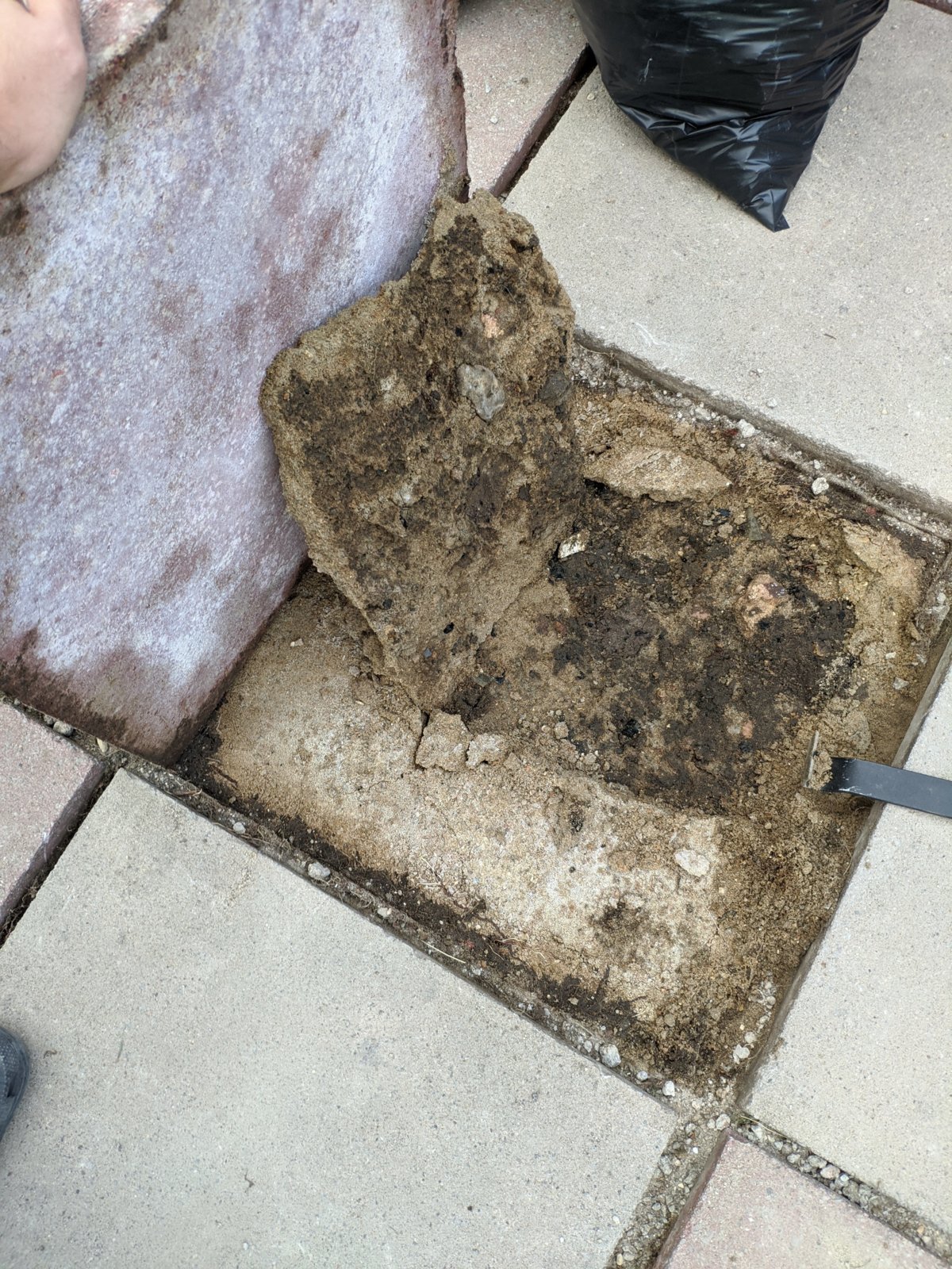

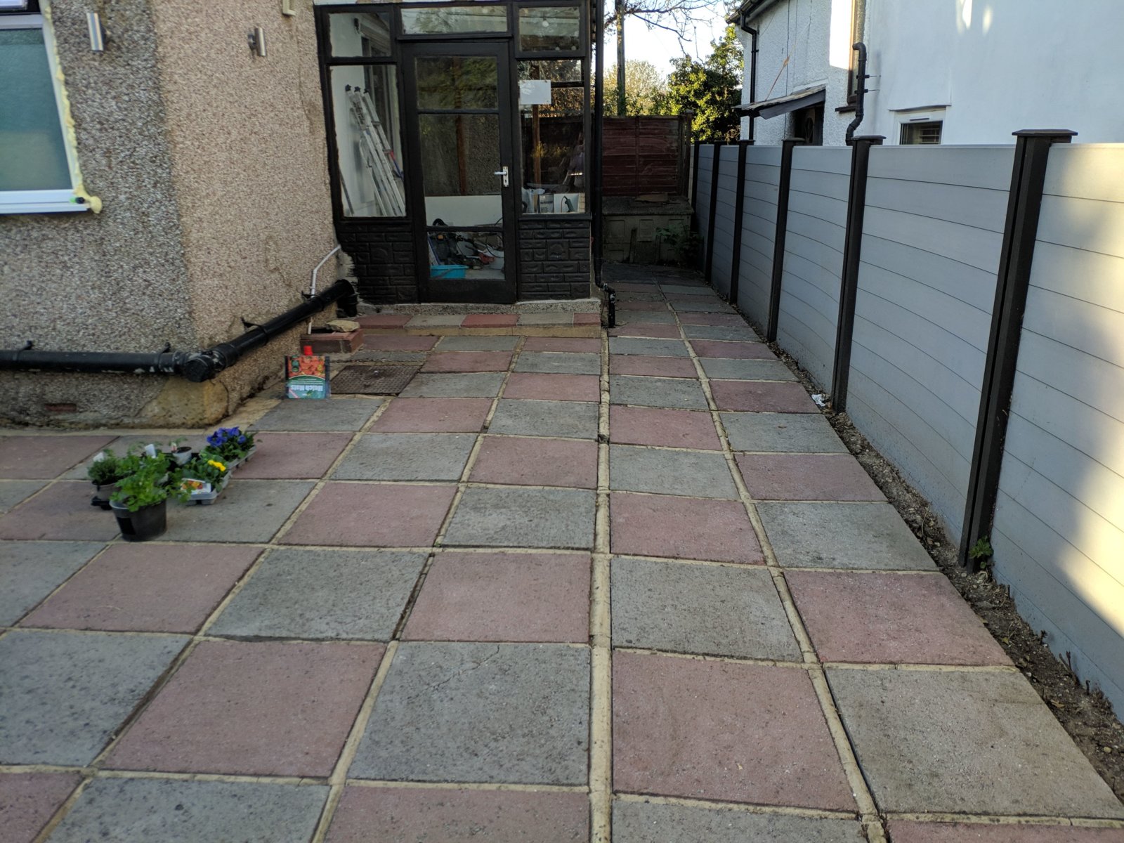

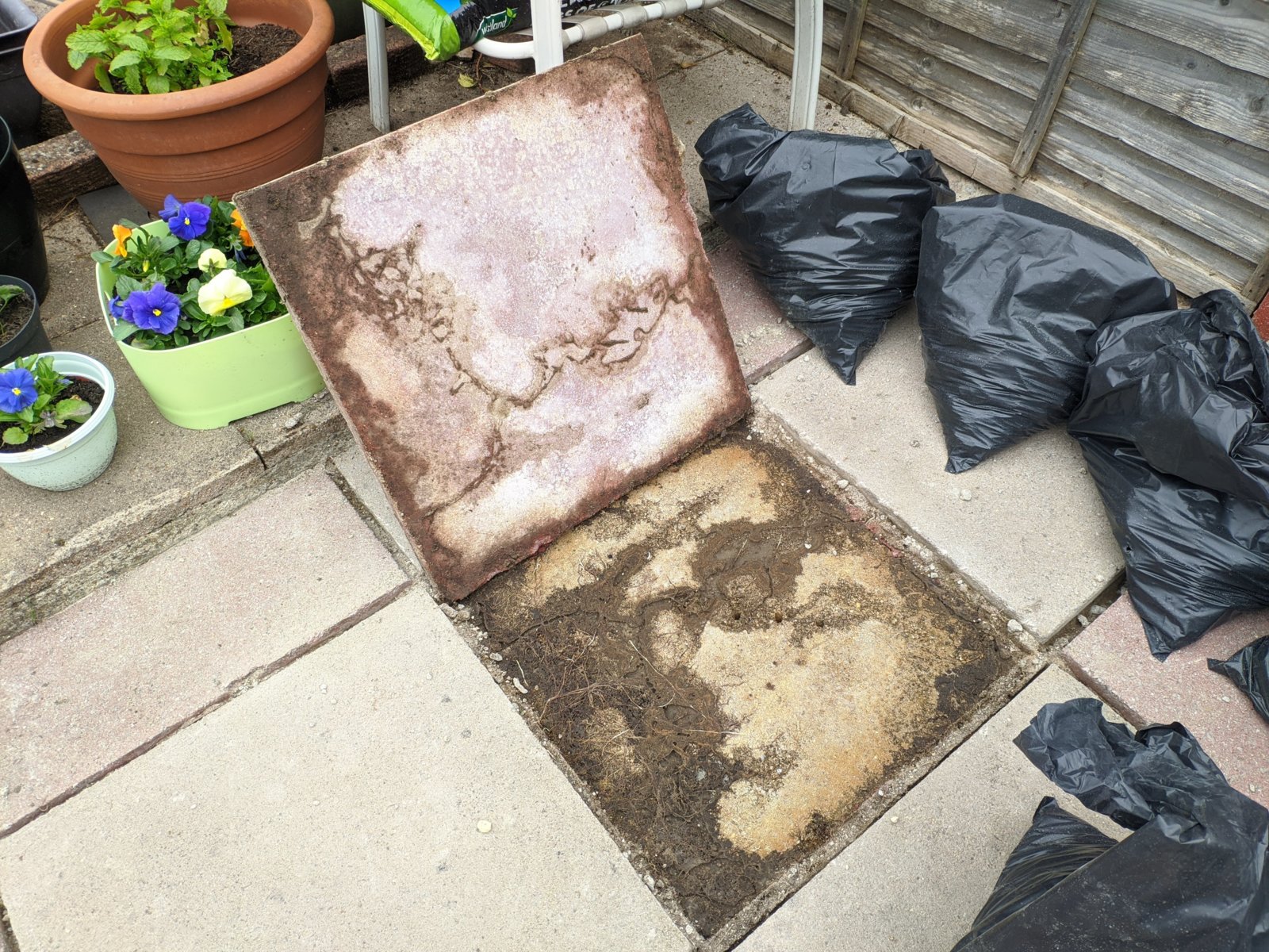

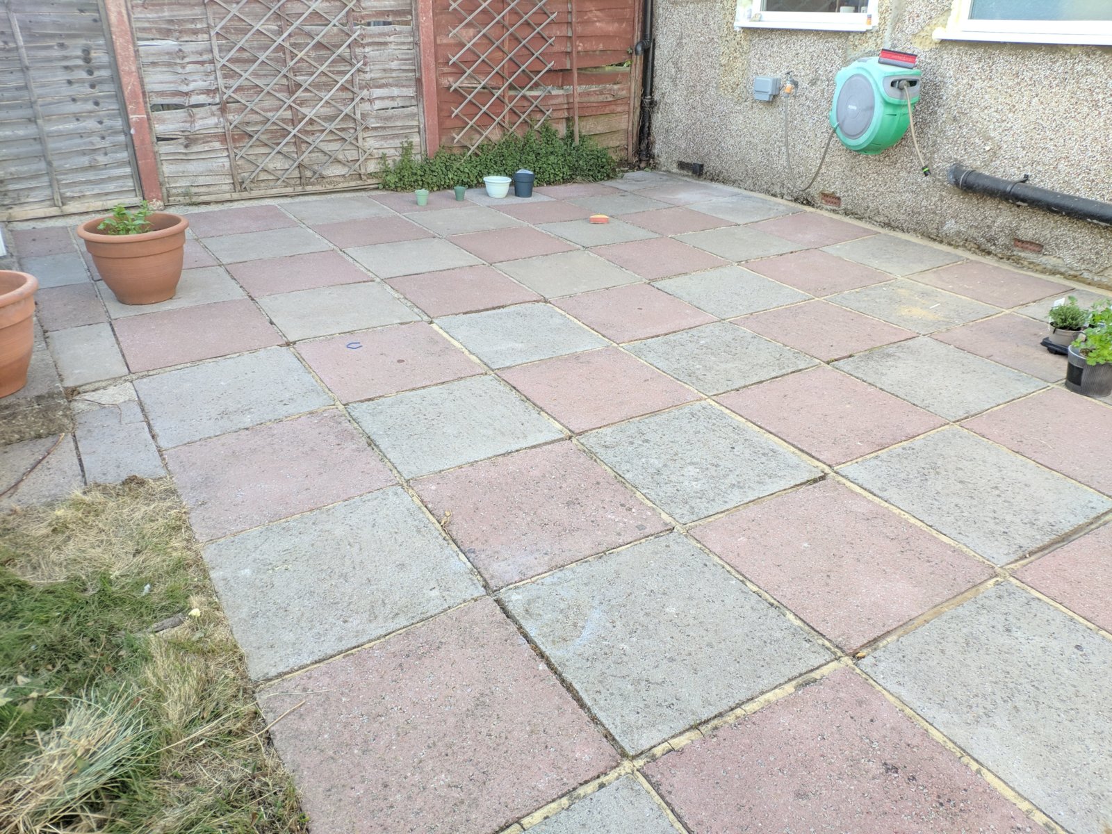

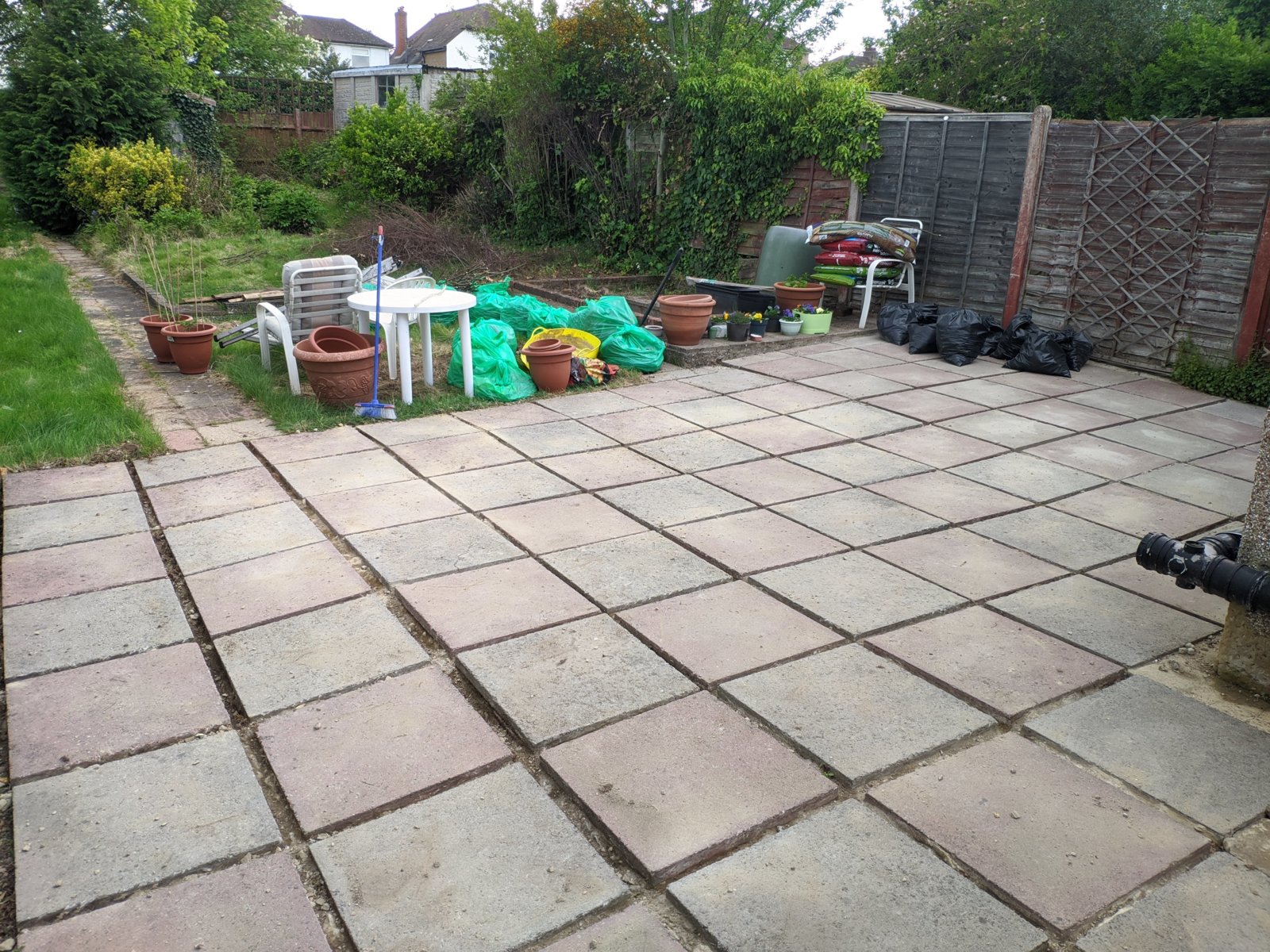

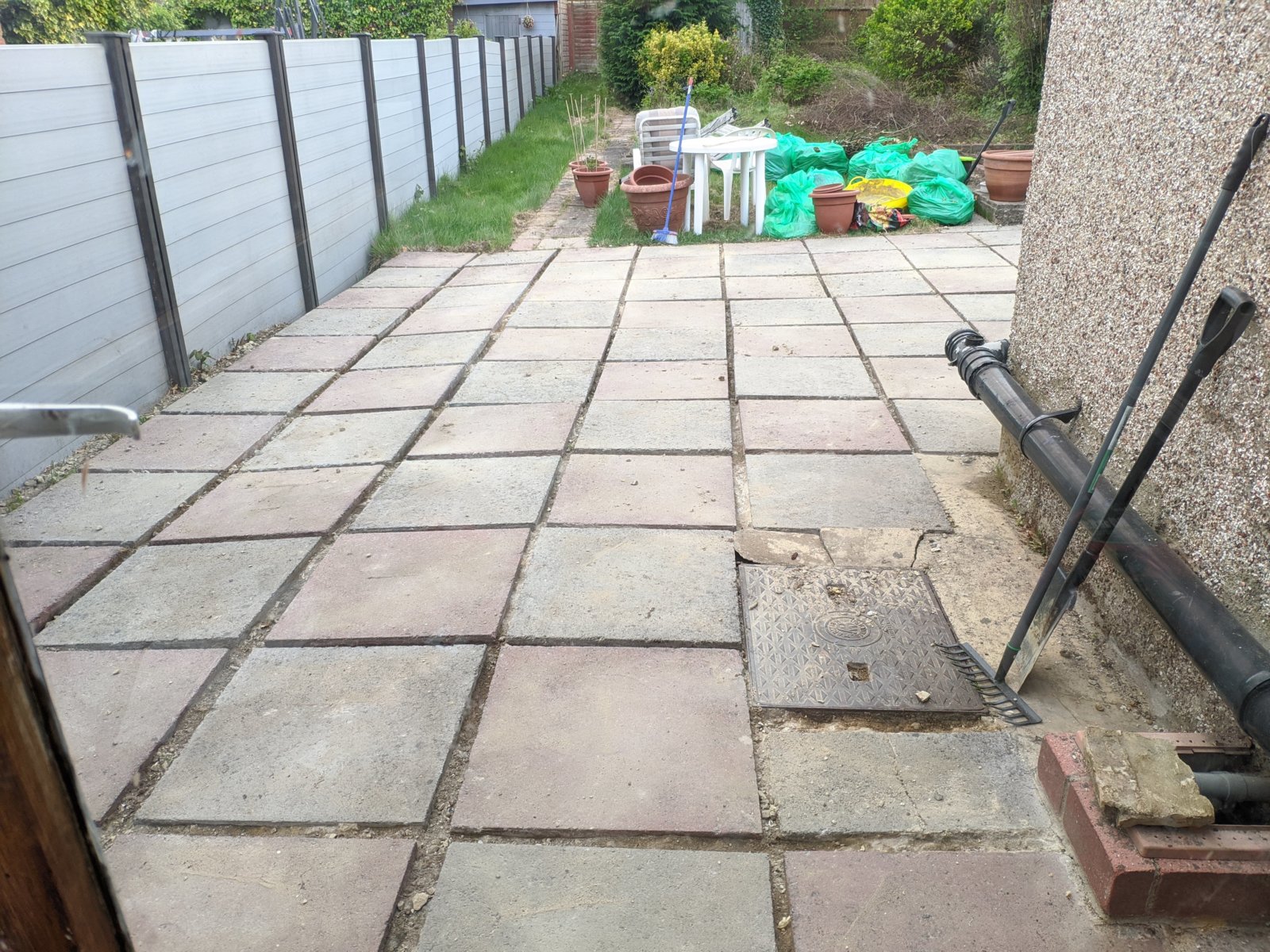

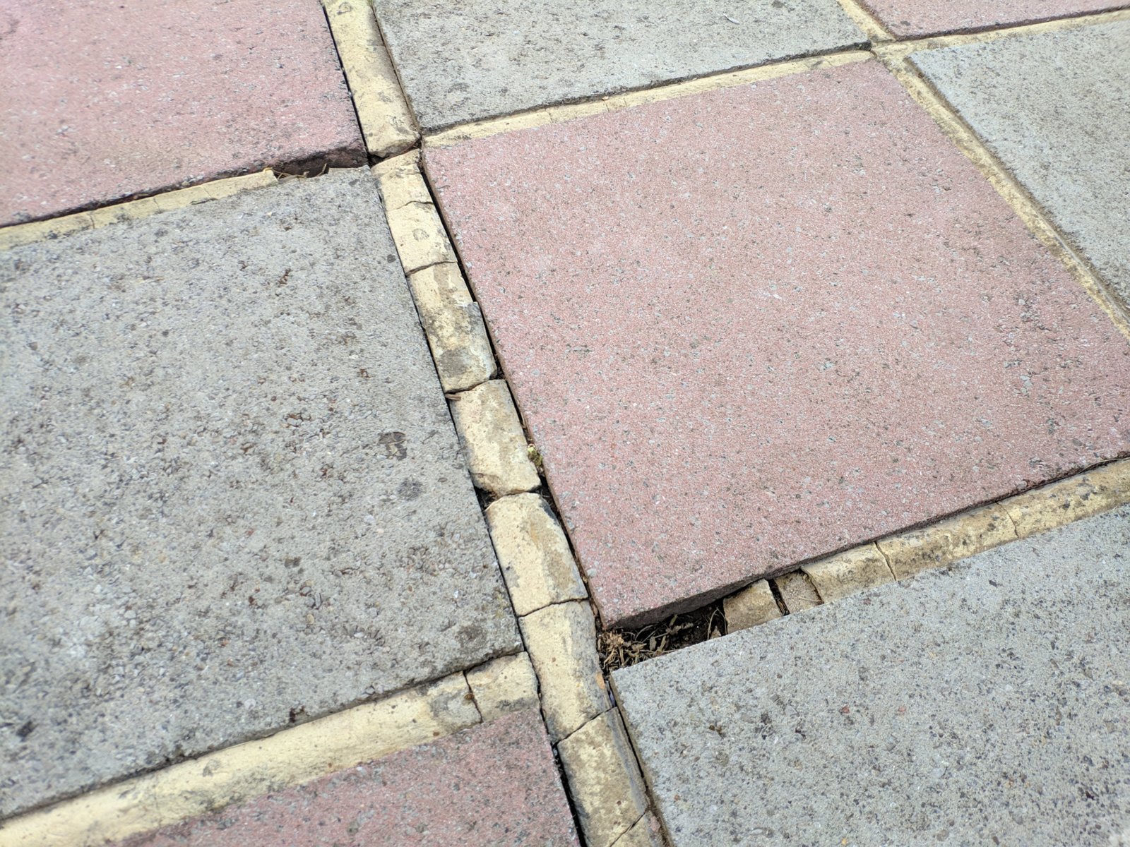

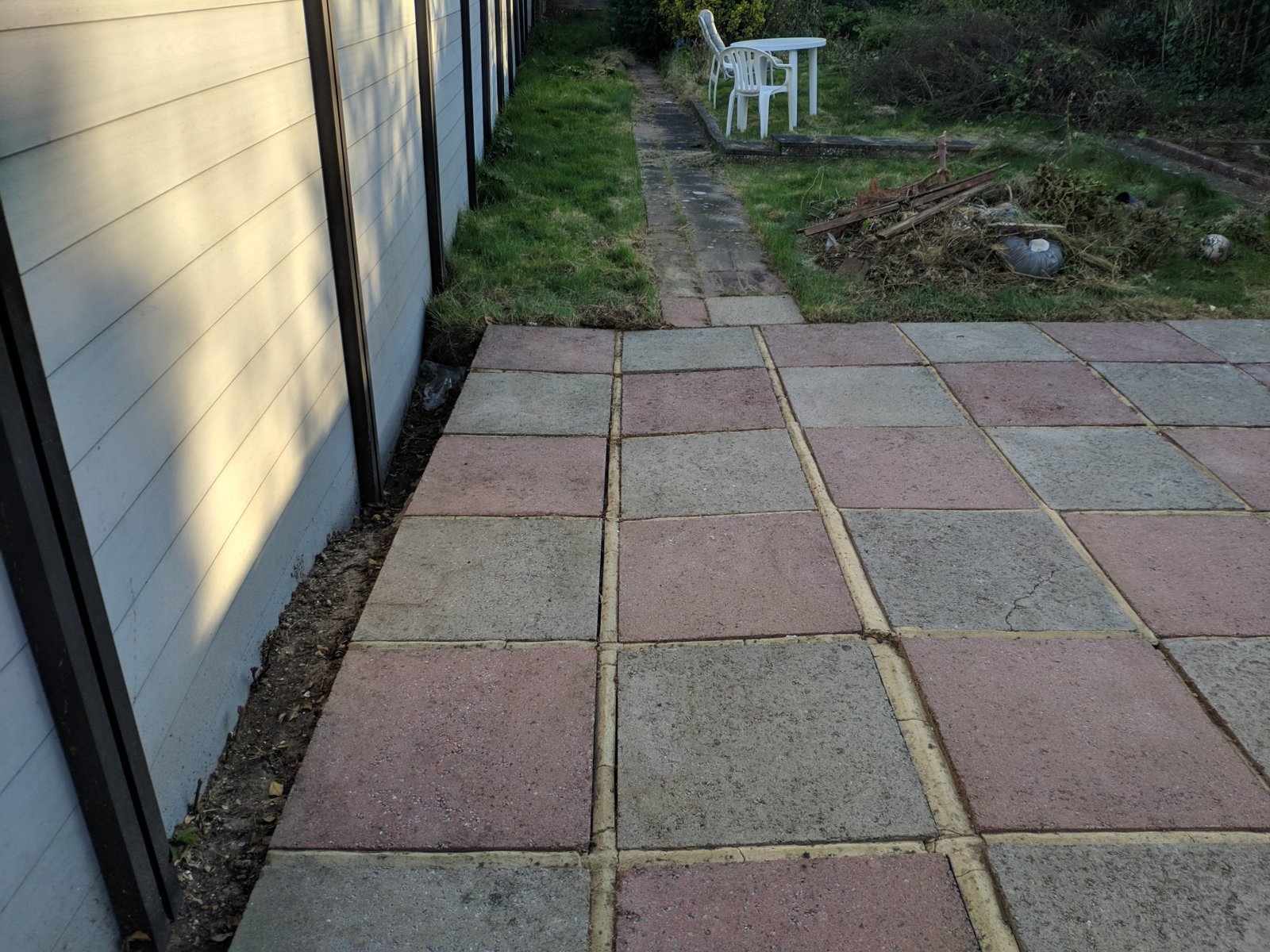

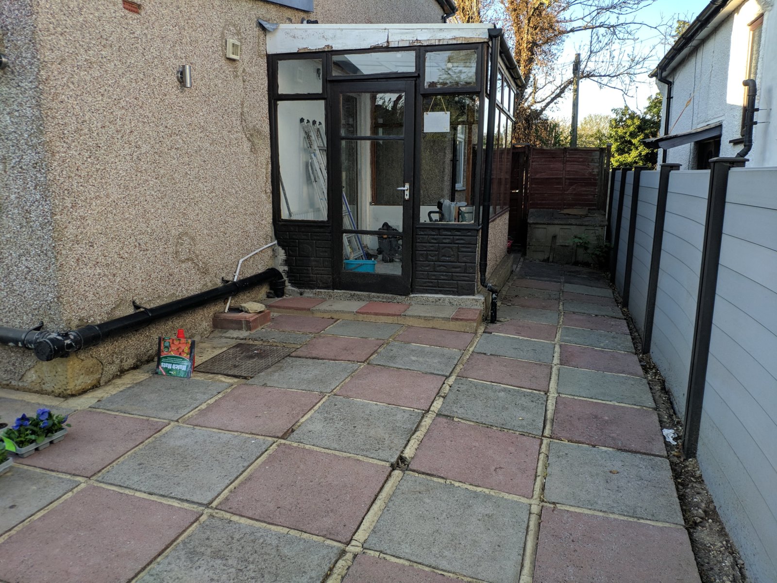

Wondering if there's any tips on repointing a patio that is sloping and not level
I was hoping can use the brush in resin pointing ive seen.

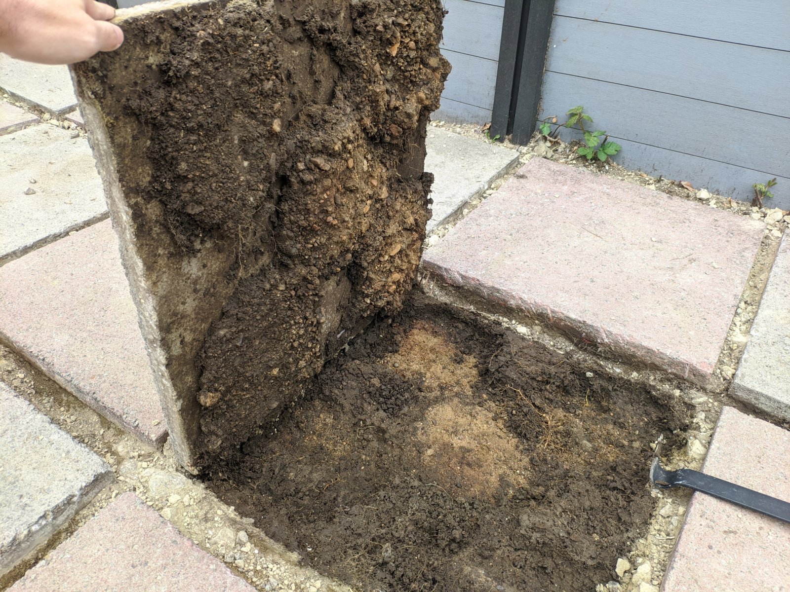

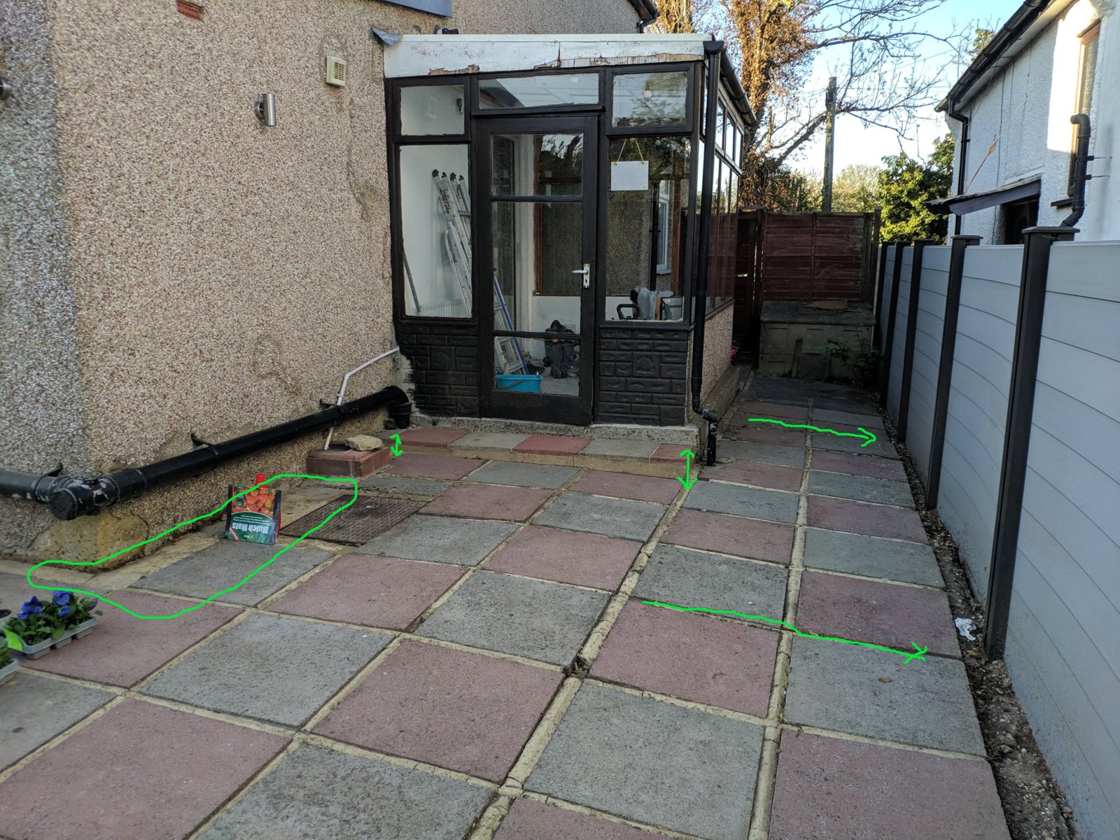

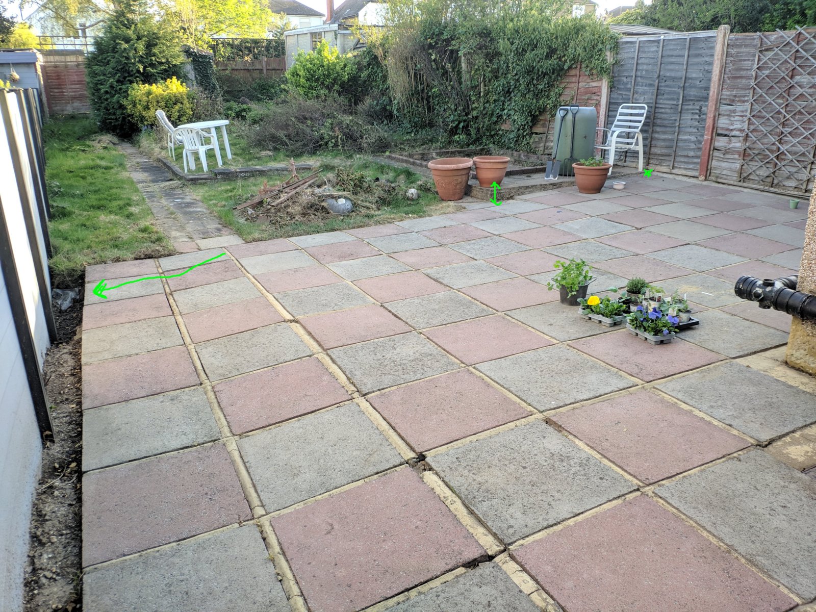

I would consider trying to relay the patio but it seems like its a big job since it goes all the way around the side of the house + it seems was put in at a slope? so would requires a lot more digging out than if its just sunk a bit?
We are planning for an extension in a couple years time so we dont want to do anything thats too costly but do want to try and clean it up and make nice
