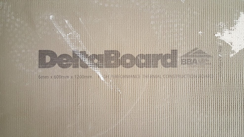

My builder has just installed a Polypipe (http://www.polypipe.com/housing/underfloor-heating) underfloor heating system. On top of the Polypipe system he has stuck down Deltaboard thermal construction board to make the surface smooth and flat for tiling.
My concern is that Deltaboard thermal construction board will act as an insulator and stop the heat from rising out. I've discussed this with him and he insists it is not a problem. Thoughts?
I'm guessing he should have used ditra or a self levelling latex compound?
Pretty sure that's supposed to go UNDER the UFH to stop the heat going into the ground, not above it or as you say the heat won't come through!
He's a knob, if he's thick enough to do this what else has he done wrong?
Ditra matting or hardiebacker board are the two approved by polypipe. You shouldn't use self leveling compound containing latex as it can case the pipes too lift.
He ended up taking out the 6mm Deltaboard and replacing it with Ditra in the first area where it has been installed.
We're also getting it put into another section. On the Polypipe web site it suggests tiling directly onto the overlay board as an option. I can't see any references to problems with using a latex self leveling compound, saying that I can't see anywhere they say it's ok.
