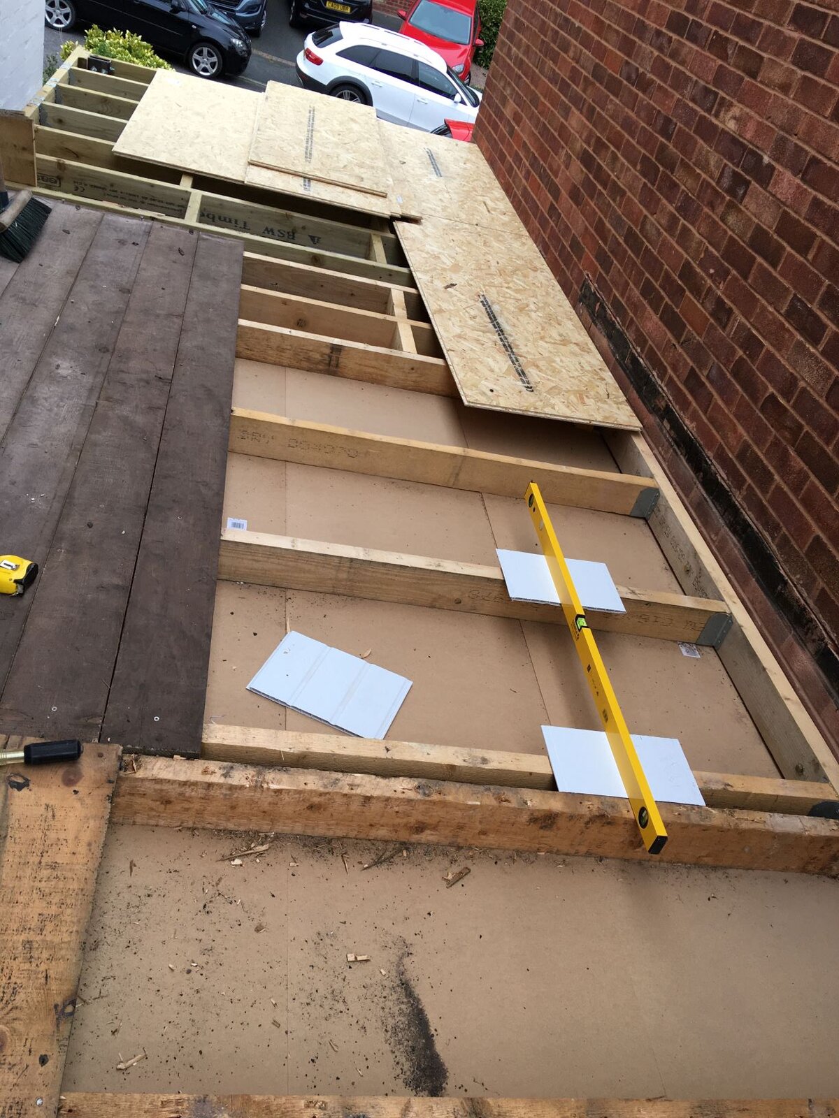

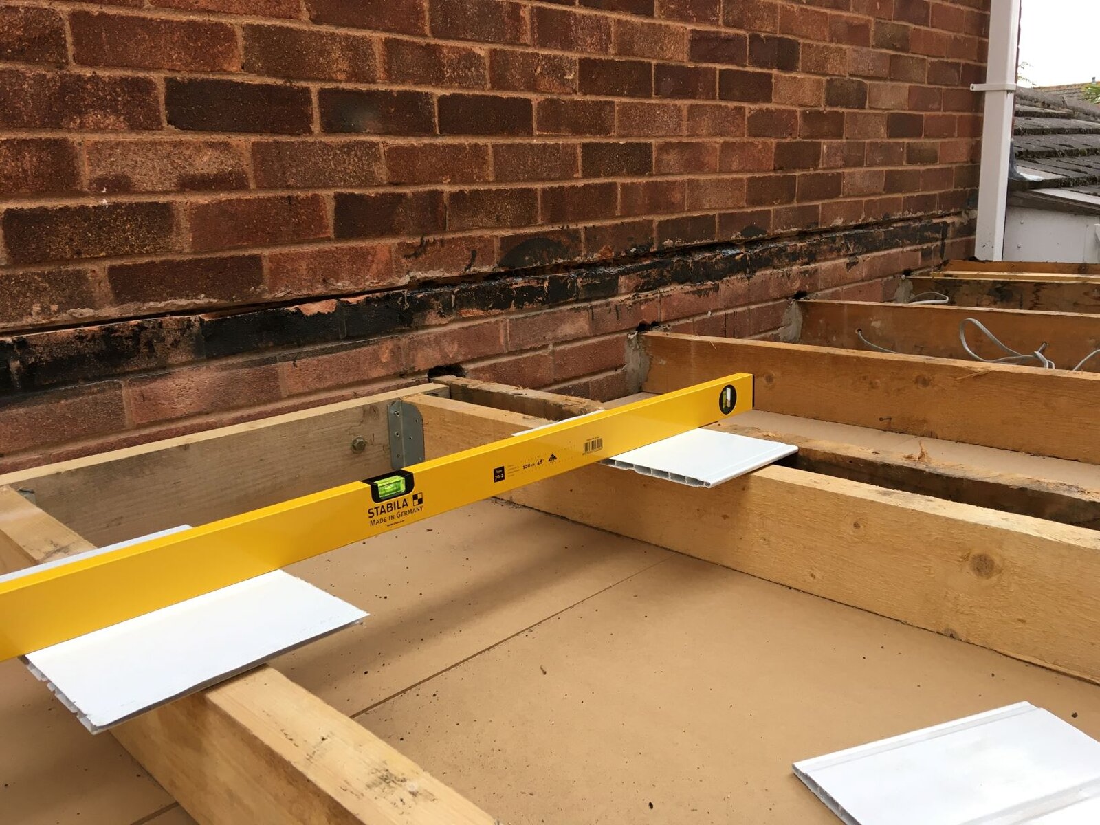

So today was the day for ripping off the old felt roof and boards, laying new OSB3 T&G over my new joists (where the DPM is at the top of the photo) and the originals before laying an EPDM rubber.
By the end of today, a brand new roof....or that was the plan !

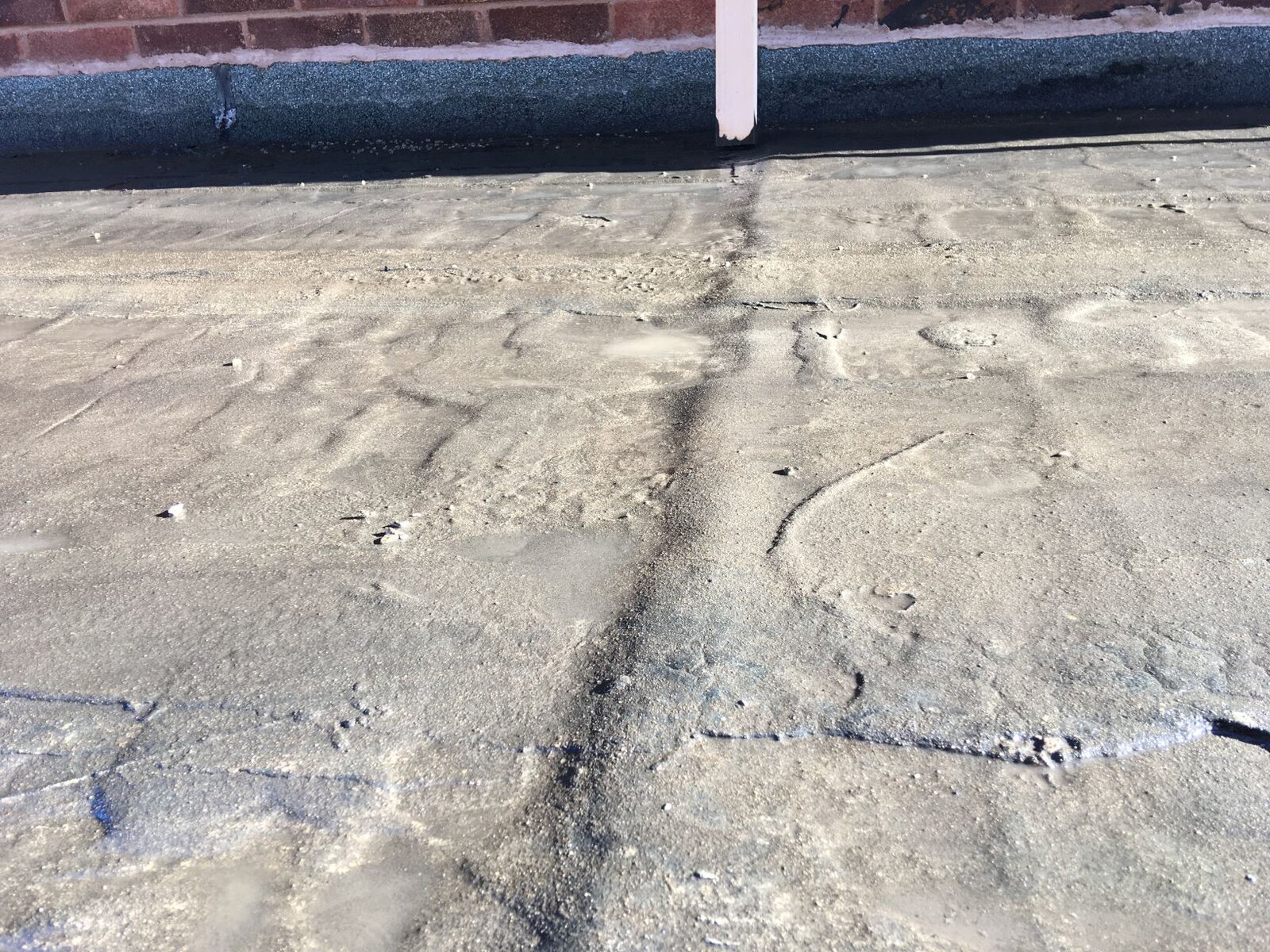

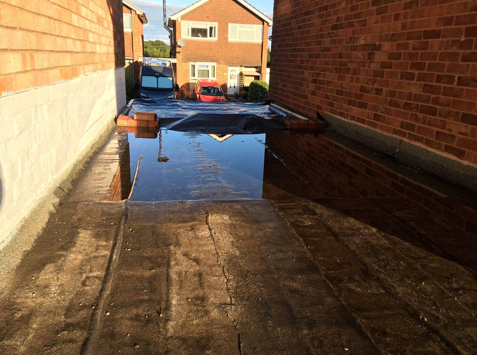

A day or so ago, i took off the chippings off the old felt roof in readiness and this morning, but to my horror this morning, yesterdays rain has shown what appears to be ponding :
The garage is 7.3m long with the run off/guttering at the back (where photo is take from)
Does anyone have any ideas how i resolve this please as i don't think firring/furring strips will be possible as the roof is too long ?
Alternatively, will this cause an EPDM roof issues, or being rubber, will it deal with it and natural wind movement rid the water naturally ?
