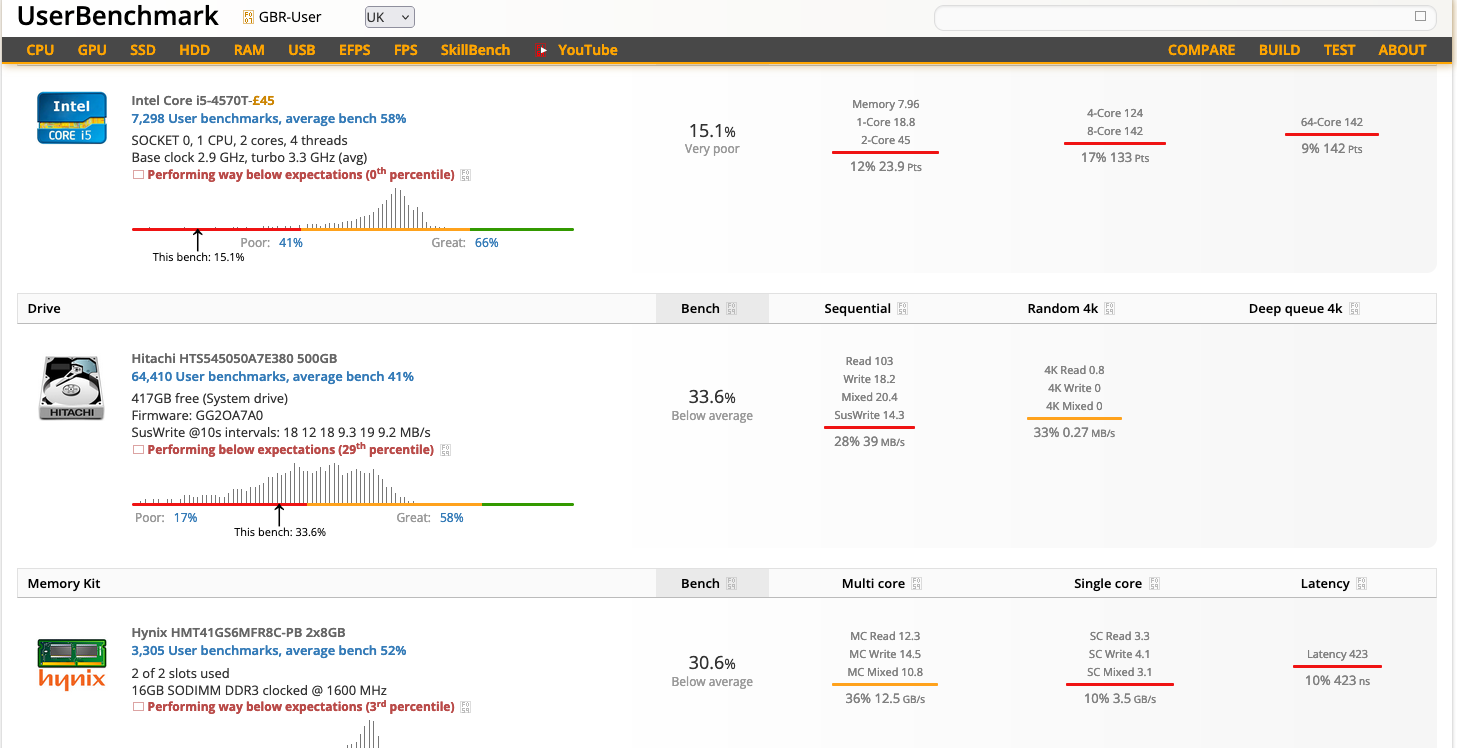

My daughter asked me why this old pc is so slow, ran benchmarks and seems to suggest all key areas are s-h-i-t-e?
Not a pc person so welcome comments, salvagable?

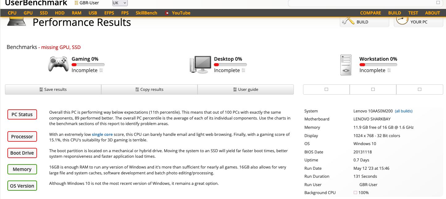

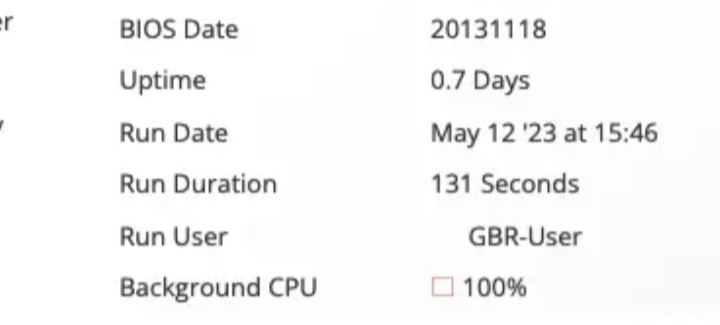

It's not a valid benchmark - the background CPU usage seems to be 100%
Whatever is going on in the background has severely slowed the CPU (...for this test). Whether that is due to a temporary task, such as windows updates, or something more malicious may need investigating.
The hard drive is a SATA 300, 2.5", 500GB drive - replacing this with a suitable SSD would also make a big difference to the performance.
....I should also add, the CPU is getting on a bit now, but it should still be able to handle less strenuous tasks!
Added to what Random Grinch said, that processor suggests a 1150 socket motherboard, which isn't upgradeable to much more than you have. I5-4690 from your i5-4570
Looks like a new mobo, processor and ddr4 memory are in order, plus like Grinch said, an SSD drive for your operating system at the very least
The 100% cpu was the benchmark running .
"Background CPU" should only be a few % for a decent benchmark...
The CPU score is so low, that something is going on, either background tasks, or some serious thermal throttling!

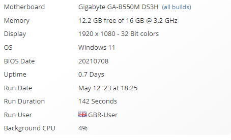

...have just done a run myself - "Background CPU 4%"
