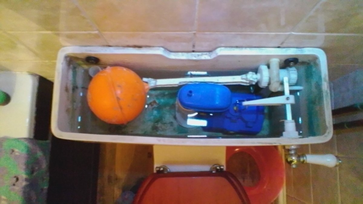

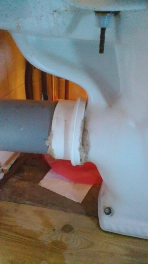

Some excellent replies thanks. Please see pictures of what I have

Definitely not a siphonic Wes.
If the flush is strong and it doesn't back up into the pan I would suspect a misshapen sump. This would cause Rolling rather than flushing.
I bet any money that the clear bung on that turbo syphon has popped out causing half a flush,,,, scratch that I can see it ....... Look how much ****e is at the bottom of the cistern , syphon has prob picked that up
As Danstace says, this is a possibility. It does look a new siphon in relation to your equipment.
You could convert to push button flush to give more efficient flush.
If not it's a hell of a lot of scale that has formed around the rim of the pan
