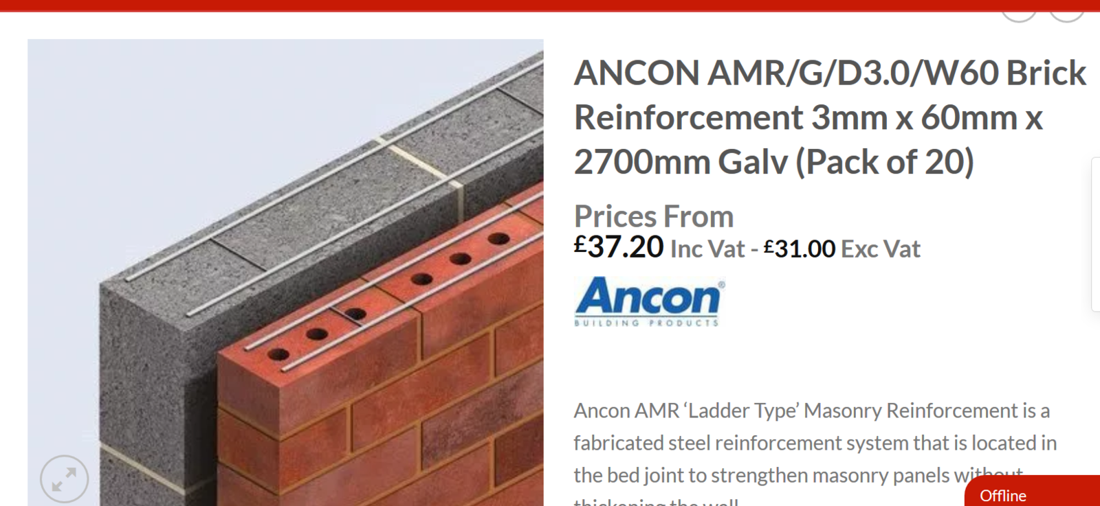

I've been a bit more methodical today assessing the situation after discovering it. It's actually 5mm deviance over 3600mm not 10mm as first thought, looks like the steel is just off the vertical by a mill or two. Could be the effect of torsional loading as suggested by Tony (thank you), could just be a not too straight bit of steel but as mentioned, I'll double check with architect and SE on that. Thanks everyone for your inputs.
This might seem a bit ott, but is it too late to take down just the outer skin; prop the outstand plate at third points and very gently ease it up
a little more than the 5mm deflection. And then re-build the outer skin, but incorporating ladder reinforcement in alternate courses, and tailing the reinforcement a reasonable distance beyond the ends of the beam. This would turn the outer skin brickwork into a beam, which would put less load on the steel plate.
Thats interesting, Ive not come across them before
They're twin strands of crimped stainless steel wires (not to be confused with rolls of expamet, which is not intended to be used as proper bed-joint reinforcement).

Ive known brickies use expamet for that purpose.....I had wondered about it, I mean its expanded metal, it expands.
That's very creative thinking Tony thank you, I have considered pulling it down or maybe using strong boys and rebuilding some of it a few course up off the plate after propping it straight but (and its difficult I know if you haven't seen it) it probably is going a bit OTT for what it is,,, that's not to say I wont but I'm not overly keen but I might have a chat with the brickie and sound him out.
