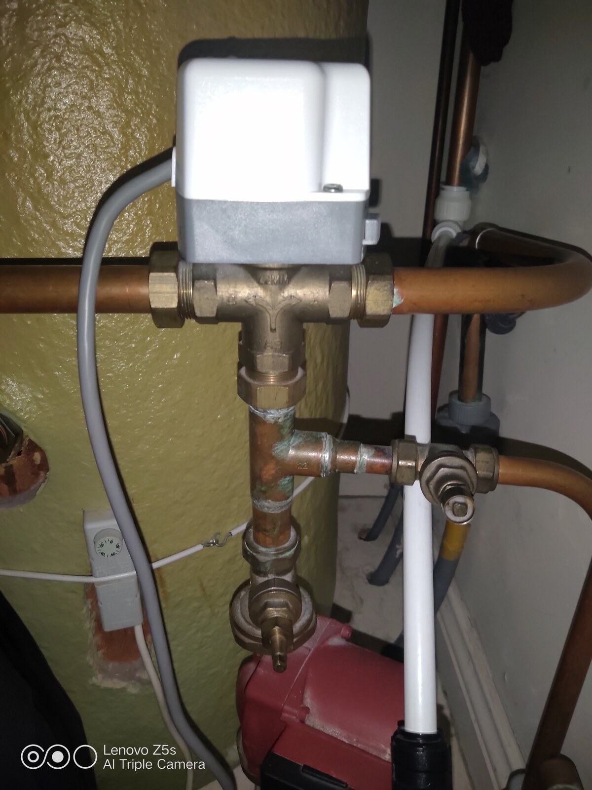

The house we have moved to has an old Potterton Suprima Boiler been working fine since we moved in but now we have hot water but no CH, the light on the circuit board is amber/green. We have tried resetting etc but same problem. Coming up to summer obviously we won't be needing the CH but my partner has serious health problems and we can't have this hanging over us until the winter. I was told it was likely the PCB board but wouldn't that stop the HW as well as the CH? Also heard it could be the syncron valve but don't understand what this is. I haven't got a clue about these things myself but struggling to find a gas engineer who will touch old boilers and we can't afford to have a new boiler.
Any help or suggestions please?

Above is a picture of a motorised valve

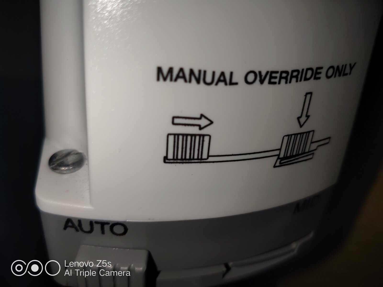

In the slot in the silver box. there is a lever.
This lever, if the valve goes faulty, can be pushed to the right and positioned in the slot that arrests the lever such that the valve stays open.
Going by your description, I suspect the heating motorised valve lever is manually opened so when you put the hot water on on your programmer, the water also passes to your radiators by virtue of manually open heating valve ( because it is defective)

Do you have 2 valves like #4, or 1 with 3 pipe connections?
I'm not to sure I'll go have a look, is this on the boiler or where the water tank is?
Not part of the boiler, on the pipework somewhere. Usually after the pump, perhaps in the airing cupboard or wherever the hot water cylinder is.
Thanks I'll take a look and photo if it's accessible

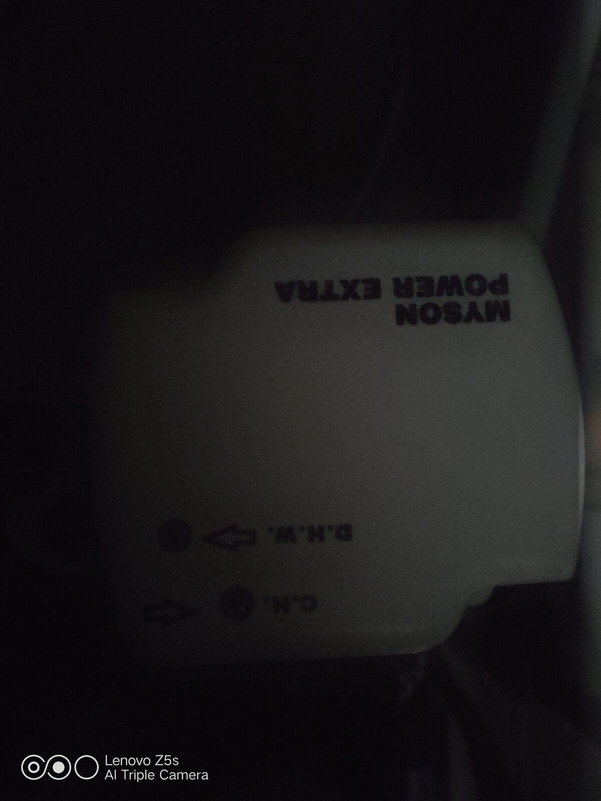

Photos of our existing valve, is there anything simple I can do myself to diagnose the problem?

Do you have a wall thermostat for central heating ? If so ,is it calling for heat ( put the temperature up to its maximum).
If you have a programmer/ timer ,is it set "on" for central heating ?
If both the above are calling for heat ,the motor inside your valve has probably failed ,and will need replacing ( or the valve itself can be replaced).
Sliding the manual lever to override and latching it in that position will allow your radiators to heat ,but only if domestic hot water is in operation and heating the hot water cylinder. Once the cylinder reaches temperature the boiler will shut down and heating rads will also cease.
Your 'synchron valve' is what is normally called a 3-port, or perhaps two 2-port valves. With the actuator for the CH port failed, or simply stuck. In which case, it should be a fairly simple job to resolve it..
You have a 3-port valve. That sends hot water from the boiler to either the rads or the HW cylinder (or both at the same time, depending on the type of valve). Sounds like it's stuck in one position, covering the rads port. Not a big job, but I doubt if you can do it yourself. As stop-gap, using the manual lever might give you heating. The HW cylinder might get a bit hotter than usual, but shouldn't be a problem.
So I move the slider slightly to the right to manual not all the way where it says overide only? So this will only work if I'm running the hot water?
Before moving the slide over, have you checked and answered what @terryplumb has mentioned?
