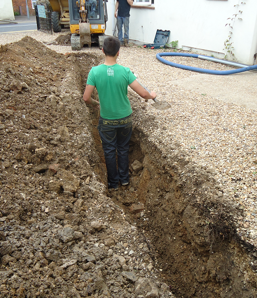

Across my yard, two ducts to the outbuildings, one for SWA to be pulled through and one for ELV cables.
