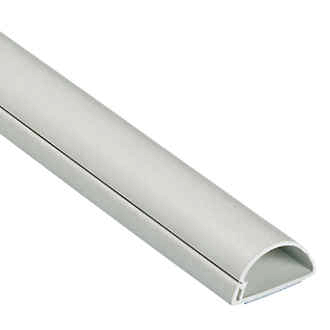

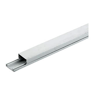

For surface I have used upload_2022-4-23_7-55-14.png D-Line PVC White Mini Trunking. Even for buried upload_2022-4-23_7-58-26.png 25 x 16 mm trunking is about thickness of plaster so plastered to edge so not obvious it was cables, specially if in the corners. I painted over it, main reason was cables were surface and did not want to renew or disconnect this allowed me to hide them.

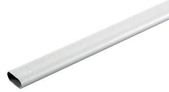

Oval conduit again allows cables at plaster depth, upload_2022-4-23_8-4-45.png without removing as much plaster as required for capping, but be warned renewing a twin and earth in capping or oval conduit is hard as the cable snags, flex is easier, remember the current rating for flex is in free air, so buried it is slightly less than rating for twin and earth as rated at 60°C not 70°C.
