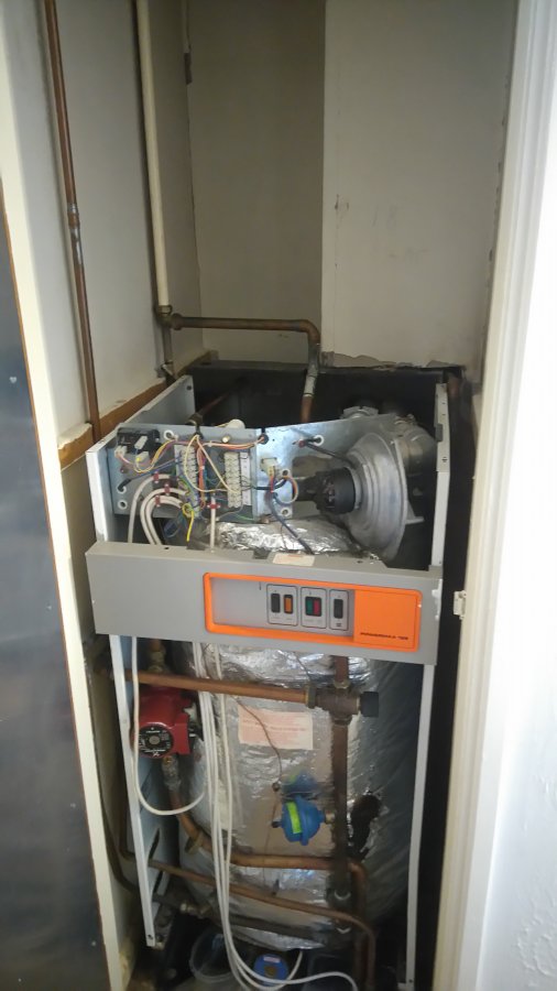

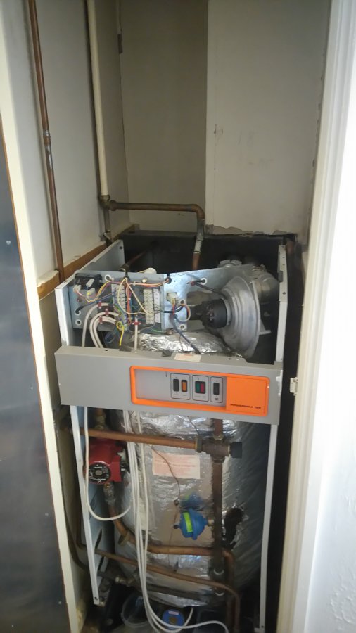

powermax range 155 wont fire
i definately wouldn't touch anything to do with the gas myself mate,,,im pig sick of it now,,,i just thought maybe I could get it going to last the winter and replace it in the spring,,,looks like I'm going to have to get it done a lot sooner...
have you mentioned the problem with oxide to the engineer ? what lights are showing on the boiler when the boiler is faulting ?
yes mate i mentioned the black water coming from the rads to the the gas lad,,,when turning the hot water on the fan will spin and it will cycle maybe 5 or 6 times trying to fire then locks out with the red lockout light illuminating,,,i did notice a few of the valves weaping a bit after it went wrong,,,one on a towel rail ad two on the boiler itself,,,in the past when ive seen this its usually down to a blockage somewhere causing too much pressure,,,but that was on a sealed system this one is vented,,,i don't know if that makes any difference just saying......
If it doesn't light then that is down to gas and air and ignition. Whatever the state of the pipework, radiators or water it is all irrelevant.
another question for you lads,,,all my rads are piped up in 8mm copper,,,will a new 28kw combi be fine with this???
yes in operation, but make sure they are as clean as a whistle which is a tricky task on 8mm. The original installers didnt do you any favours did they?, a powermax and 8mm microbore.
no mate they didn't do me any favours,,,its hard to believe the previous owner of the house was not only a heating engineer with his own business but also a college lecturer for wannabe heating engineers,,,i mean if I went to a carpenters house id expect all his woodwork to be pristine if you know what I mean......
well still no further forward with this,,,thought id try and get the thing fixed before doing any major surgery,,,the gas lad tried a new sparker and gasket last week,,,now this morning fitted a new gas valve and still no joy,,,says only thing it can be now is circuit board???,,,ive got a sneaky feeling we going to fit a circuit board and its still not going to work,,,ive got a feeling its going to b something very simple whats been overlooked,,,any ideas what it could be any of you gas lads???,,,are there any thermostats or something similar what could be stopping it from firing???,,,the ignition cable is sparking and just had new sparked fitted in the gas chamber,,,there is power t the gas valve,,,and also gas according to the engineer,,,baffled......

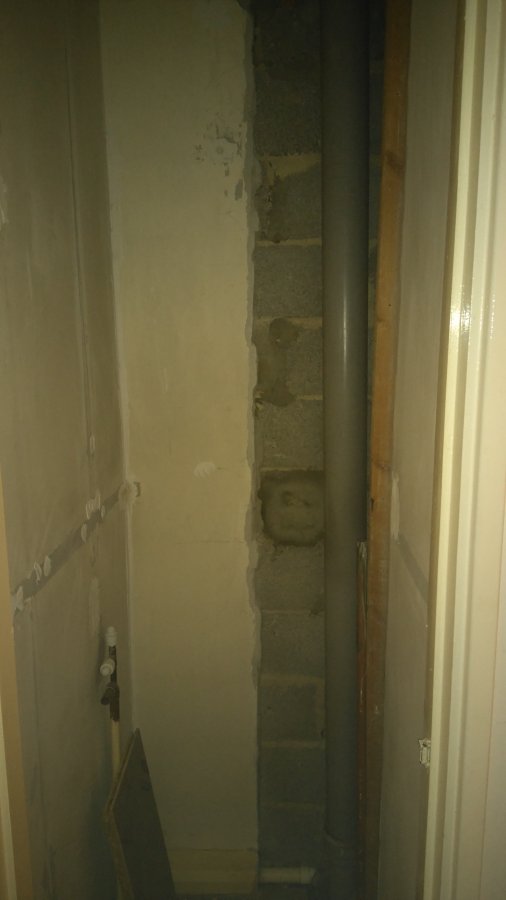

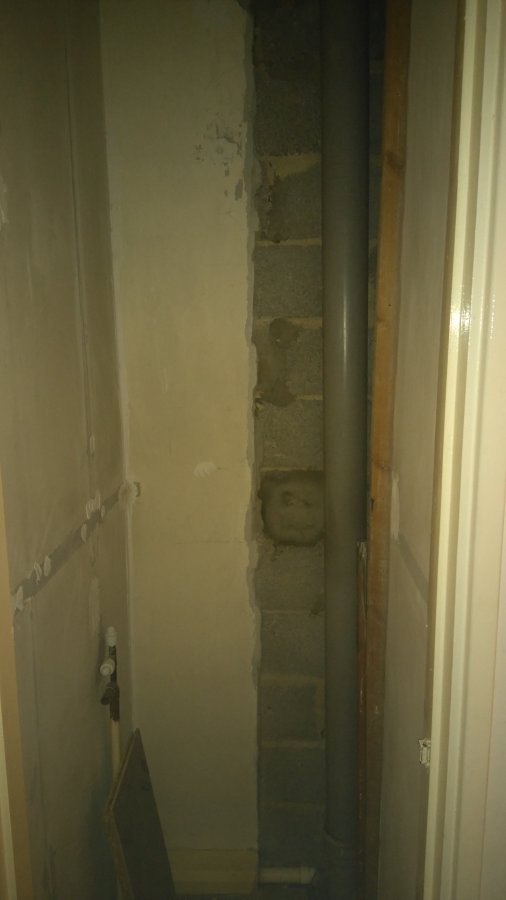

The beast is history...

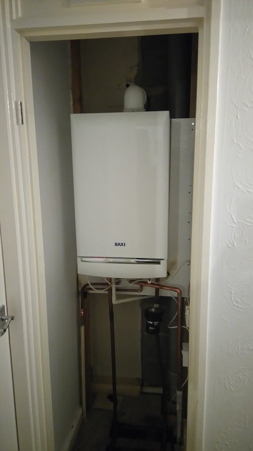

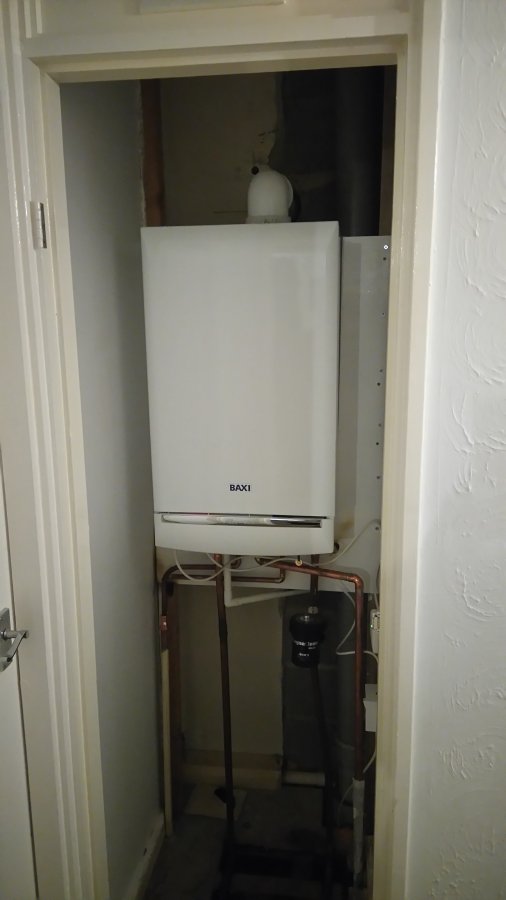

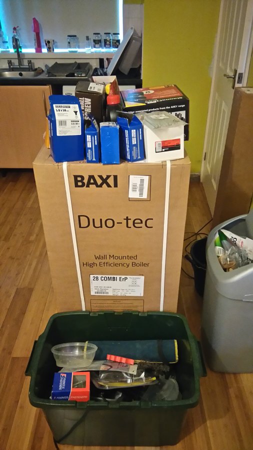

Got there in the end lads...
