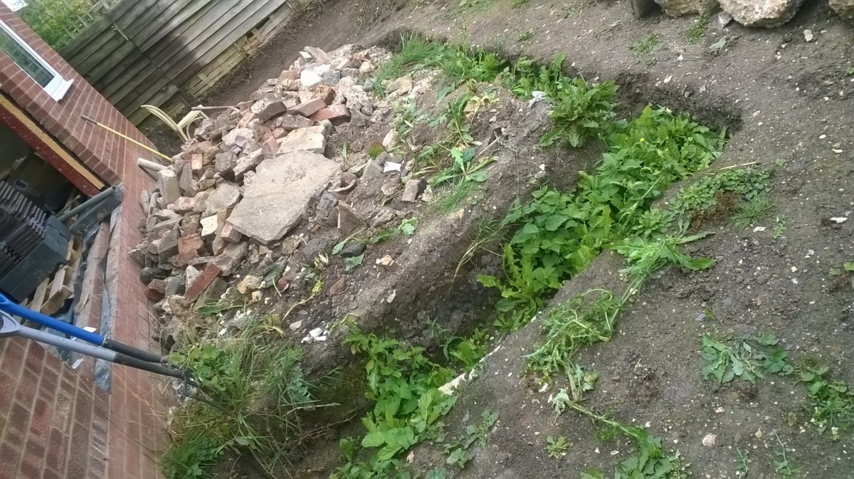

Hi,
I am planning to haave a slabbed patio area immediately outside my bifold doors. It's around 3.5 metres wide and 2.5 metres deep. It will be raised around 50cm from the ground and we have built the retaining wall out of blocks. It will then be cladded for aesthetics.
Q. Once the retaining wall is at the right height (around 20cm below DPC level), and in filled with hardcore and tapped down, what should I be doing next to prepare the surface for slabs?
Thanks in advance.

Just make sure it is well compacted. Don't try to compact the whole lot in one go - lay it in 100mm layers and compact each layer.
perfect, once the hardcore is compacted, how do i prepare the surface above this before I lay the slabs on top?
I did the exact same thing at my own home a couple of years ago and i would recommend building the wall and fill it with clean rubble. This way there is no need for major compaction as a fill that deep with type 1 MOT or similar will settle no matter how well you compact it down. Better to use clean rubble that has no compaction.
The issue with this however is that you need to lay your paving on mortar as sand would simply filter down through the rubble.
Once I've compacted the hardcore, do I need to lay a membrane and how thick should the mortar be?
No need for a membrane. Fill with clean rubble and then for the last few inches bring the size of the stone down to say 20mm clean to fill in the voids between the larger chunks. You then would need to lay on a good 50mm bed of mortar.
You could alternatively cap the whole lot with a few inches of lean mix concrete which would give a good tight flat surface to lay on.
