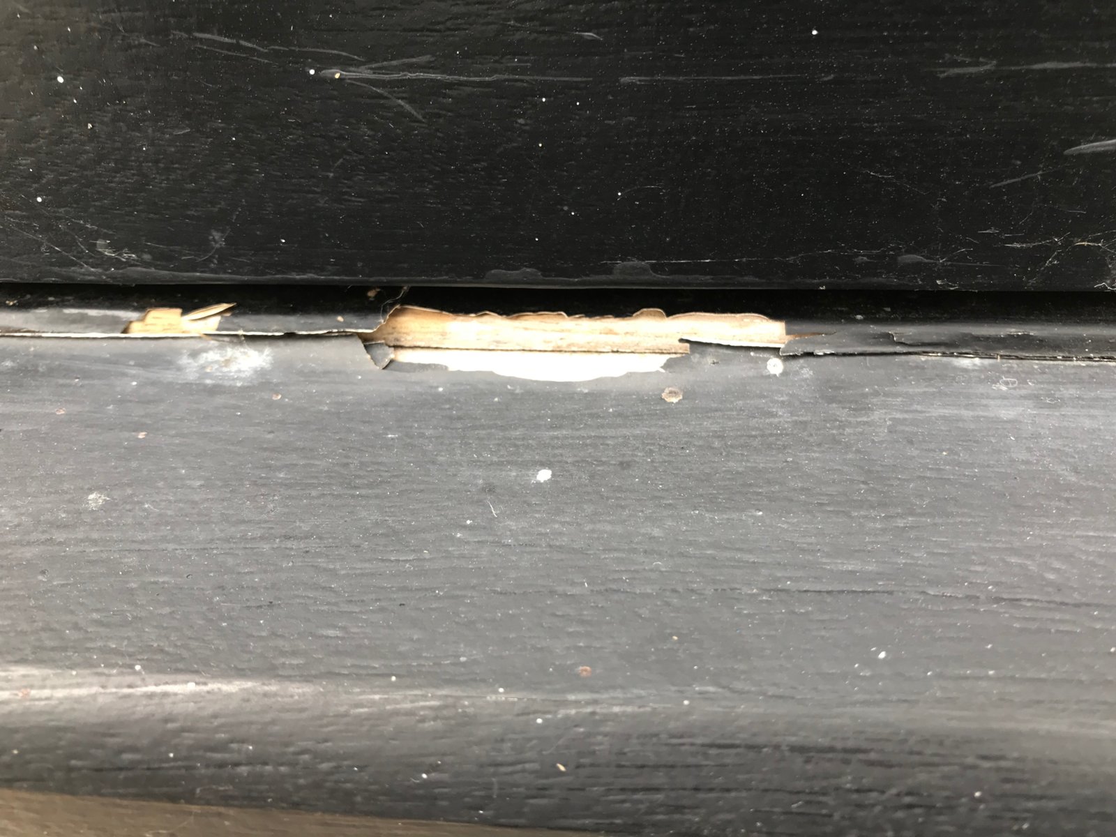

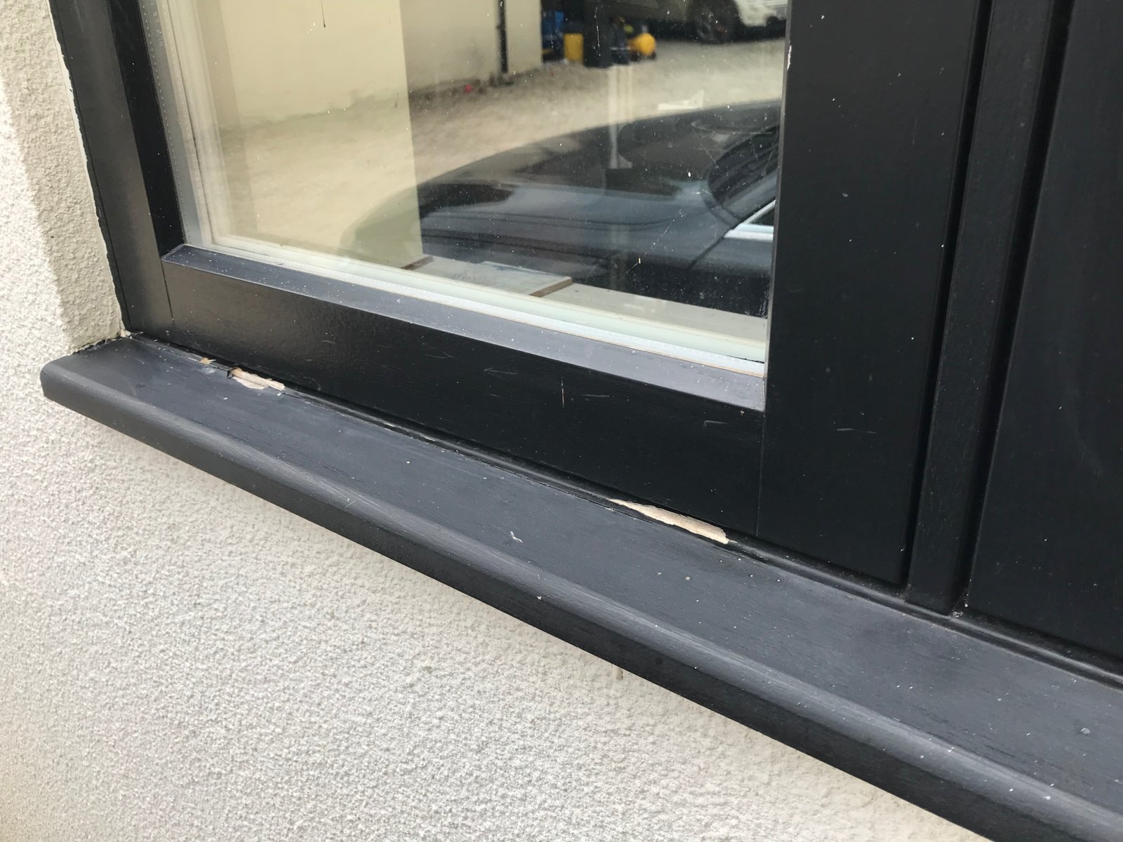

Hello,
The paint on one of my window cills has started to come off (see photos), and I want to prevent further deterioration of the paint, or damage to the wooden cill underneath.
This is the only window cill in the house which has this issue, so I was hoping there might be a temporary fix that would last until such a time as all the windows required repainting.
It doesn't look too bad. Spot prime and paint it (using caulk as required).
I am guessing that the current finish is waterbased (given the sheen level).
Thanks for the reply and advice @opps. Not sure if the finish is water based, and not not sure how to tell.
Based on your advice, I plan to
1. Sand gently to remove flaked paint
2. spot prime
3. touch up with similar coloured water based paint.
