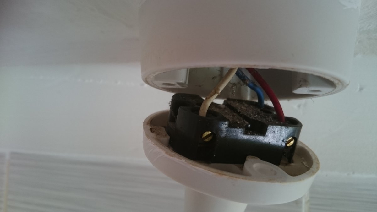

How is the other switch wired? A photo would be good.

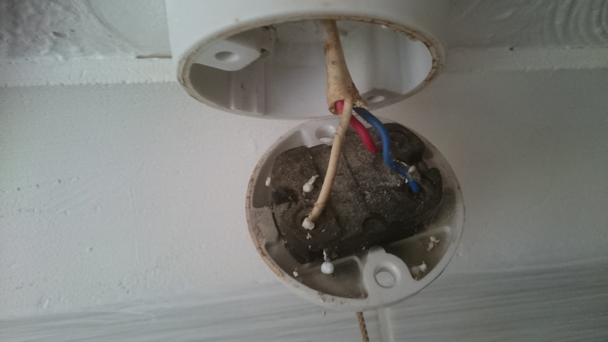

Hi, lol, I'm not that daft :), I photographed them (attached), but the old pull switches weren't marked clearly. But we can see that the live and neutral are at one end (L1 and L2, i guess) and the grey/white/yellow at the other (L). I have connected the switch in the same way. I have tried connecting the wires to the switch in other combinations but the current way I have it connected is the only one that has the switch working at all so far...

Ta. I have connected the dirty white wire to L on its own at one end, then brown and blue at the other end to L1 and L2 respectively...

Btw, on closer inspection, I see that the terminal on the removed pull cord that the dirty white wire was connected to is marked "common, 2 way". The other 2 terminals are not marked. Dunno if that helps!
