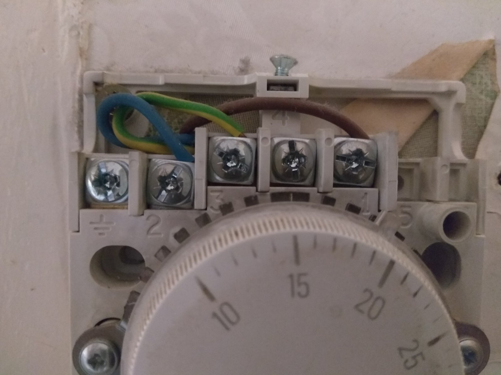

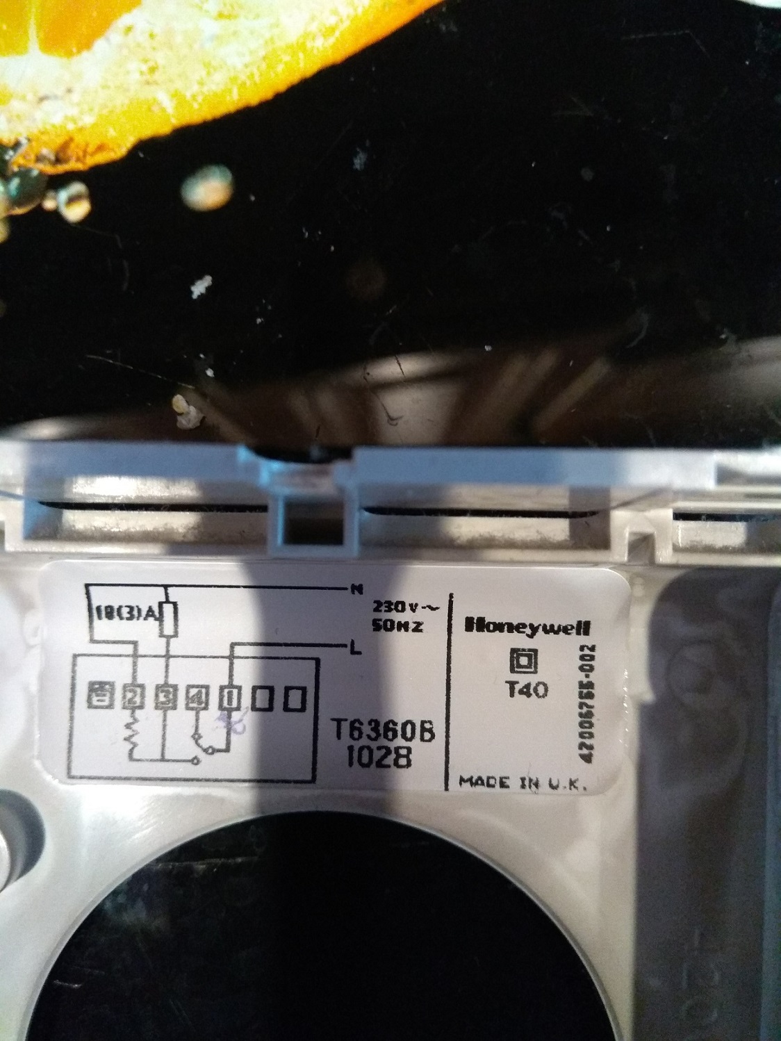

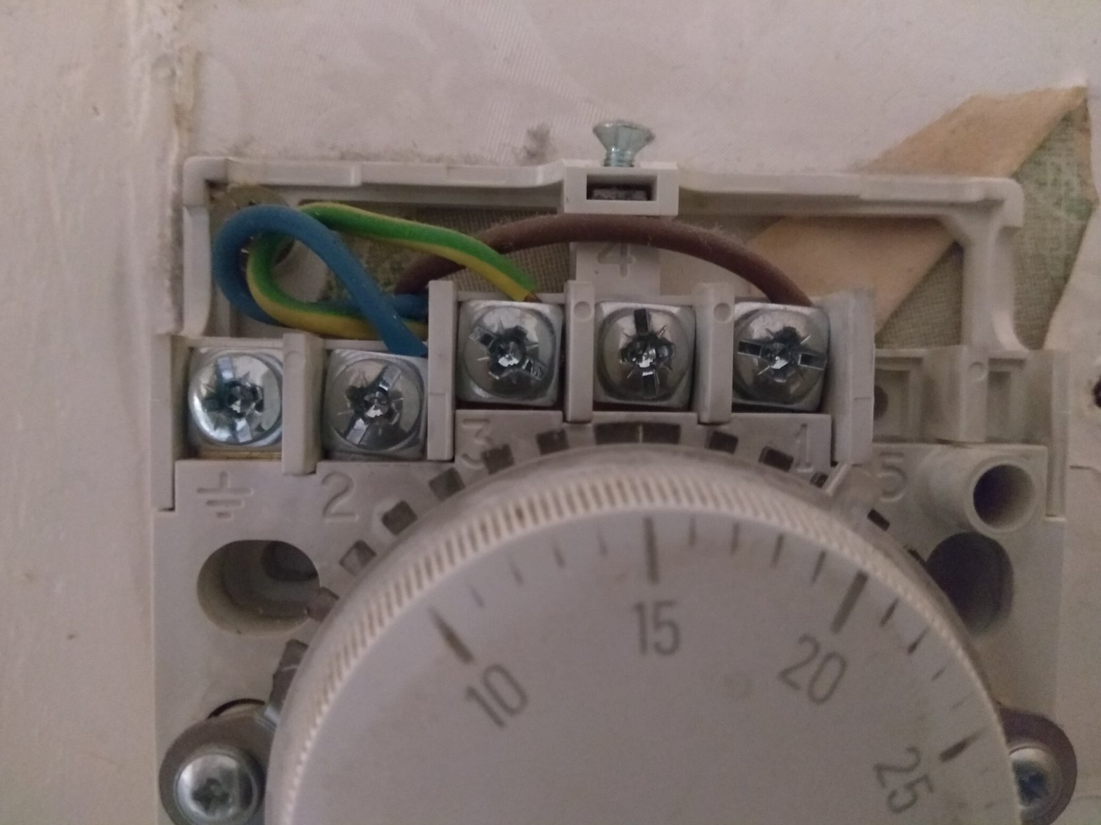

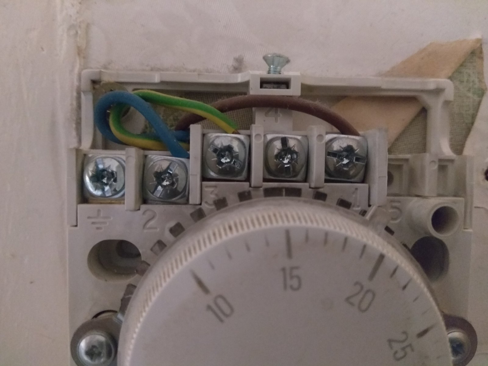

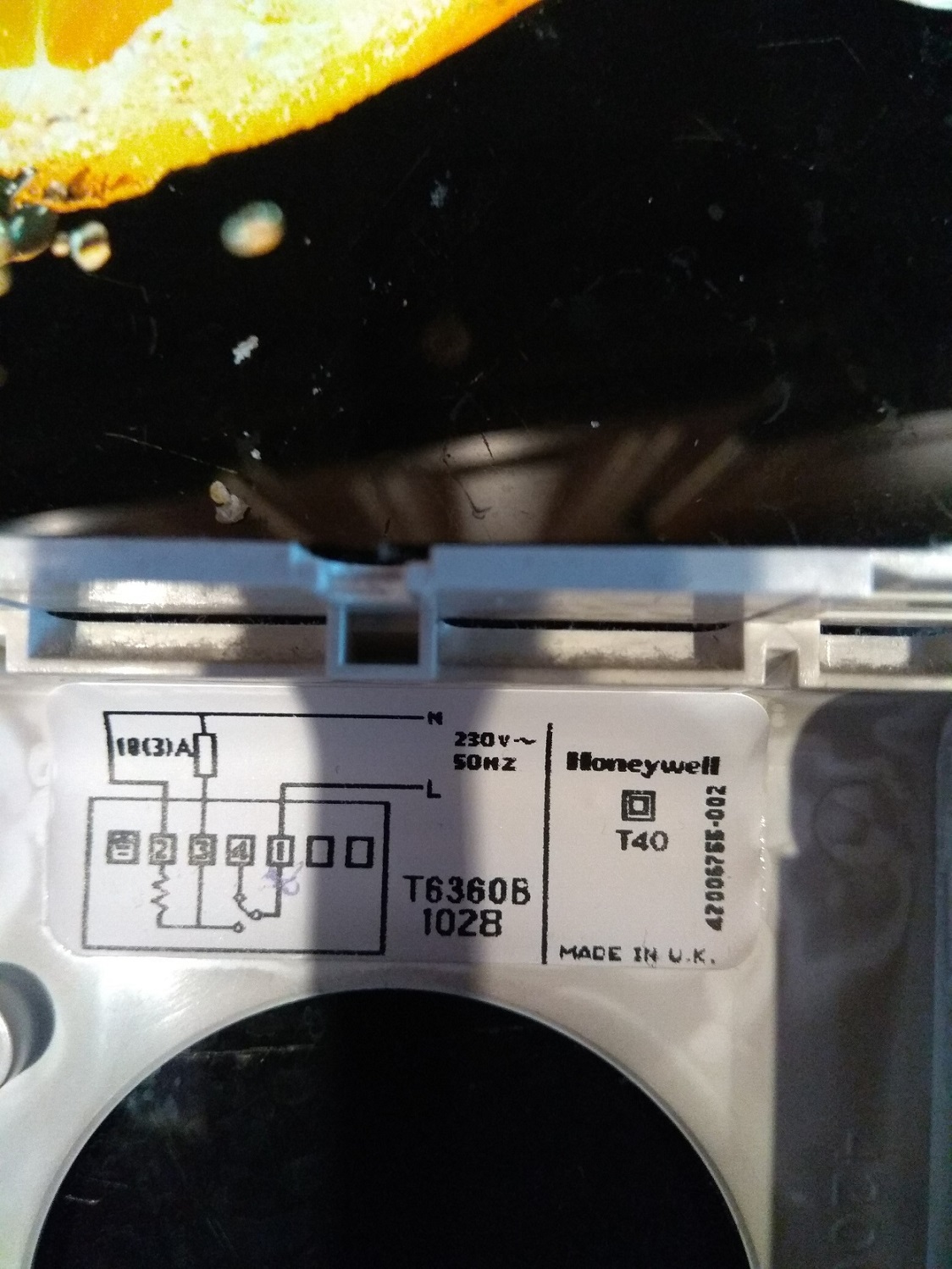

The original wiring set up for the Honeywell T6360B (see photos) was as follows:
T1 -- Live-IN (Brown cable)
T2 -- Neutral (Blue cable)
T3 -- Switched Live-OUT (Yellow/Green Cable)

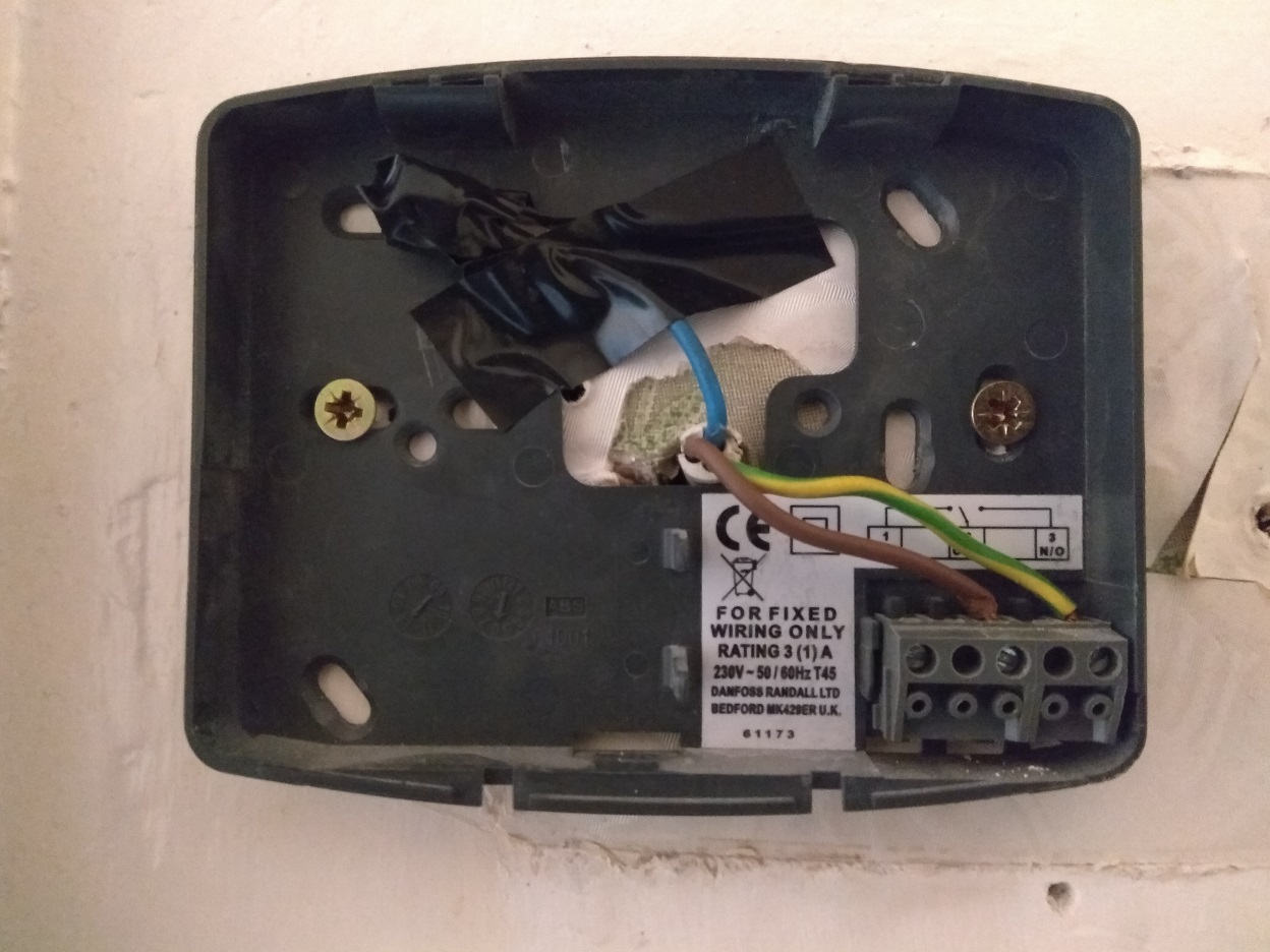

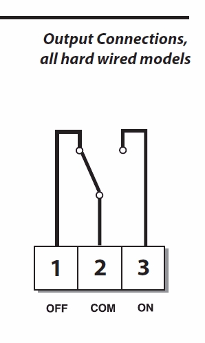

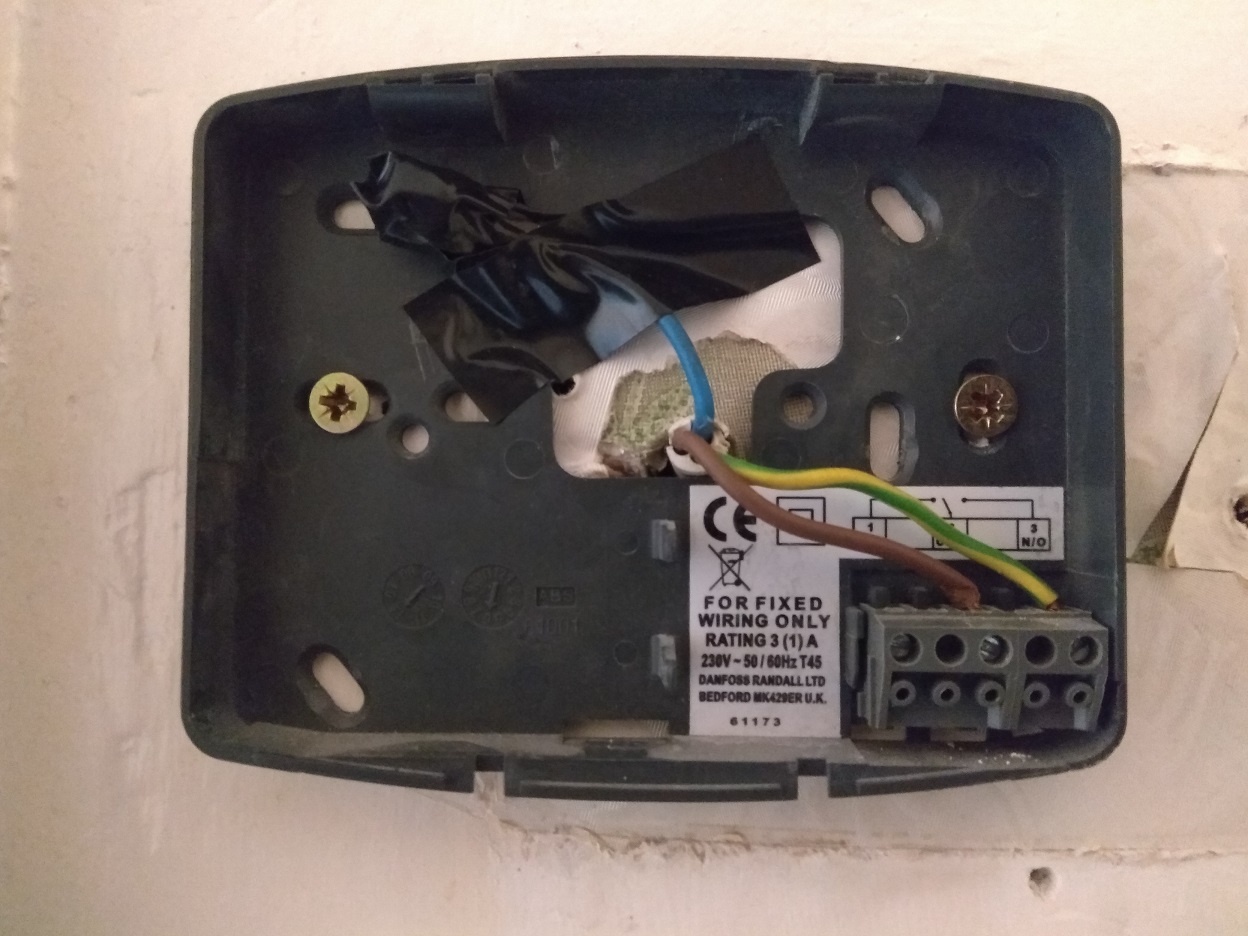

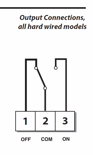

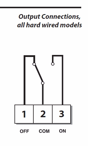

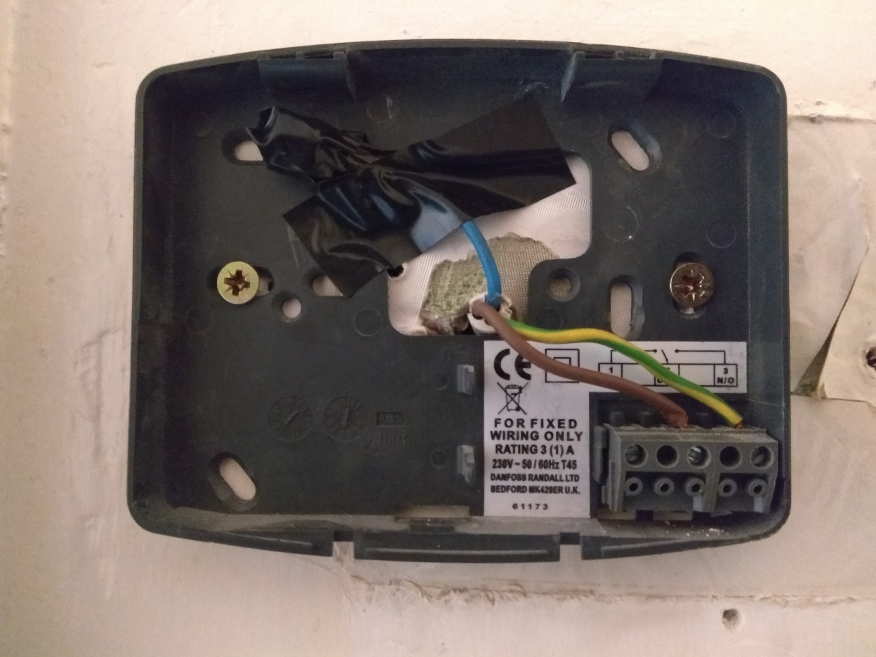

For the TP5000si the new wiring set up (see photos) is as follows:
1(OFF) -- (No cable Connected)
2(COM) -- Live-IN (Brown Cable)
3(ON) -- Switched Live (Yellow/Green Cable)
(The Neutral blue cable is left disconnected via an insulated terminal block)
As far as I am aware the wiring all looks fine... so I am puzzled why the central heating keeps coming on and going off on it's own accord even when the desired temperature is set below the room temperature???
Your thoughts on this would be much appreciated.

It was right as it was. T2 (Common) and T3 (On) are the correct terminals to use.
But as Mr Therm says, the Danfoss TP5000si is a programmable thermostat, so if you have some existing time control for your central heating that is still wired in circuit, it should be set to be permanently 'on' 24/7, otherwise it will keep cutting off the power to the new programmable thermostat.

So just to clarify one thing... is the wiring on the TP5000si as shown in the photo correct or should I swap the Yellow/Green cable for the Blue cable for the Switched Live "3(ON"?
...just to emphasis with the old thermostat there is no scenario where the boiler remains on when the thermostat is turned down below the room temperature
The thermostat is just a switch, when it's 'on' the brown & green/yellow wires are joined together, and when it's 'off' they are separate. That applies to both this instance where terminal 1 (Live) and terminal 3 (switched Live) are joined together, when heating is required.
And in this instance where terminal 2 (Live) and terminal 3 (switched Live) are joined together, when heating is required.
The blue wire is a neutral and must not under any circumstances be joined to the live wires! :eek: It's purpose at the old thermostat was to operate a small accelerator heater in conjunction with the switched live, to improve the accuracy of the old mechanical technology. The new thermostat does not need it and is should be isolated and kept well out of the way.

If it's working now, it should have worked before. Like I said, nothing actually changes. In both cases the thermostat simply connects the brown & green/yellow wires together.
Are you sure that it was the heating calling for heat and that it wasn't just simply that the 'hot water' was calling for heat and was firing up the boiler?
Stem... my HW normally set on "Twice" ie comes on two times a day, once early in the morning and once in late afternoon before we get in. However to rule it out completely I turned it off... so basically the CH & HW on the programmer were set to the "OFF" position the thermostat was turned right down to the lowest target temperature setting ie 15degrees even though the displayed room temperature was howing as 21degrees , yet the boiler was till firing!...
As I mentioned I've now gone back to using my old thermostat and all is working as expected... so I've run out of ideas except to call someone in.
Stem... the tp5000si wiring you think looks fine, so then it could just be a faulty tp5000si I guess?
